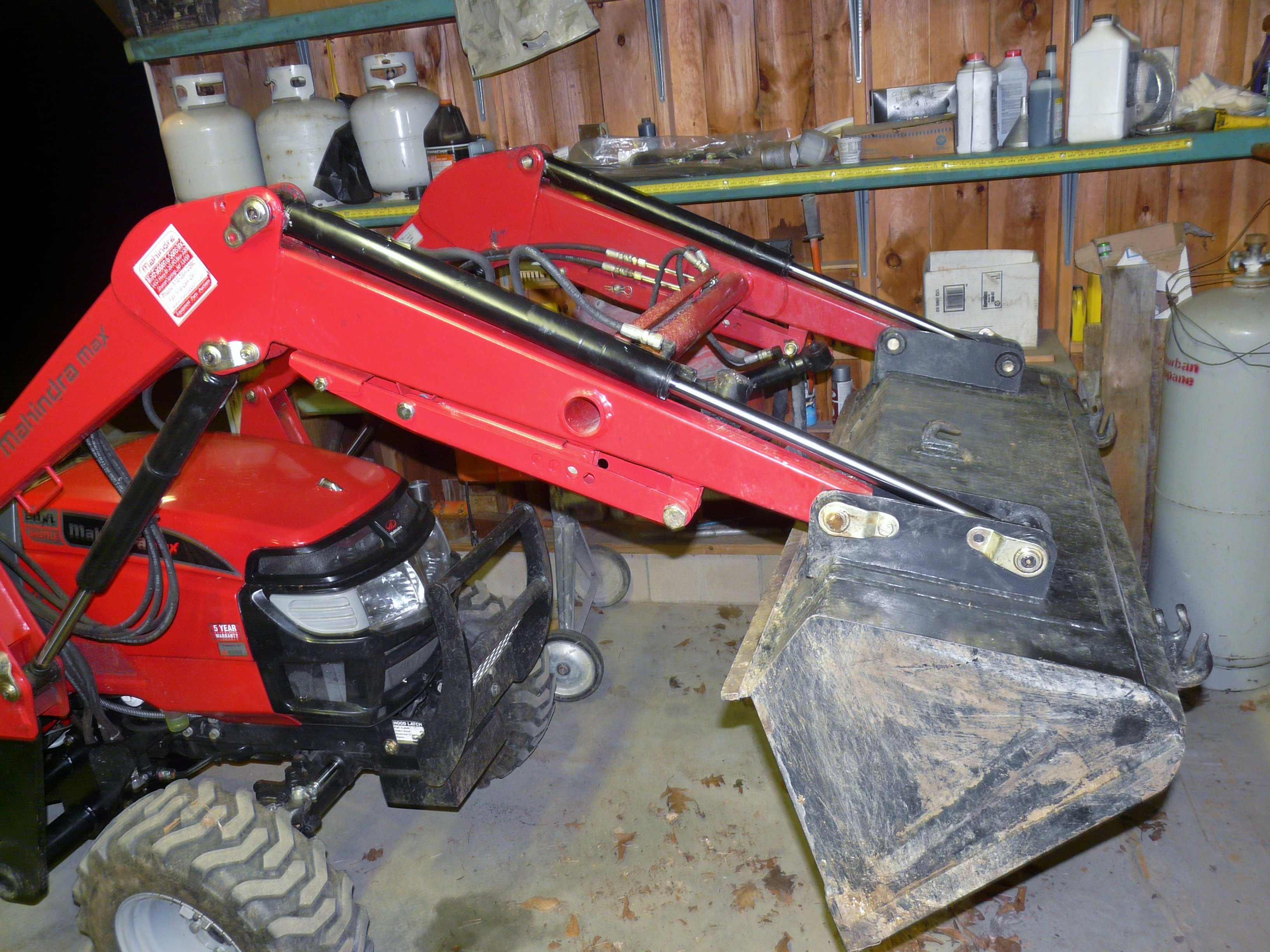

Today I machined the cross tubes to fit the ML205 loader. I will test fit the cylinders to verify that my stroke limiter dimensions are correct before I ask the shop to cut them. The Pin holes are 1" and the Pins are 25mm. I will probably line the cross tube bores with shim stock to take out the 1/64" extra play. The 40mm cylinders from the 1526L do not look much bigger than the 35mm OEM ML205 pieces, but the retract force increases 56%.
PS I looked over some tractors Saturday when I picked up my cylinders:
The Max26 curved loader uses smaller 20mm pins than my ML205 loader and the gussets are thinner by almost 50%. I do like the quick attach but not the other cost reductions. The ML205 itself is not really all that structurally stiff.
The eMax comes with a 25 L loader and a a 25 L S loader. The 25 L S loader is much better built with a 4 link bucket attach and heavier gussets. I actually like the 25L S loader better than the loaders on the Max24 or Max26.
People buying a new tractor might consider these aftermarket loaders, that are a cut above OEM

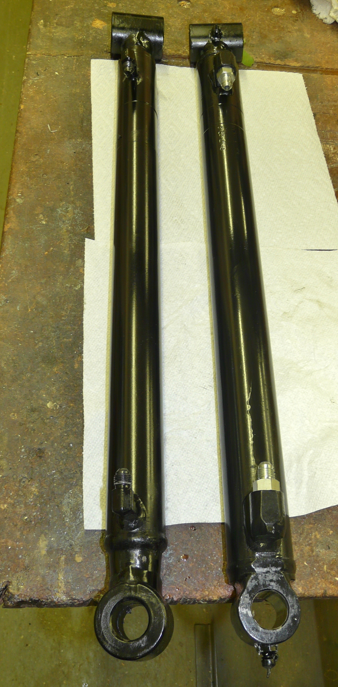

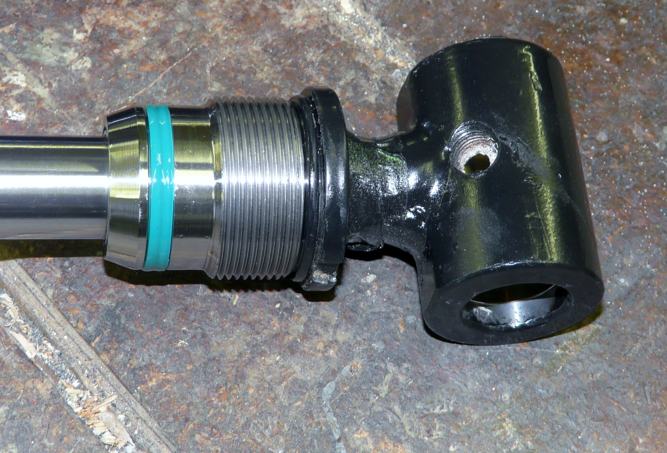

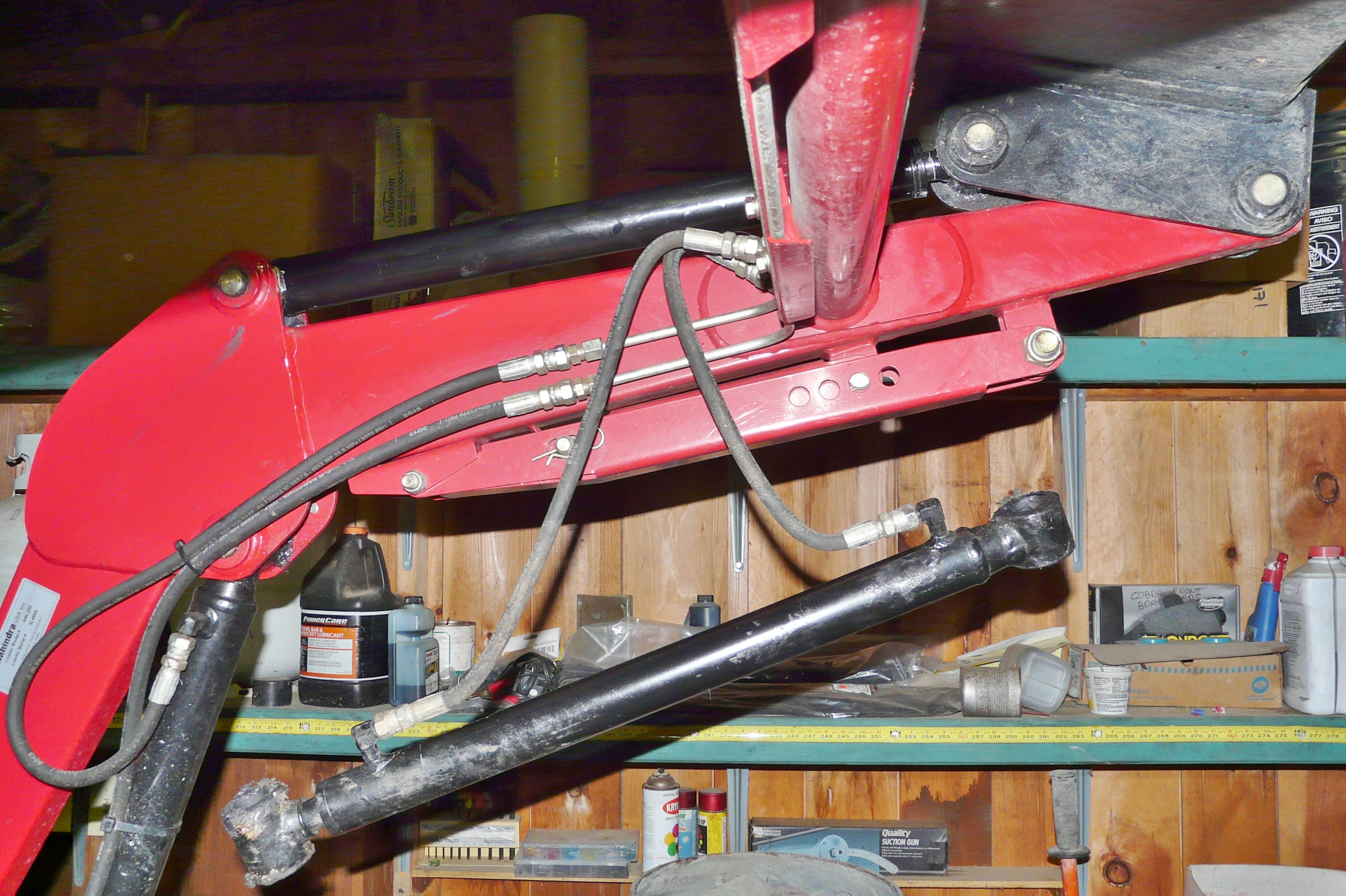

New cylinders Fit-up Check Re: Weak Loader Curl Solution For the Max28 AML205 Loader

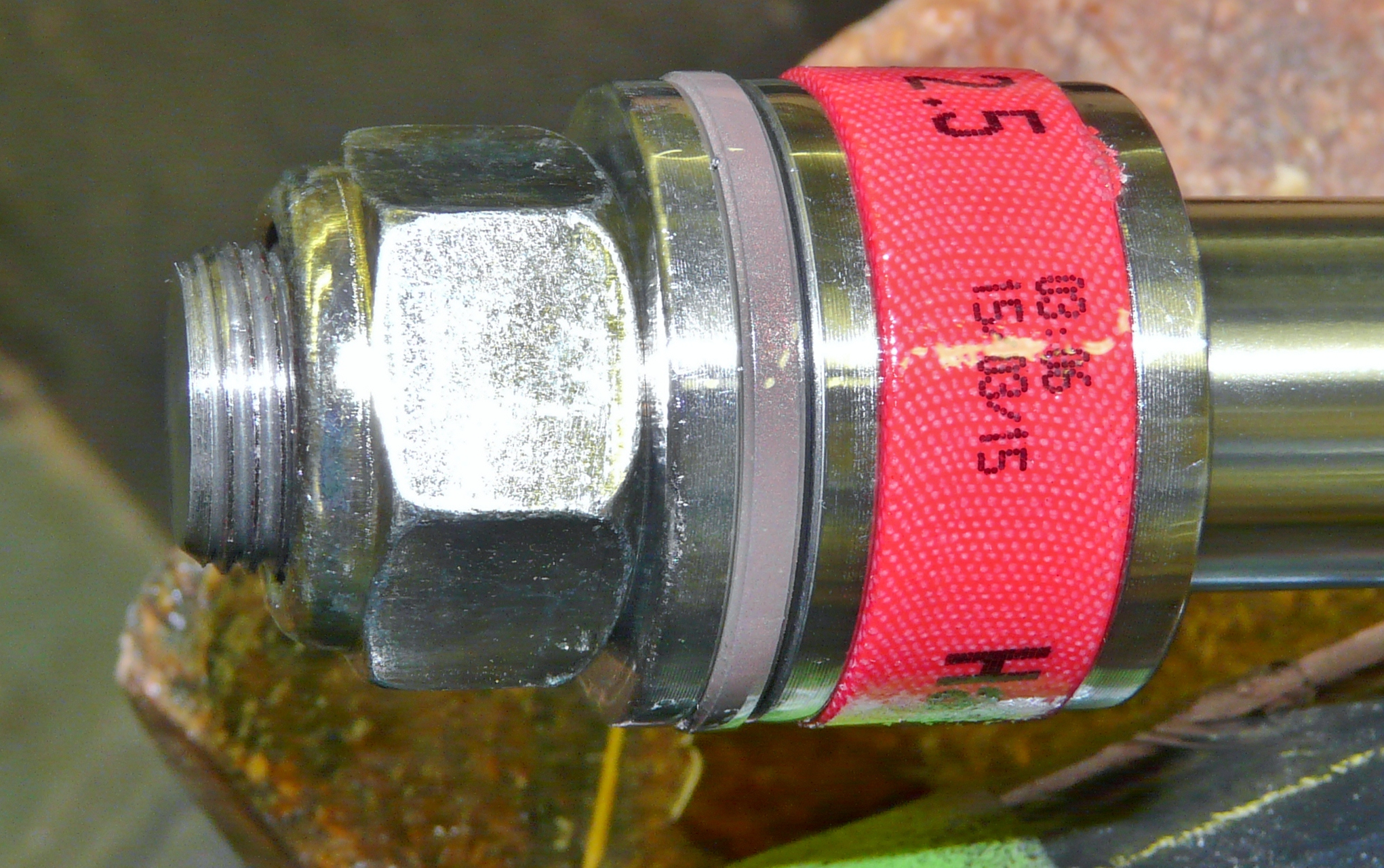

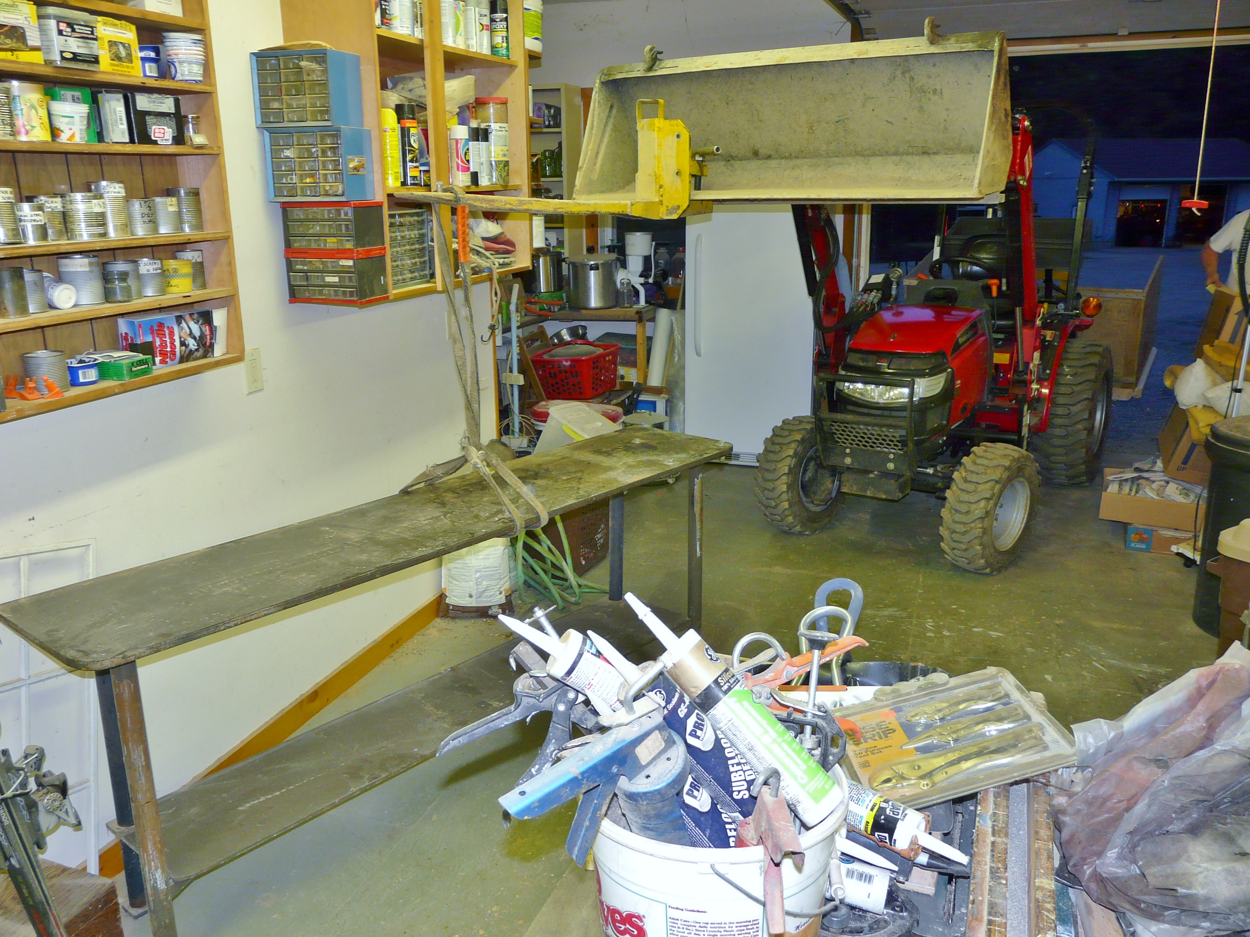

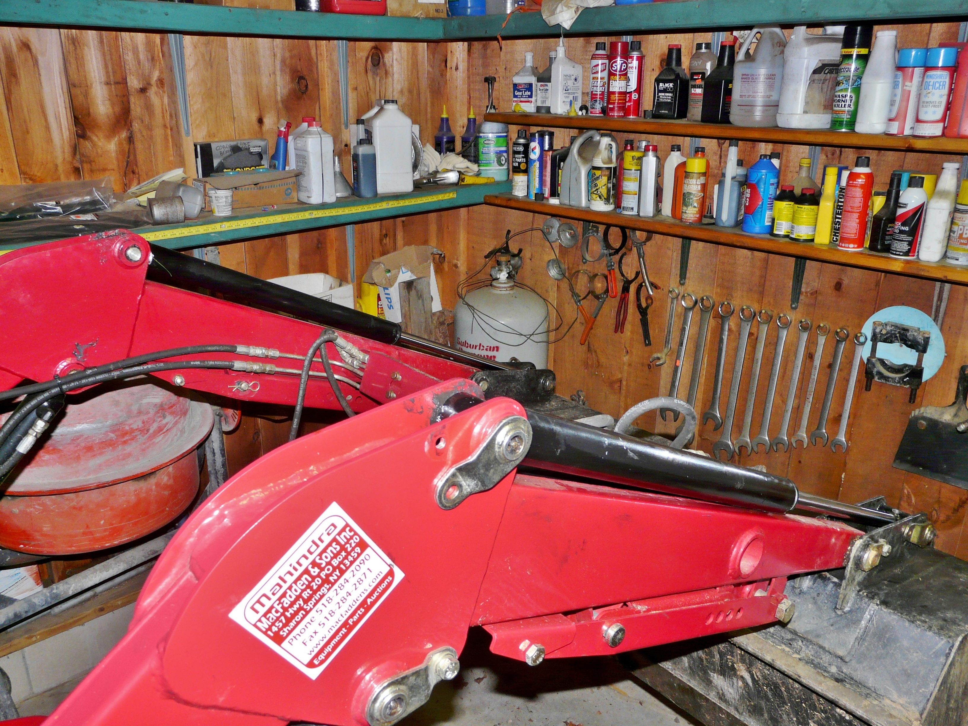

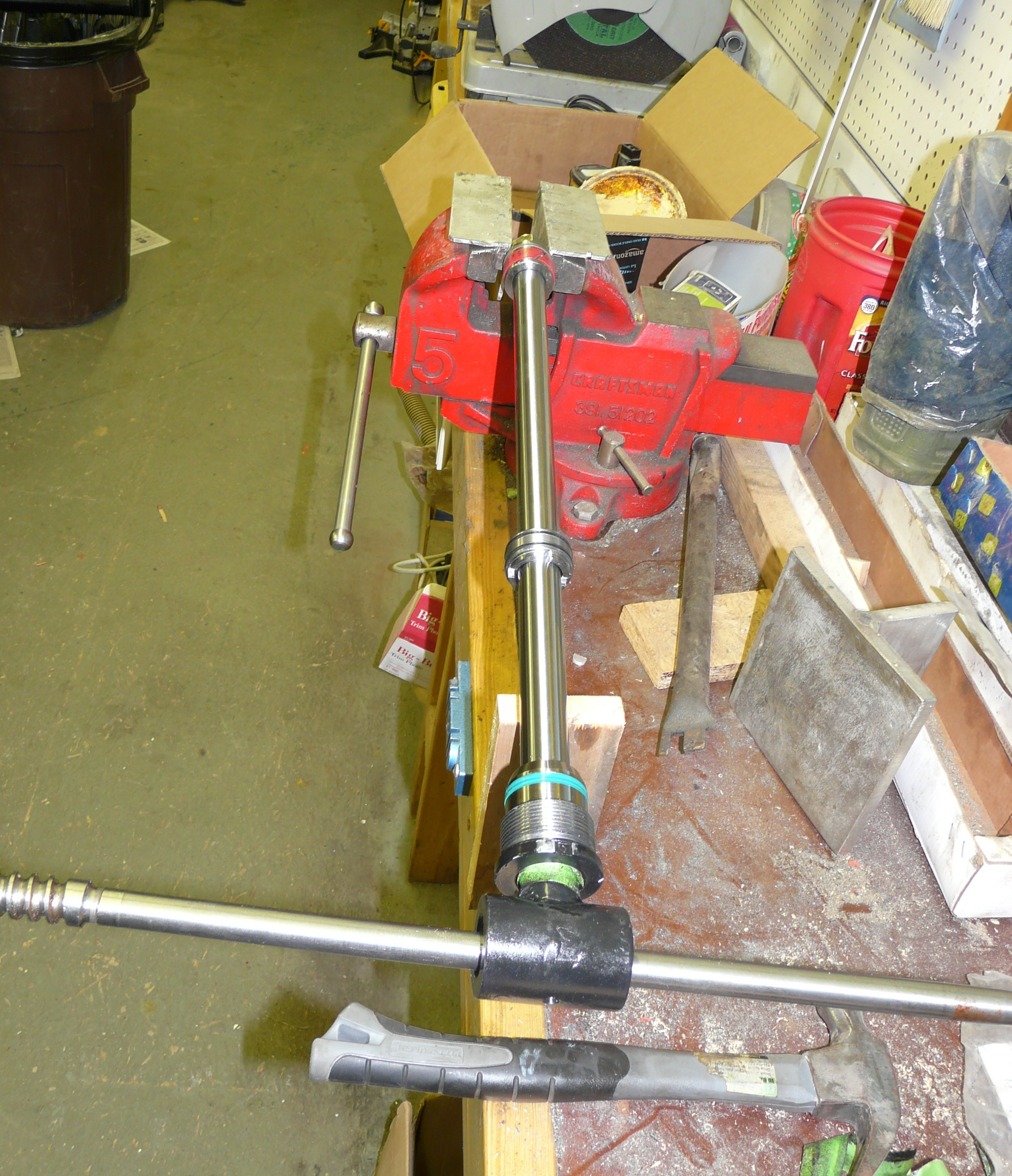

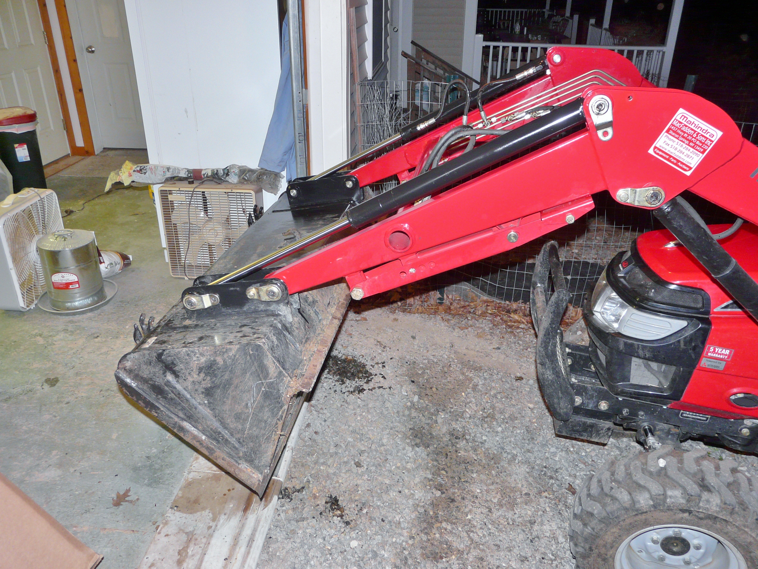

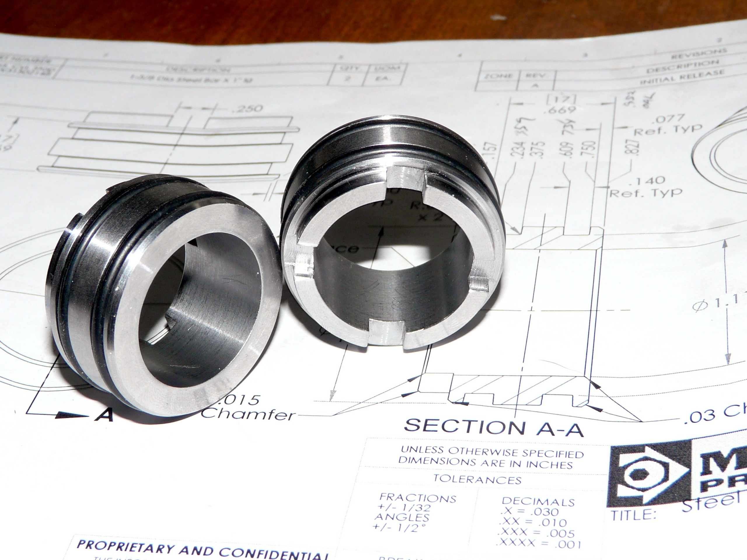

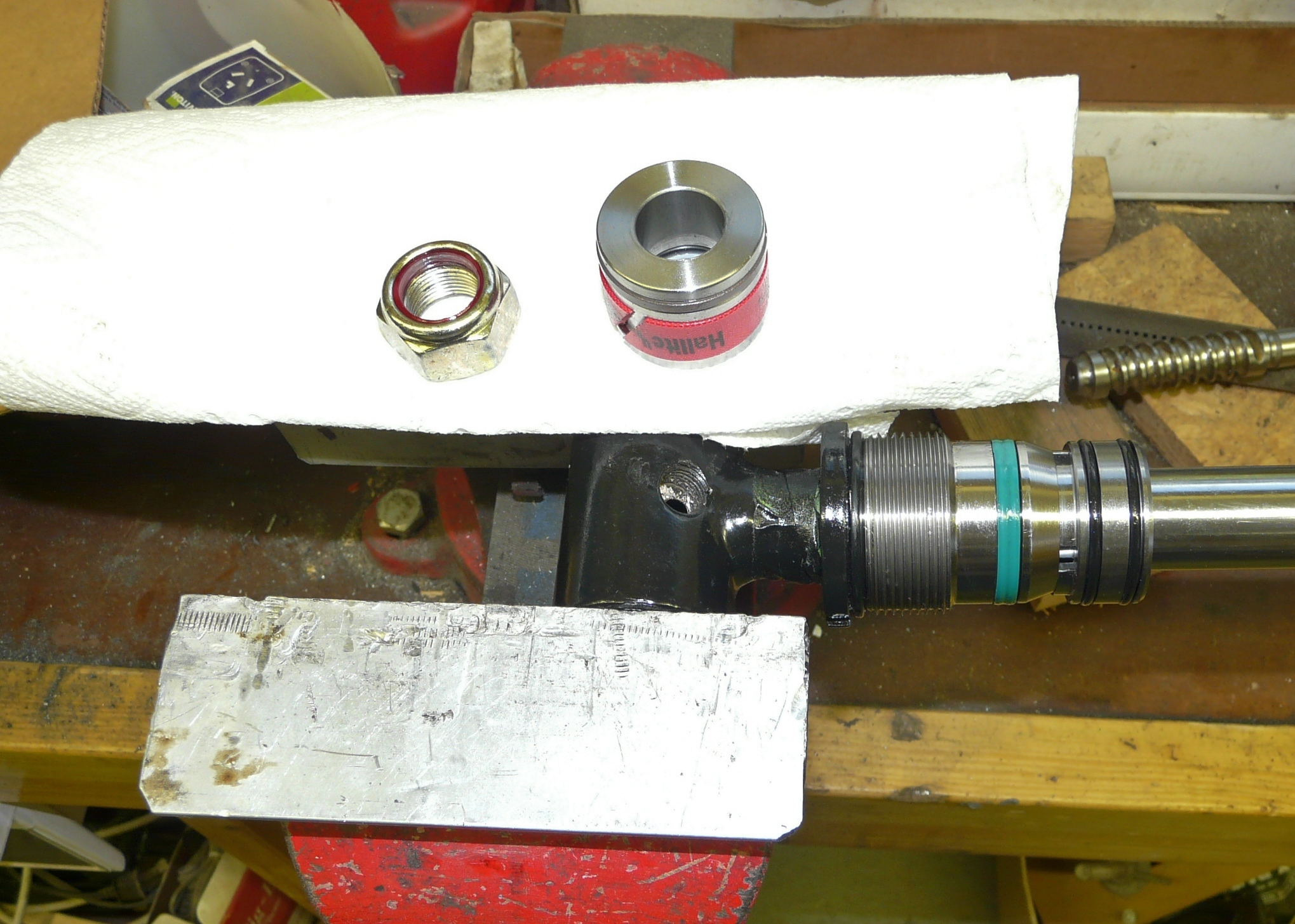

I fitted my new cylinders to check chat I need to do to limit stroke.
The New cylinders retract 6mm more and extend 22 mm more.
The extended length is the problem as the extra small amount of retract actually helps retain stuff in the bucket at low lift height. I suppose it is too much to except a self leveling bucket on an inexpensive little tractor.

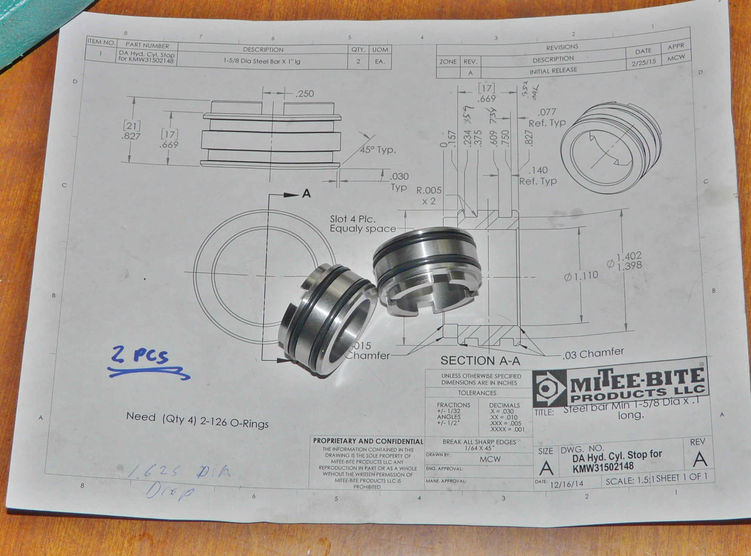

I needed to rethink the internal stroke limiter. I am glad I took the cylinder apart before I asked the shop where I work to make up the stroke limiters. It will be at least a week to get them made. It is tough to get favors in a production shop.
In the pictures it is hard to tell the 50MM OD cylinders from the 45 MM OD Cylinders, even though the piston area is larger by 56%

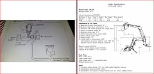

466465d1461811118-weak-loader-curl-possible-solution-p1030786-jpg
I am going to invoke my soothsaying powers and predict that an abundance of scratches and dents in your hood will be forthcoming.
As I say, so shall it be.

OK I see that there is very little difference between the two cylinders (cylinder barrels) as far as size/diameter is concerned.
1. how much did you have to remove from the (rod eye) to get it to slip comfortably on the hangars mounted to the loader/bucket? I see you did it the proper way and milled it. I would have used a belt sander and or a flap disc on a grinder to get it to fit; I do not own a mill....
2. I am guessing that once you slipped the cylinder in place, you checked to see 'how much slop developed'- this is magnified as I assume both rod ends are a bit shy of being a perfect fit. I am a perplexed as to what you are going to use to shim the differences in diameter. (bit of copper pipe to encapsulate the bolt maybe)?
As far as the PIC's go, they speak volumes in regards to fit and finish! thanks for sharing them!
I am having a hard time grasping at what issue you are having with "internal stroke limiter"? From the pictures it looks like there are 'no areas during full cylinder cycle that are binding up'. The dimensions between the two "old and new cylinders" seem very close to identical; referencing a picture you posted with both sitting side by side to one another.
I am as excited as you are to see the results of the modification.

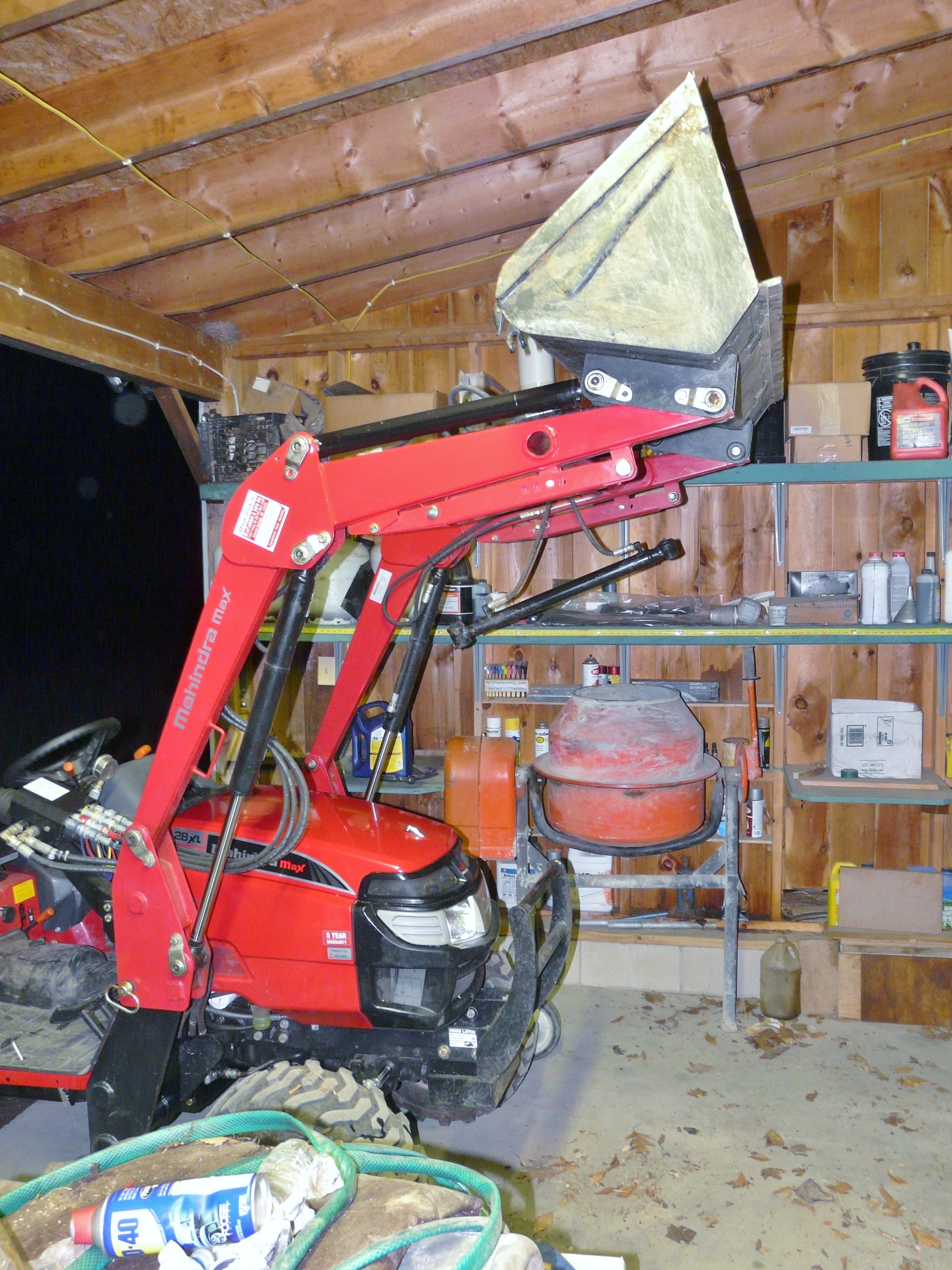

From the factory, if I curl my loader and raise it to full height it will bathe me with some its contents. He was cycling it to see its movement throughout its full motion. Does yours not do the same :)
You are correct as it is hard to see 5mm or .197" increase in diameter however:
Math says (40^2-25^2)/(35^2-25^2)=1.56 or 56%
I'd use a good hack saw, you need to take off 5.5-6mm per side. I actually had to go caveman as I did not quite mill enough off. The grommet on the loaded that fits the cross tube extends inward about 0.030" from the flange When I ground and belt sanded I used a carpenter square to keep it looking right.
Pins actually fits good enough, I would slip in some 0.006" thick stainless shim stock to take out the little bit of play (If I manage to fit it in there.)
Thanks, Doing same on my L39 is going to be tough, I'll use the Max to handle the 600 Lb Bucket.

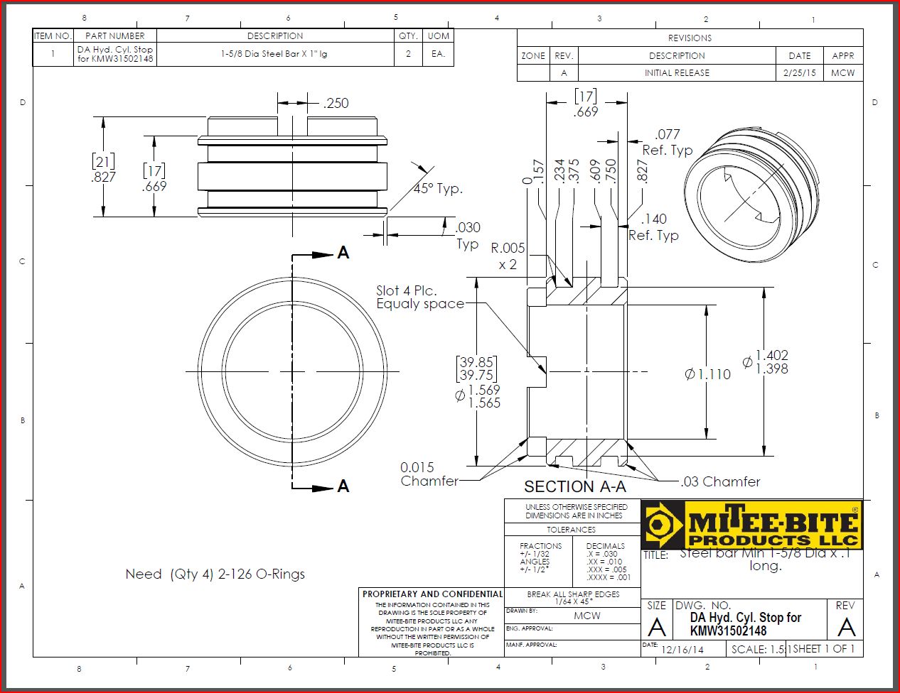

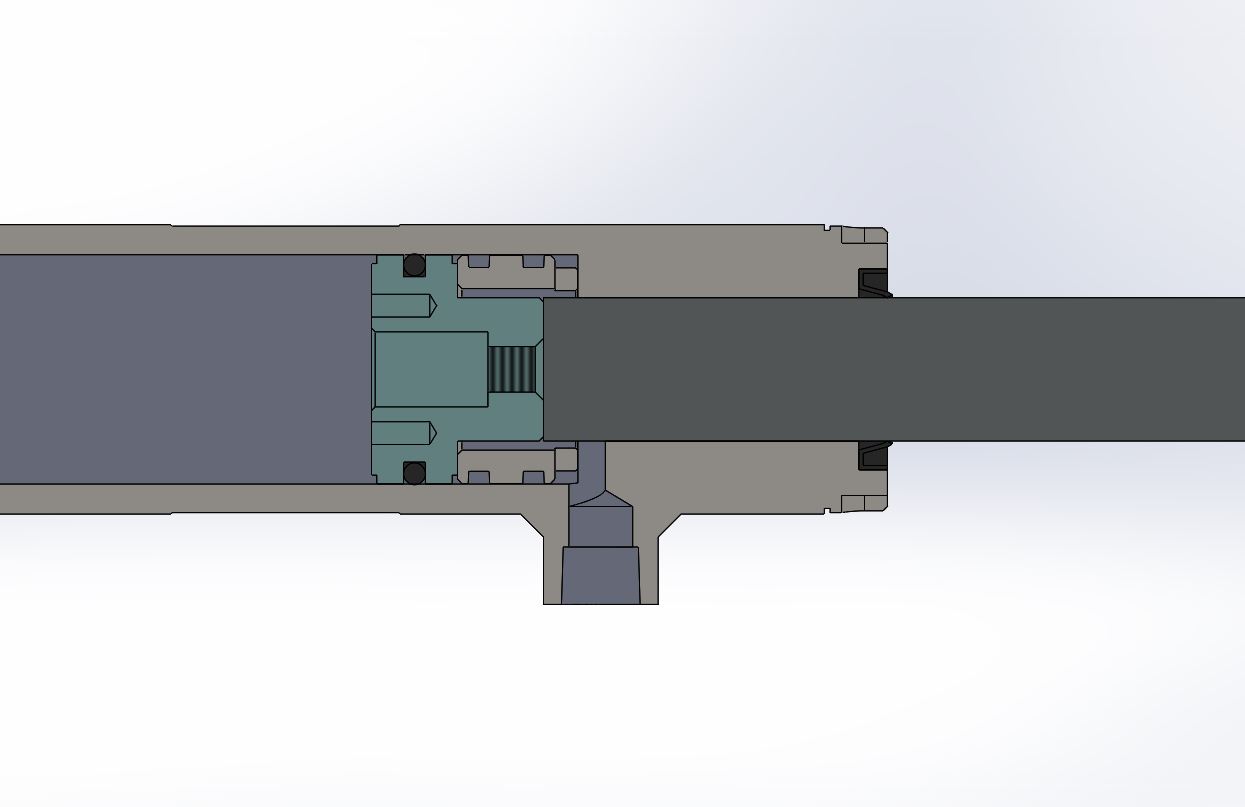

Please see attachment, the spool is to reduce the extension of the rod travel approximately 22mm.
I am as excited as you are to see the results of the modification.[/QUOTE]

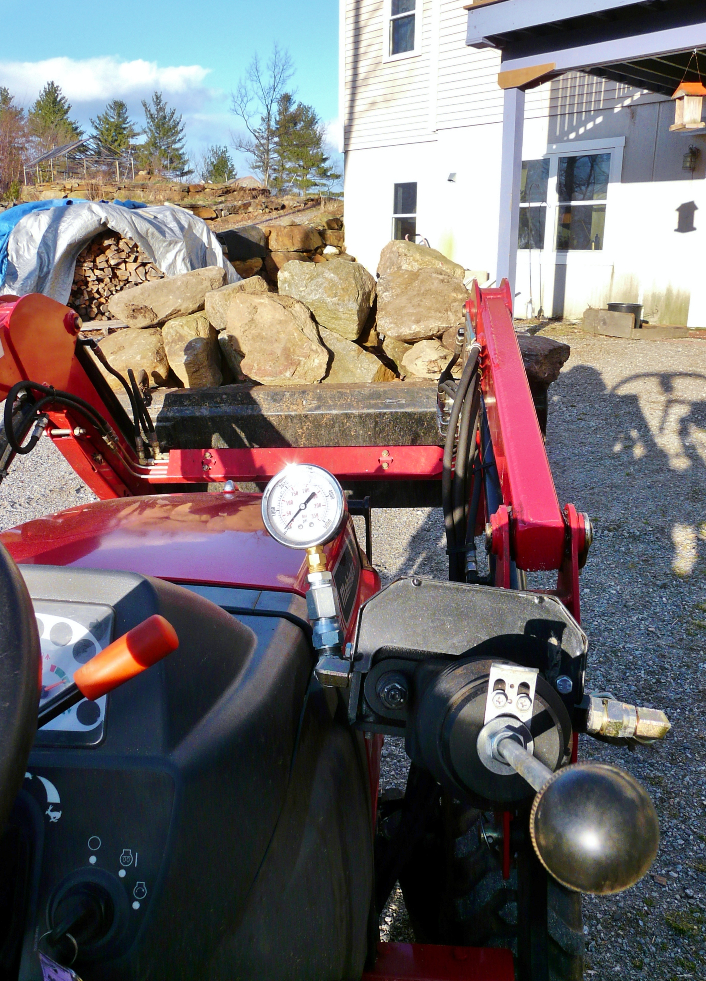

I actually like to figure it at the psi level with a gauge. IE....
I know my loader takes 600psi just to lift/hold an empty bucket. Pressure spec is 2400psi. I adjusted my relief to 2600psi. So one would think I gained (2600/2400)....8% lift. But that's wrong. Because at 2400psi, I have 1800 psi available to lift material. So the correct percent would be 2000/1800....11%.

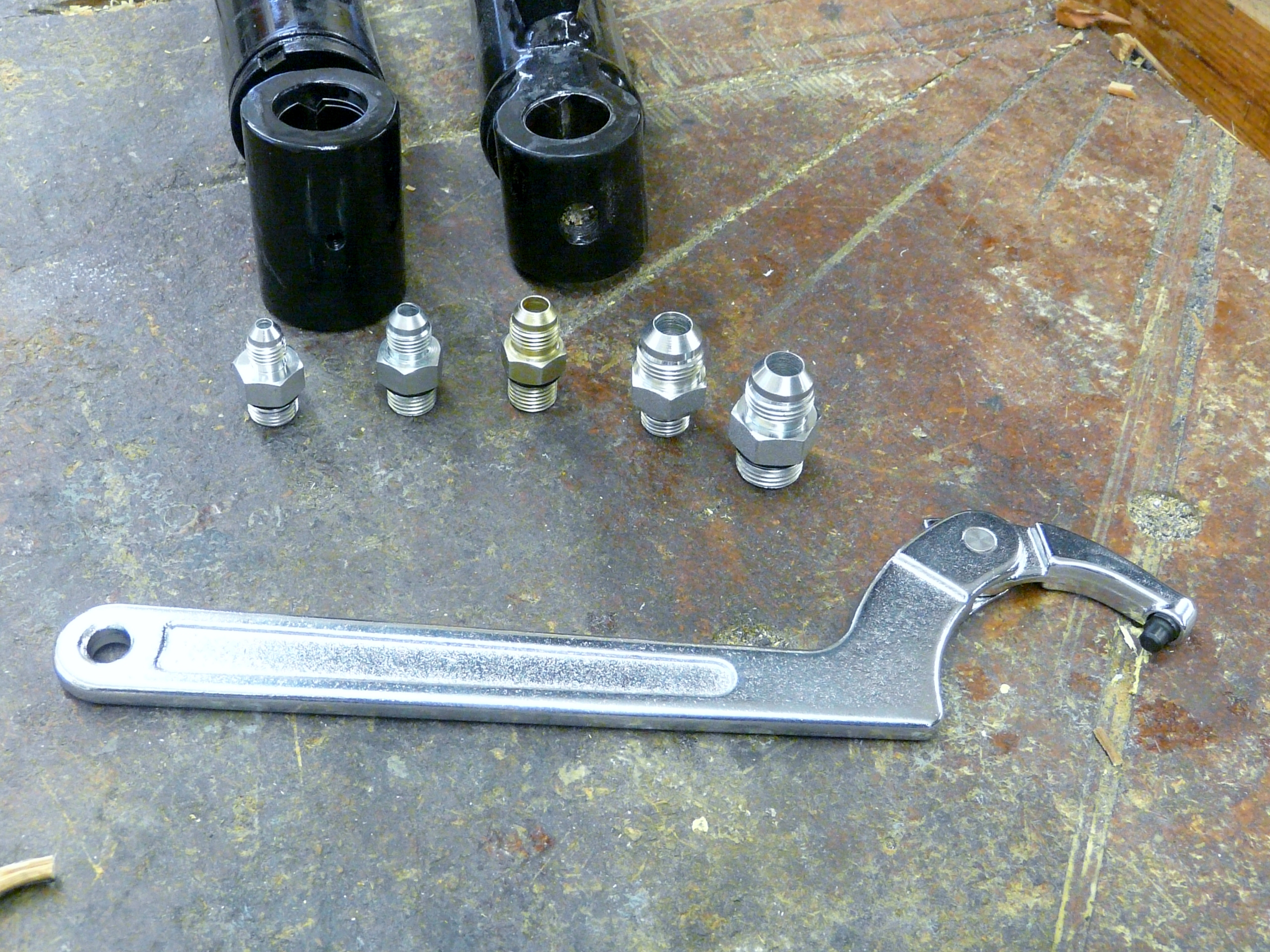

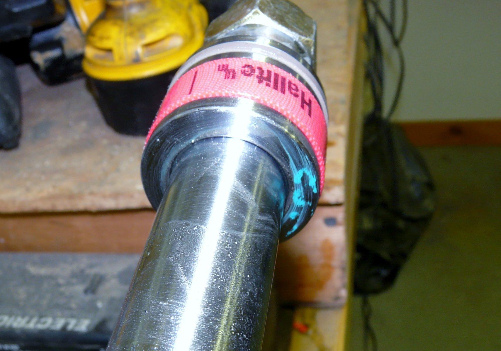

The Adapter Fittings I needed are JIC #5/16 1/2-20 to SAE ORB #6 3/6 9/16-18 Straights.
Just try to find this oddball!
I did, see attachment Phone Number and info at bottom of photo. (Hydraulic Direct)
Great prices on the fittings Freight is bad, but lease i do not need to have new hoses made up. This will set me back a week.
I ordered the wrong fittings from Surplus Center. JIC #4 1/4 7/16- 20 to SAE #6 3/6 9/16-18 Straights. Surplus Center an all the supply catalogs do not list the JIC#5's to SAE anything.
PS two layers of this stuff is what i lined the Pin hole Bores to take out slop going from 1" holes to 25mm pins.
TapeCase 2" width x 3yd length (1 roll), Converted from 3M 3361 Silver High Temperature Stainless Steel/Acrylic Adhesive Foil Tape: Amazon.com: Industrial & Scientific

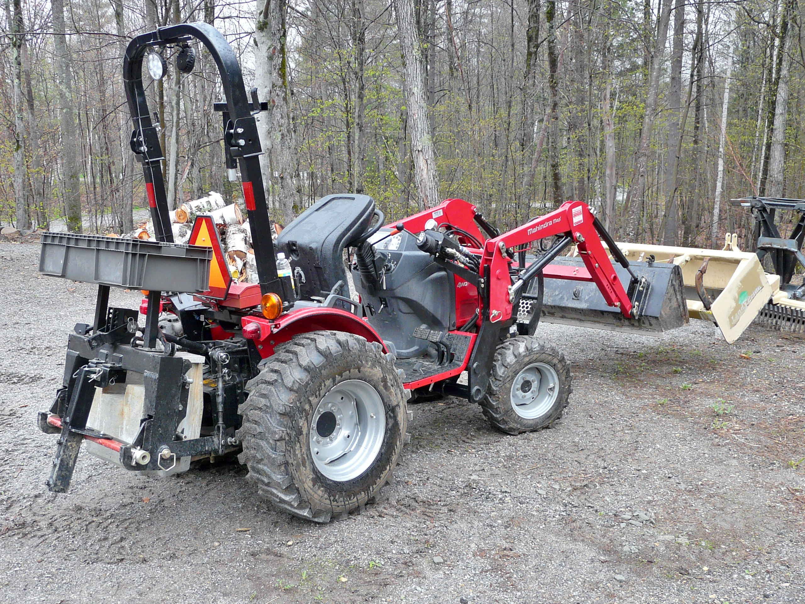

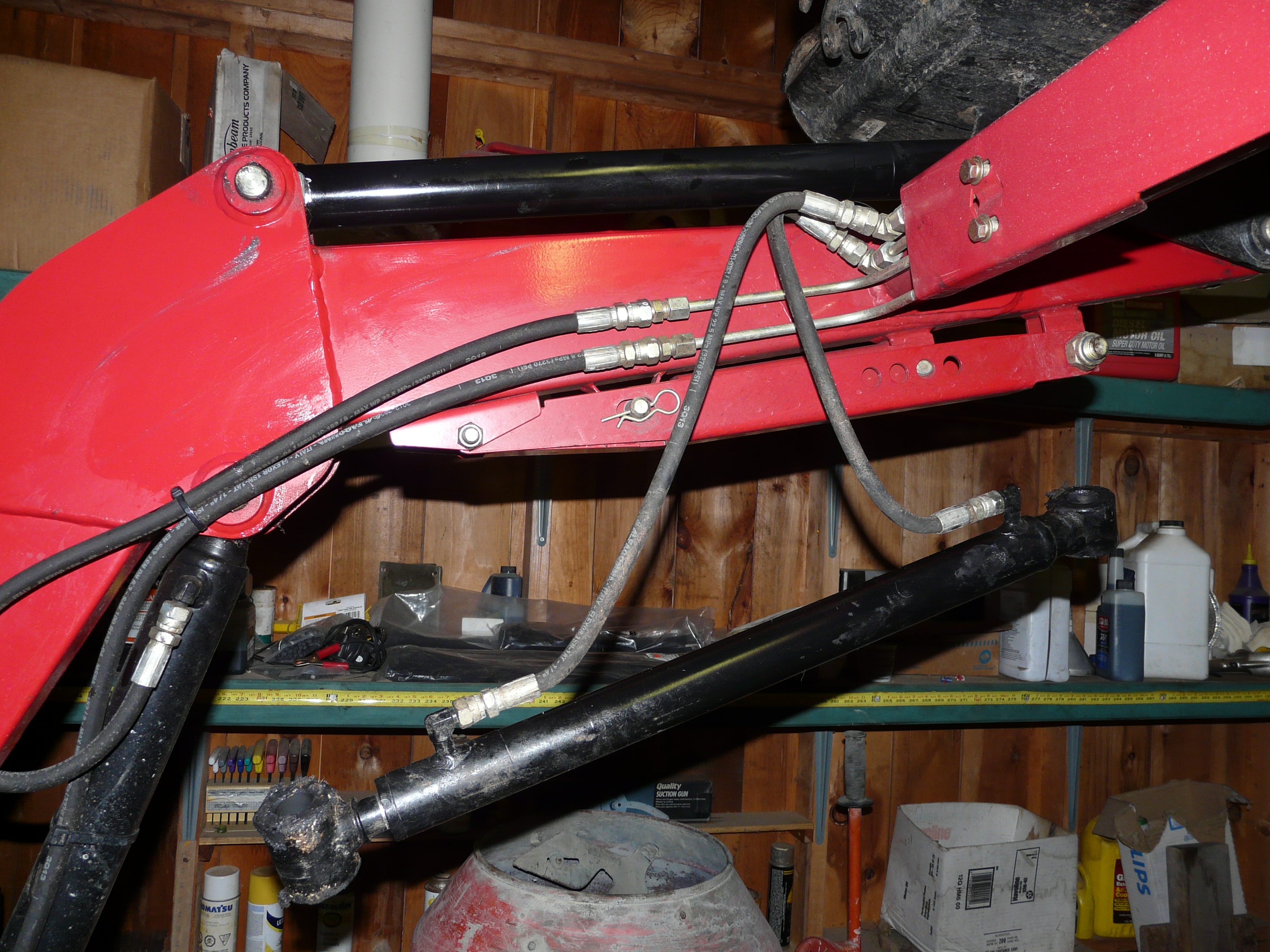

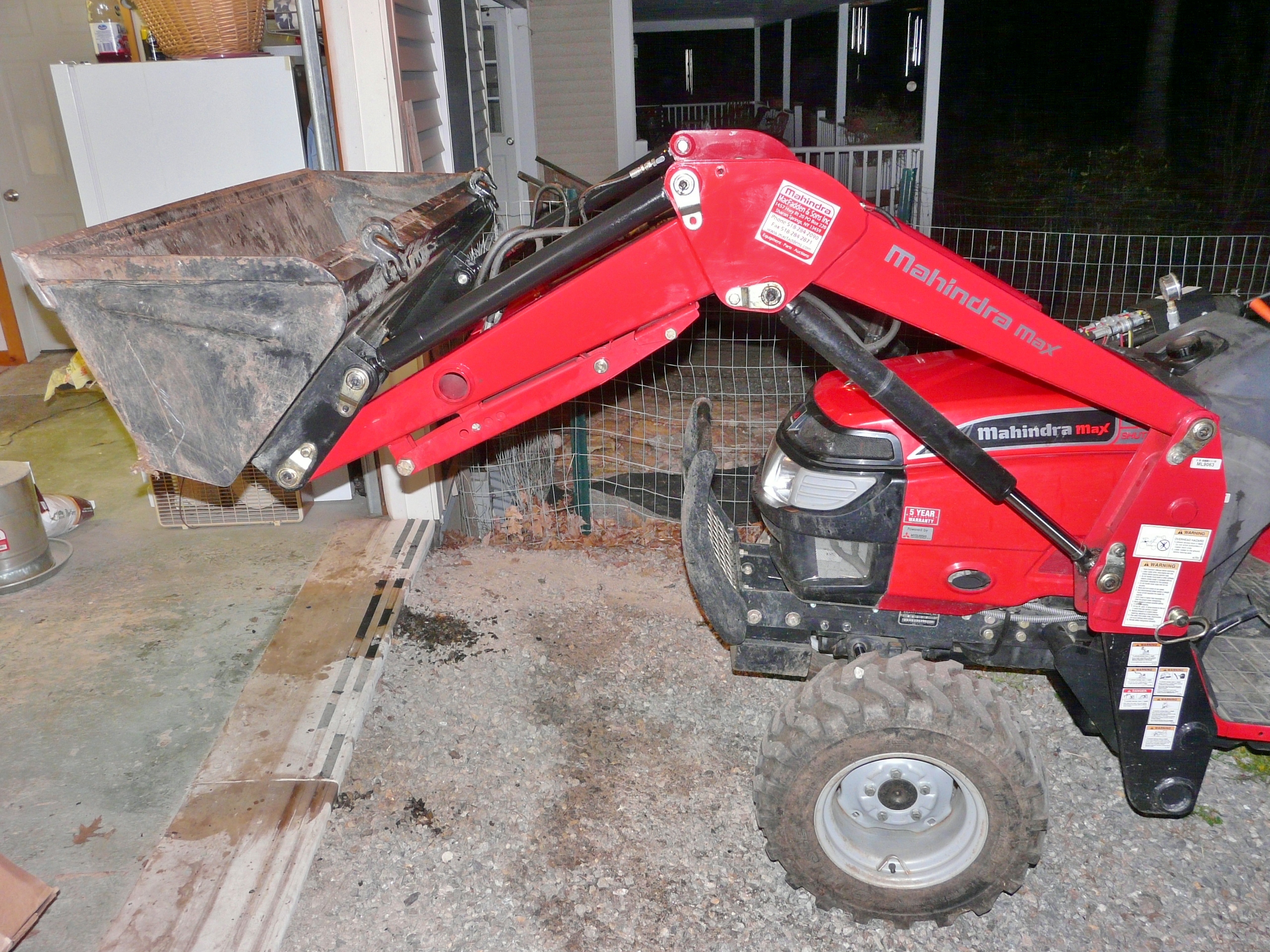

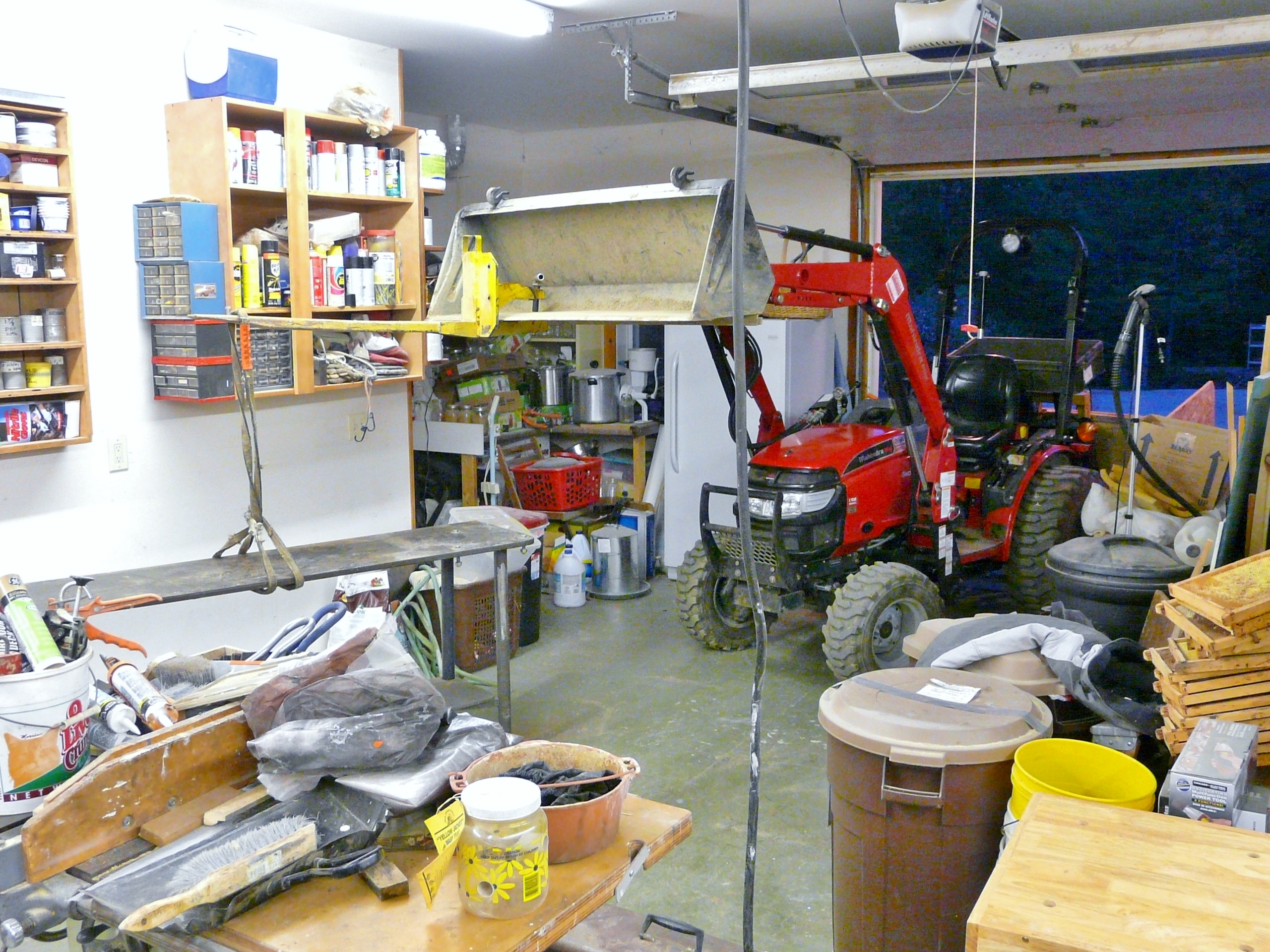

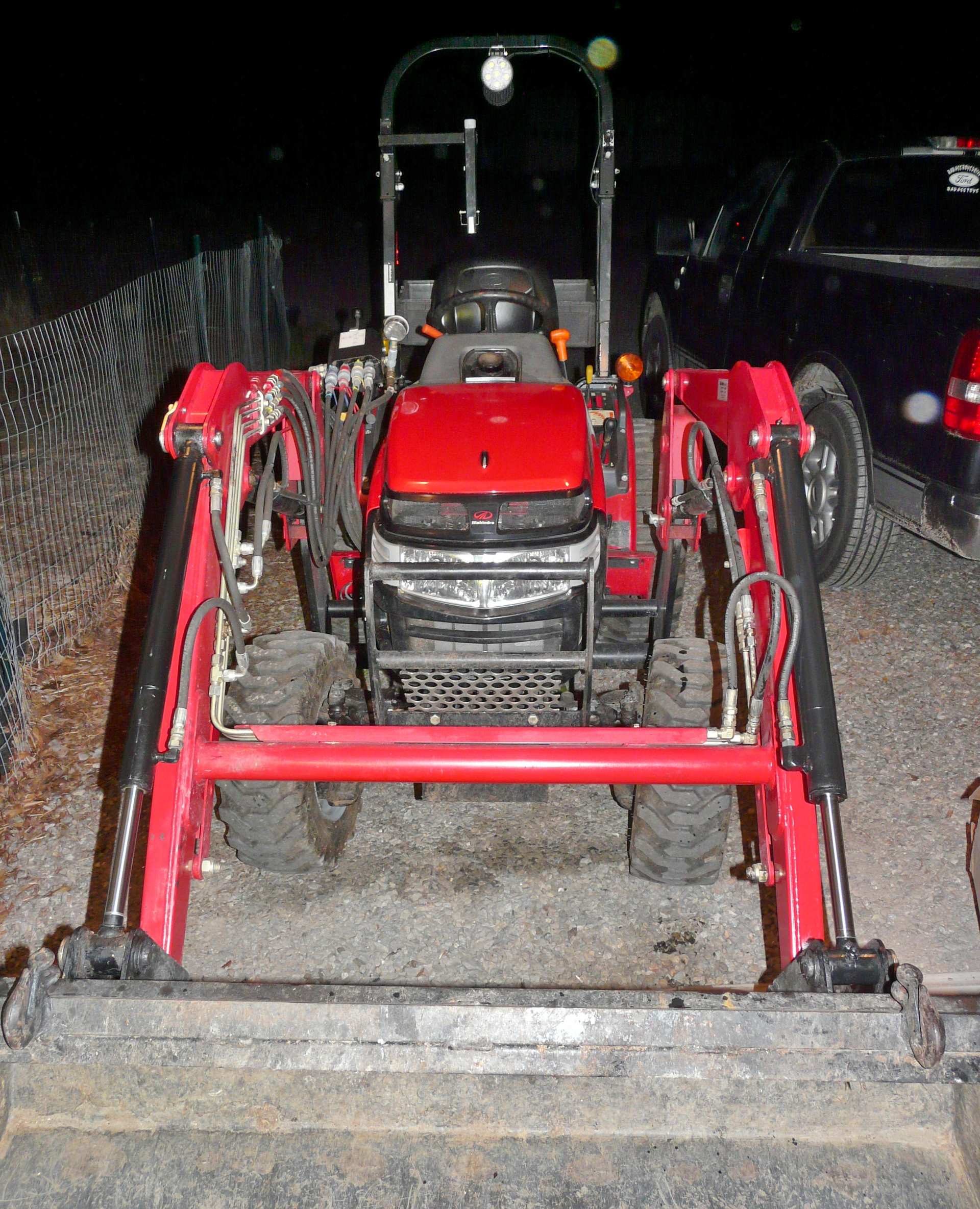

Nor More Weak Loader Curl For the Max28

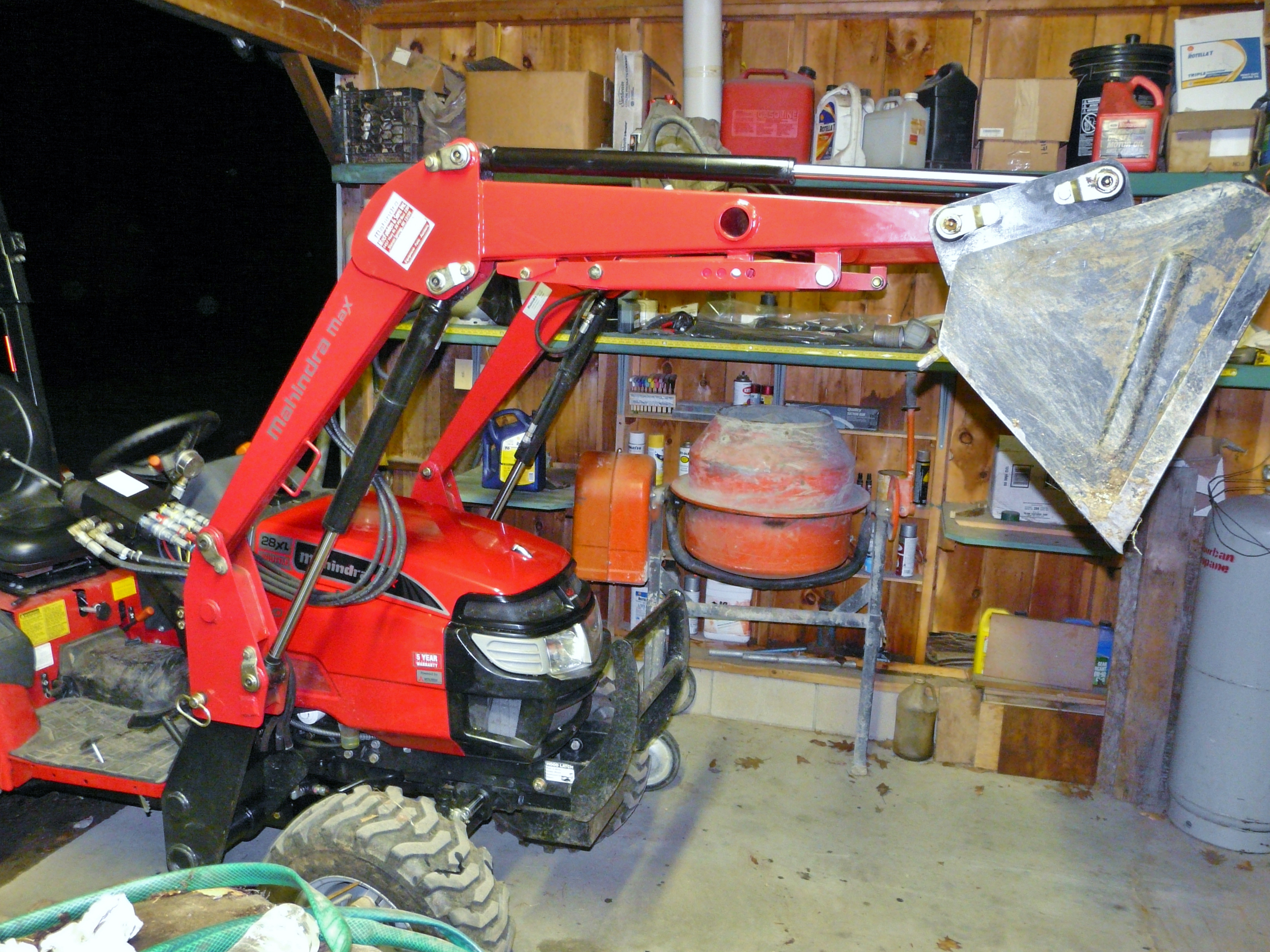

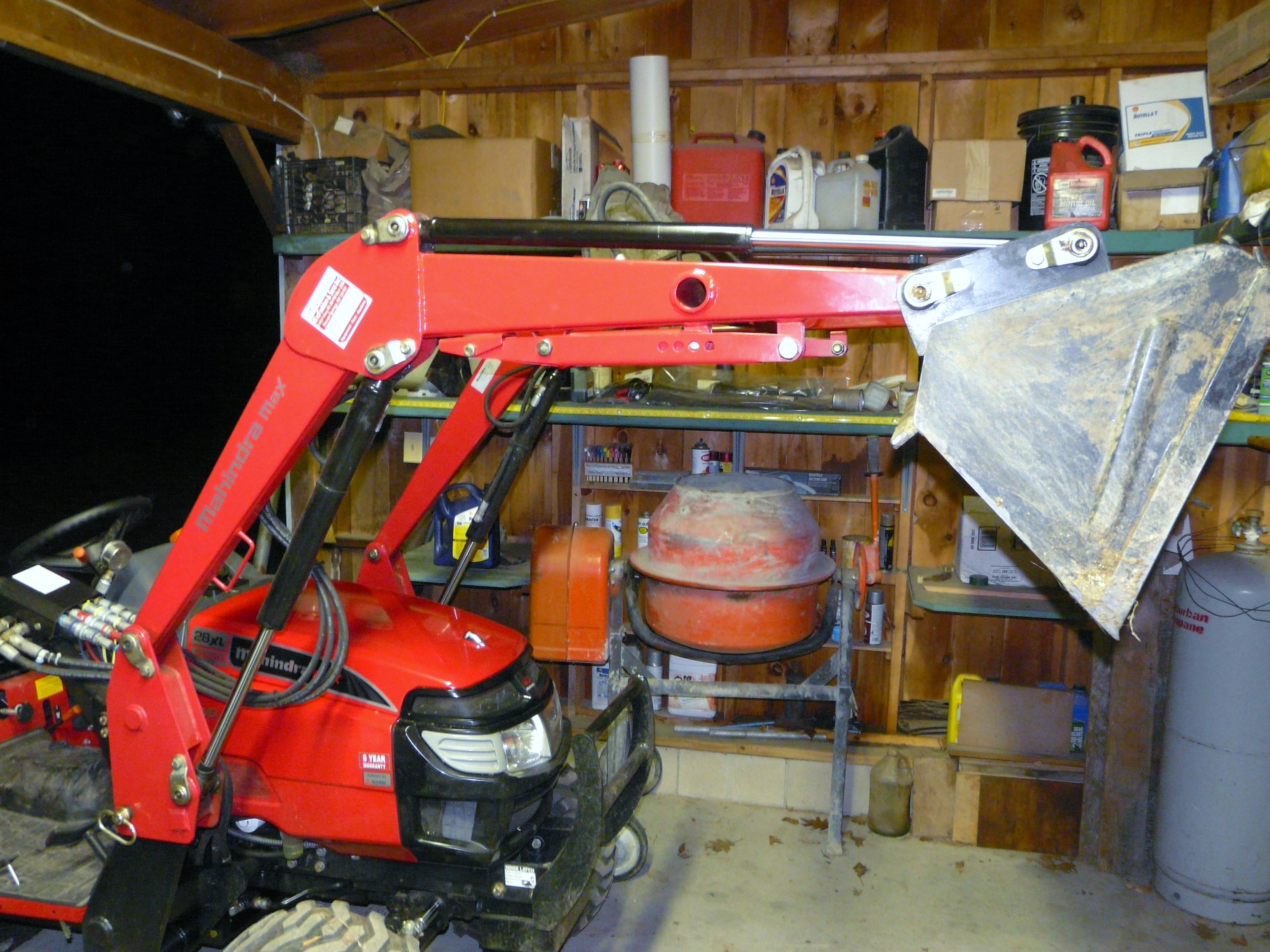

Ah done! Yes, the curl speed is slower but not painfully slow. and For a quick test i drive the tractor as far as i could into a pile of crushed stone. The lift cylinders were in relief trying to lift the bucket out. Normally the curl would be useless, Id have to back up out of the pile and then lift.
Now the curl just breaks out and scoops. It is the way a loader should behave.
Installation went well, as I have a decent place to work and tools.
The 1526 Cylinders are well built and clean inside.

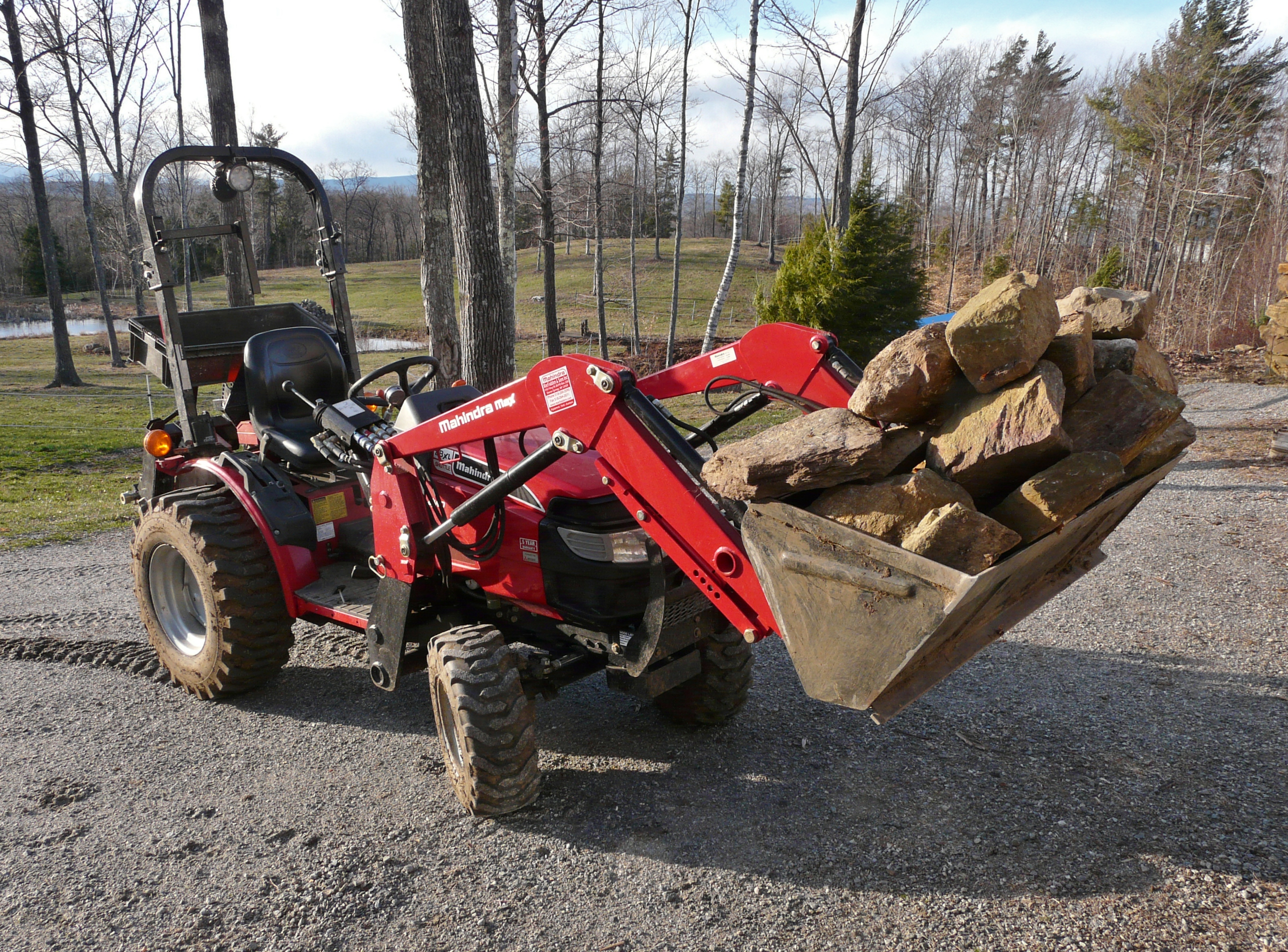

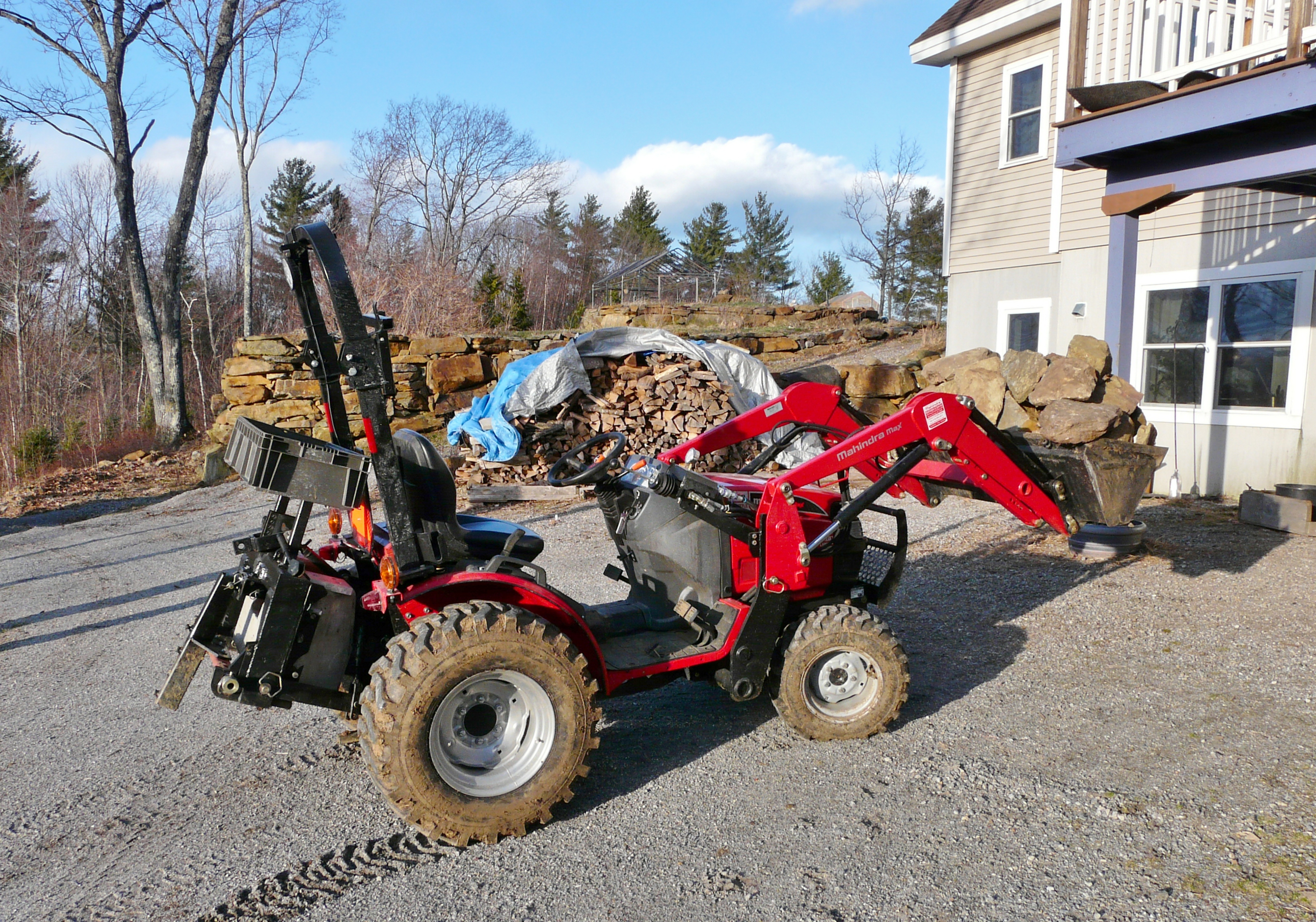

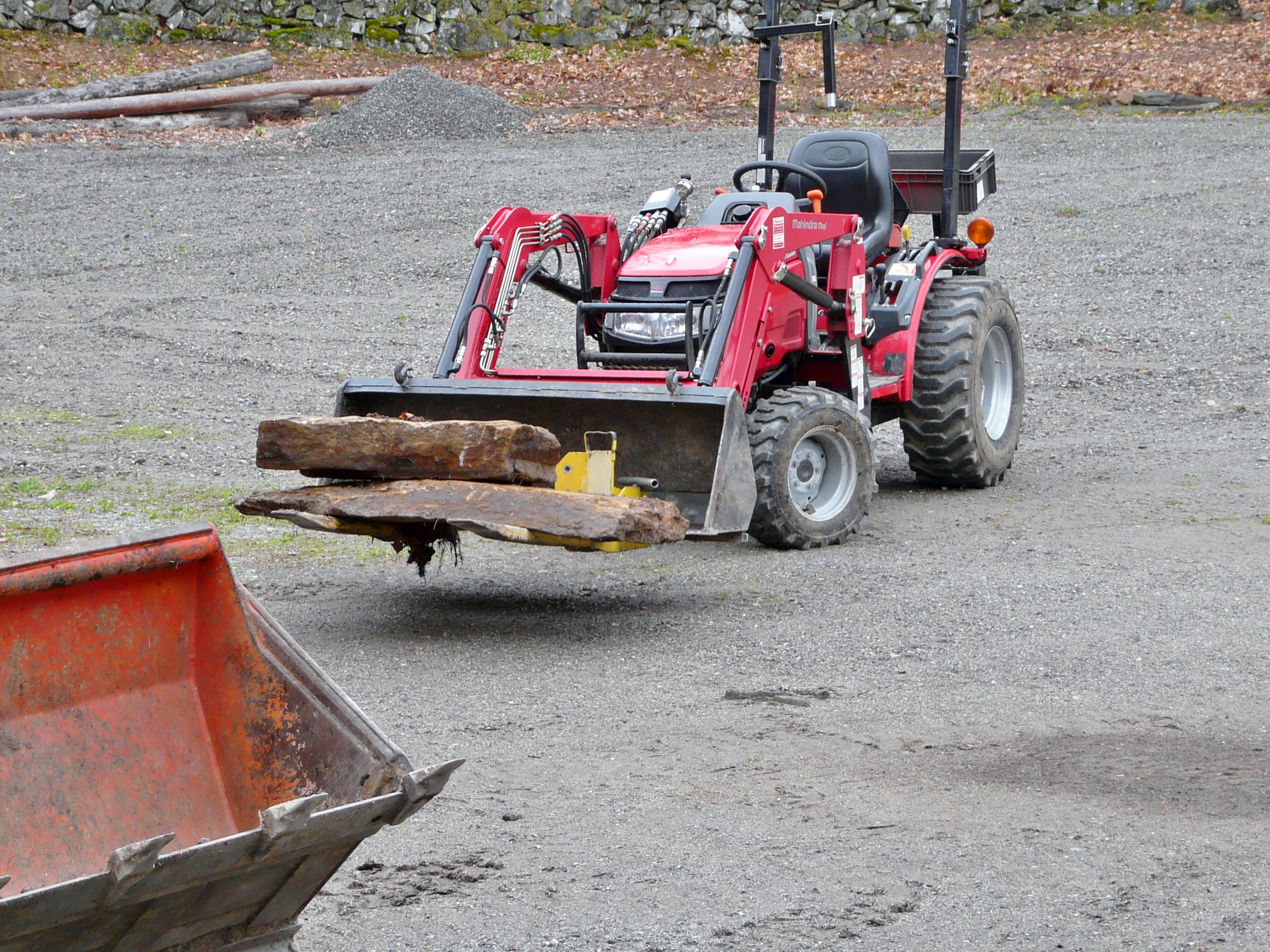

One thing I've noticed In the +2 hours I've put on the Max28 since the 40mm Curl cylinders were added is the Regen circuit on the dump sure does fight itself more with the ratio of the extend to retract areas changed. To avoid loading up the pump, I just go to the detent in the dump cycle, not full dump. Slow but most times a slow dump is better at putting material where you want it than a fast dump. Going to regen probably does not hurt anything, it is just harder and longer with the bigger cylinders. On a hot summer day working the loader hard, I suspect the oil will heat up.
The Cylinders on my L39 and excavator heat up, as they should as their oil pumps are 3X and 7X the capacity on the Max28's
If anyone needs machine work, I suggest going to your local Vocational Trade School and speaking with an instructor regarding your project.

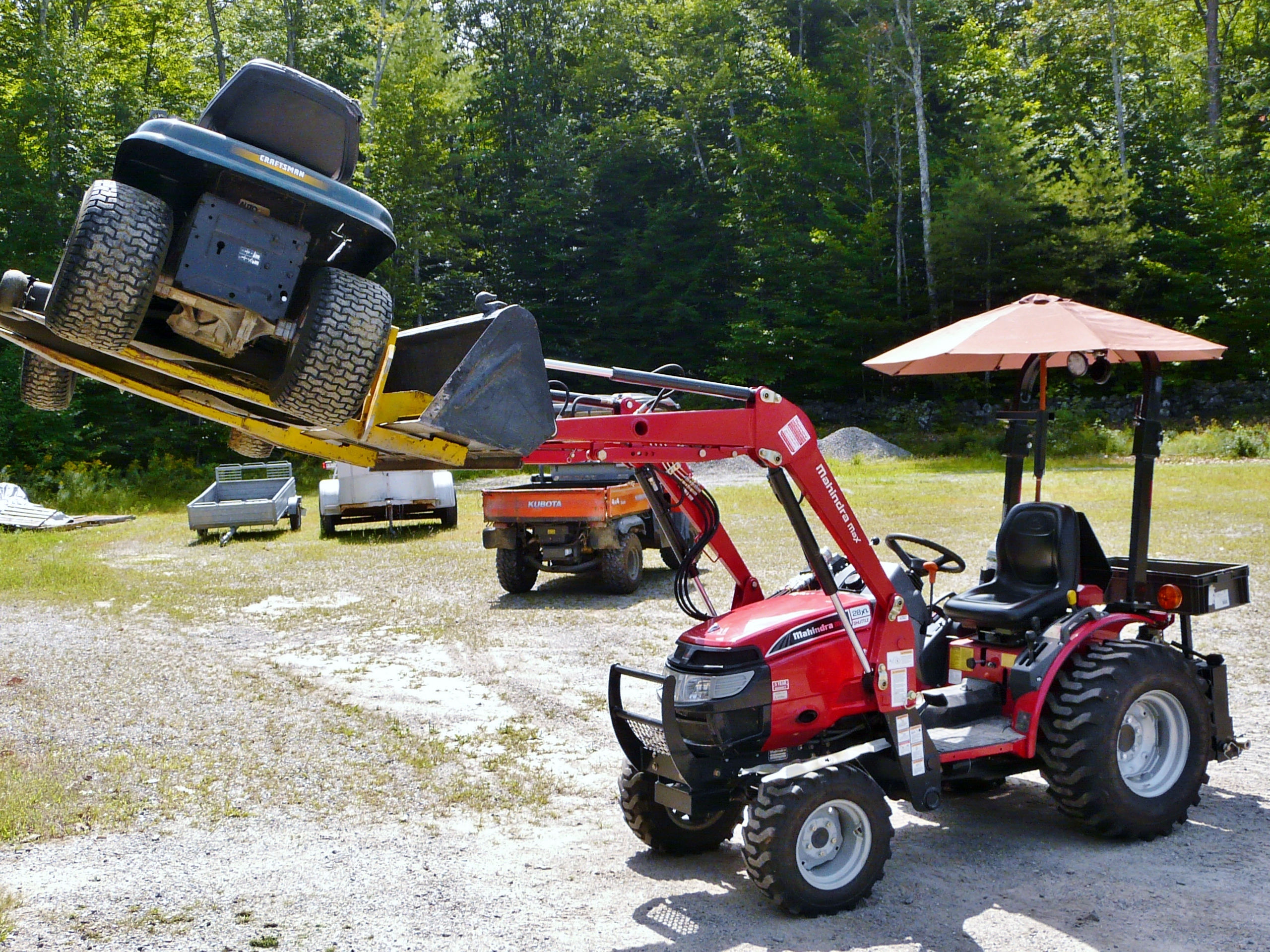

Back when I lifted the Sears LT1000 lawn tractor, the 35mm cylinders were just up to the task, I figure the lawn tractor weighs between 400-450 Lbs.
With the 40 mm cylinders, I moved my Landpride 15-84 box blade and did not have a problem. It weighs about 550 lbs. I think the maximum pallet capacity would be almost 900 Lbs. with this setup.
So I did not have to walk the excavator a distance to load some rock in the L39 bucket, I used the L39's BH to load rock on the Max28 to move the rocks to the excavator, where I'm doing some wall repair.

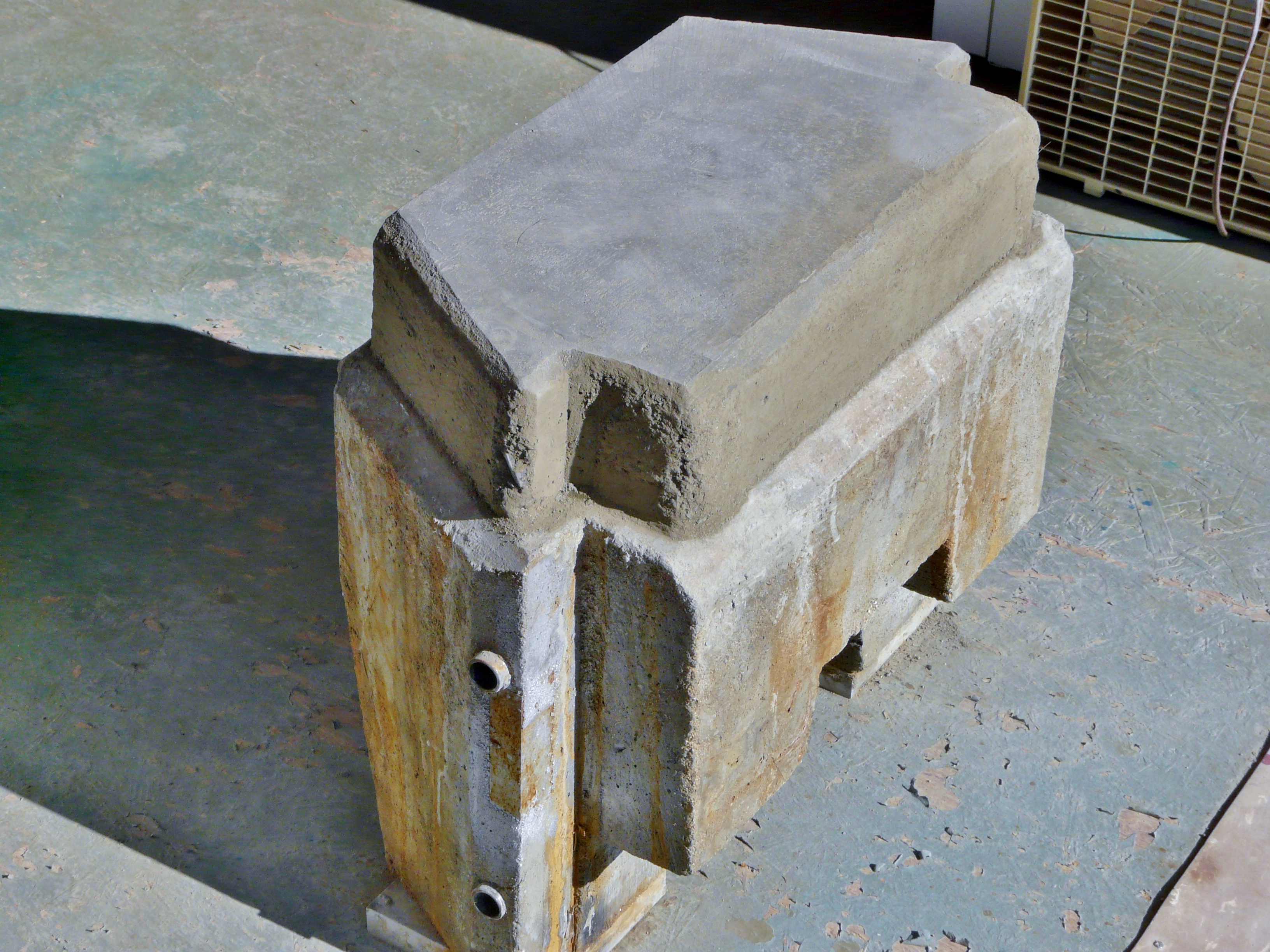

I'm glad I have 700Lbs of counter weight on the Max28. The concrete CW has a bit of metal cast inside. (see photo)
The Max28 has plenty of Lift Cylinder for its size. Up sizing the Lift cylinders would severely overload the front axle, powers steering and the loader in general.
The strength of the loader function seems nicely balanced now. Its stronger than just about any other small tractor.

Making a weld shop.
I'm preparing an area in my equipment building for a weld shop. To move this 475 Lb. steel table I could have put in on a dolly to get it out of the building. Or I could have craned it out with the L39's BH. But this is just what a good small tractor is for. The table top is 84" x 18" x 3/4" thk. and the bottom shelf is 74 X 14 x 1/2" thk.
Just out of curiosity, I measured lift point to loader pivot pin distance at 60". As I have a pressure gauge mounted on the loader control, I measured what pressure was needed to lift using the lift arm cylinders. It took near 2000 PSI. But using the bigger 40mm curl cylinders it took about 1300 Psi to curl.
The OEM 35 mm curl cylinders would have been maxed out, if they even could curl that much of a cantilevered load.
The power steering was taxed to turn the wheels if not moving even on the shop floor.
I figure the table was the equal of 1000 lbs in the bucket.
