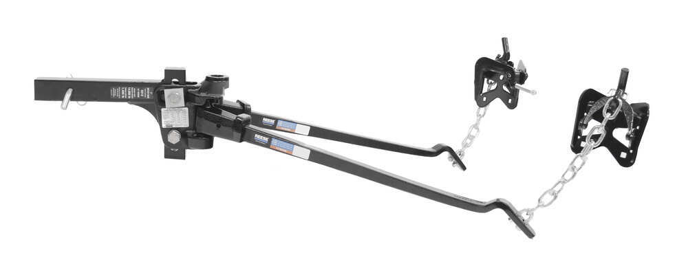

Well I'm finally getting ready to have to tow my tractor and some weight.
As a student of procrastination I've put off getting a WD because most would not fit because of the break-away box.
Almost all the WD's want to put the mount where my BA box is.
But the Equal-i-zer says to put it back up to 32" and uses a bar strap so it looks like it will fit with the least modification.
Now my questions -
My trailer is rated to 12K - should I get the 14K WD AND ball to allow for 10% trailer weight plus 200lbs in the bed?

The Equal-i-zer doesn't use a chain it uses two metal bars.

Equalizer is probably the best hitch out there. As far a the capacity, I would make it match the capacity of the trailer. Chances are your trailer won't be maxed out with you loads. Having too stiff of bars will not be a good thing because they won't give and bend like they are designed. They have to bend to go through dips on the pavement. The disadvantage of the equalizer vs the chain style is that they are more time consuming to adjust for various loads on the trailer. Chain types you can add or subtract a link in the chain. The equalizer offers the best sway control.

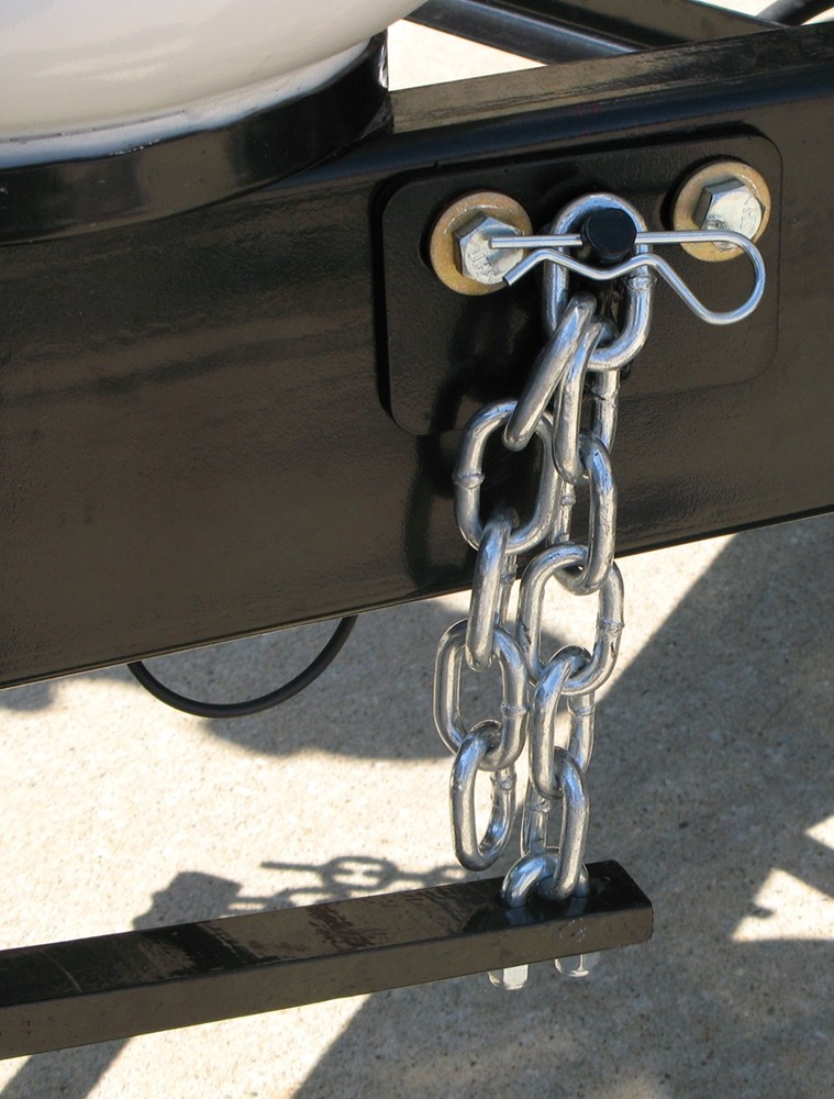

I have used the chains, like the picture above. I can't imagine using the fixed links. You adjust the chain links depending on the load and how it is loaded.
I agree not to set it up with the chains at an angle. They have to move back and forth as you turn. If you start out with them at an angle, I don't know what will happen on a sharp turn. There may not be enough range of movement and something will break.

One additional point on the chains, you need to adjust the head height and angle to allow several links in use. The more the better to allow more freedom of movement. I have seen bars bend due to too few links trying to absorb the turn.
the setup vids detail all of this. min 3 links head tilt so that bars are parallel to frame when loaded, head height so that trailer sits level at load etc.

So I go to the RV place I called about the Equal-i-zer. They are selling the Equalizer AND what they called the "Equalizer 2"!!
The "Equalizer 2" aka the Fastway 2 Fastway Trailer Products - Home looks like a less robust knockoff of the Equalizer. It's also sold by etrailer. And provides 2 point vs 4 point sway control.
For a 12K WD the E is $600, the E2 is $415.
