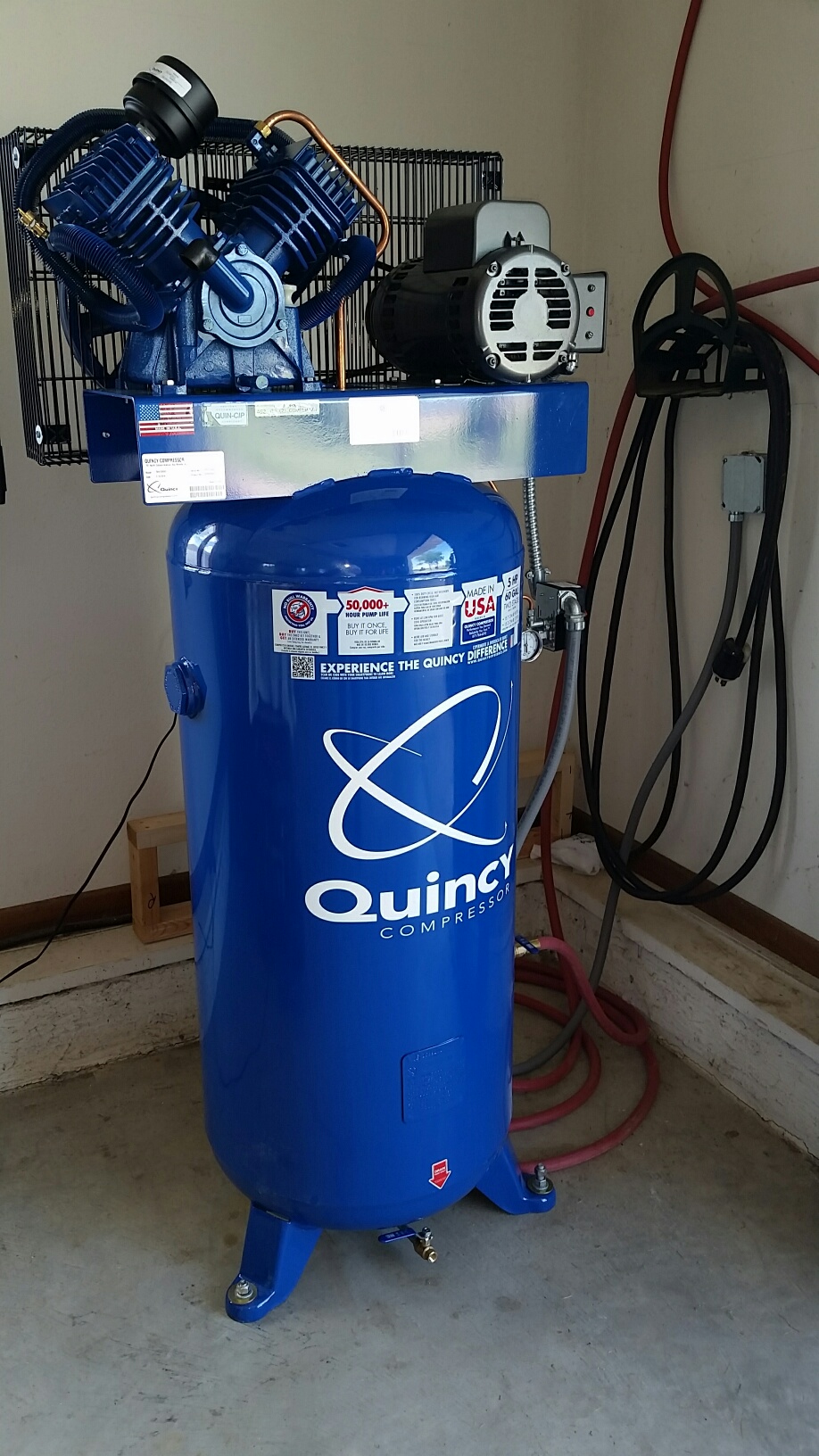

That Automatic Compressor Drain Kit that rswyan posted looks interesting. For spiting water out of the hose you need a water separator 25 feet downstream of the tank. I bought a 25' x 1/2" hose for mine and coiled the excess hose on the floor and up to a water separator.
In my pic, the separator is just outside the pic on the right. It's a little congested in the corner with the compressor power line and a generator drop cord.

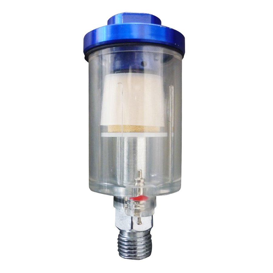

I bought a 1/4 " Kobalt In-line Moisture Filter at Lowe's cheap and put it at the end of the hose (the size hose I have on both my compressors). I put a male air coupling on input side and female air coupling to 1/4" male thread on output side. It is moveable between compressors. Have not used it since installing so I can't say how it works yet.
