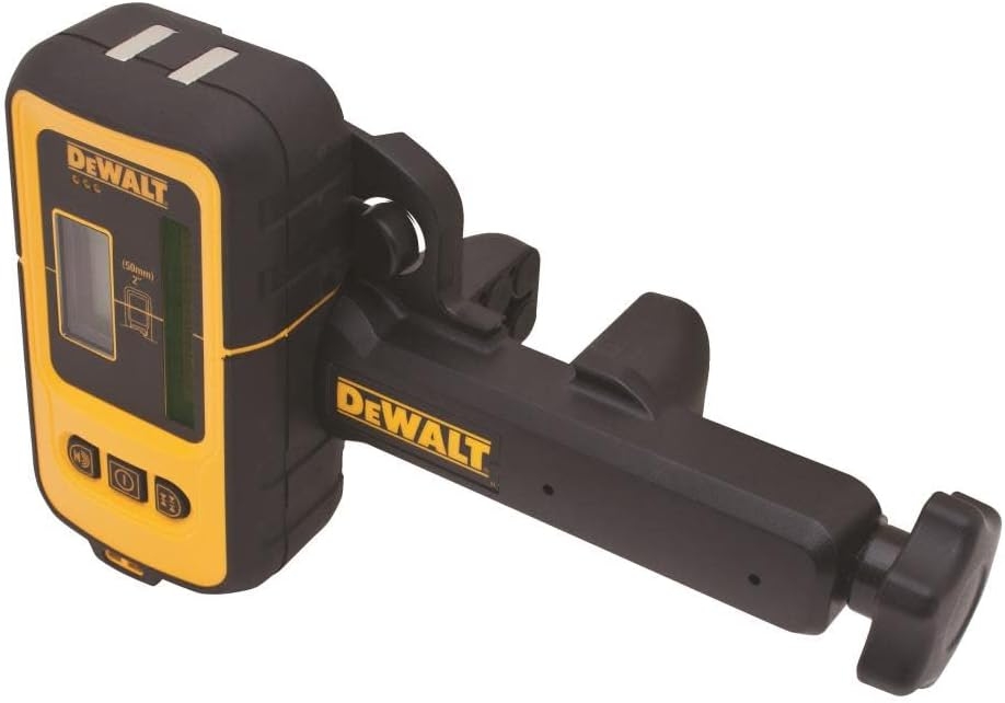

Can that use a FlexVolt battery ? :)
No, it uses a standard 9V battery.
Just as well. A flexvolt battery would add considerable weight & bulk, making the device more awkward to handle.
