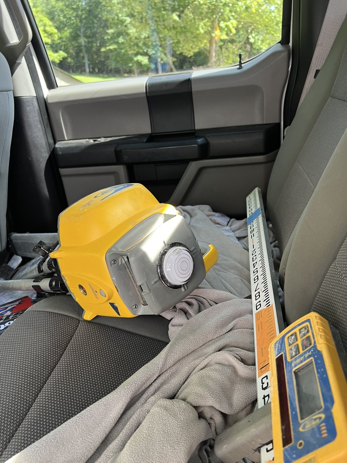

Mine works great. I glued a disc level on the head so can set it some degree of level and the auto level function does the rest. A string level isn’t very accurate at all. A water level works but takes forever.

I bought a Spectra 200 laser level on Ebay about 20 years ago that's been awesome. I haven't used it in a few years, but when laying out a pad, running my drain lines and even when digging my big pond, it was used almost daily. Technology has improved, and prices have come down, but for me, I still want a name brand tool for something like this. Since I couldn't afford what they cost brand new, I kept an eye on Ebay for one in my price range. It took a few months, but eventually, it happened.
