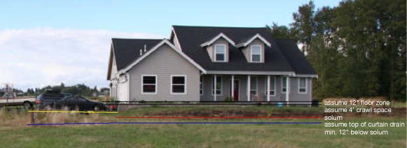

Having my point of view ridiculed makes me mad but it also makes me stubborn. So I undertook a little desk exercise using your photographs. I imported one of the house and road into a CAD programme and adjusted the size so it was to scale. I then marked the approximate positions of the existing floor zone assuming a depth of 12", your crawl space, assuming a depth of 4' (base of crawl space is the red line) and an assumed position for the curtain drain on the basis that the top of it would have to be lower than the solum level if it were to reduce the water table to below it. Here I've assumed 18" lower.
I've projected the line of the curtain drain to the road and the yellow line gives a guide of where the road surface is, contiguous with the outside wall of the house on this side which is where the curtain drain would be. I've assumed that the leg of the circuit drain conducting water away from the building falls a modest 1o, the rest of the curtain drain around the foundation being level.
Given these assumptions, and the relative inaccuracies of the method I've used here, I calculate that the curtain drain would discharge at a point slightly more than 4' below the level of the road. Maybe I'm missing something but if this were the case, or even if I were out 12" or more, I can't see how it would work. This would surely be below the level of the bottom of the road ditch which must have standing water in it during at least part of the year and so, in turn, be below the water table.
Unless there's another ditch or channel you can discharge into elsewhere, the solution you propose - or a sump pump - are surely the only options?
I invite my logic to be shot down in flames but please let's keep it mannerly.

Surely your construction kung fu is greater than mine. However, and do correct me if I'm misinterpreting, but you'r saying that is it unlikely that, due to the depths shown in the picture, draining the crawl via methods mentioned in previous posts would work due to the fact that my crawl extends too low?
I might be able to help w/ a few things. First, the footing drain (likely the downspouts too) empties into a ditch 225 feet away from the property. That would be approximately another 200 feet in back of the perspective of that picture. It empties into a ditch that does not ALWAYS have standing water. It only has standing water when it rains. However, my drain, 3-4 in corrugated pipe sticks out about a foot below the ground, emptying into that ditch. It is always running. Even when it hasn't rained for a week (which isn't often up here). That pipe stops flowing in May, which, I'm assuming, is when the water table receeds.
