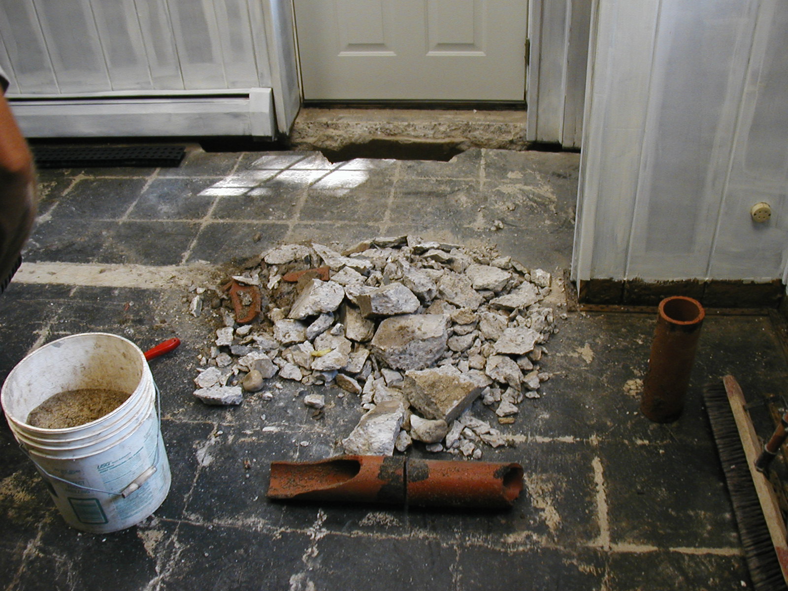

Good Evenin John & Eric,
I just wanted to take a short minute to thank you both for your excellent replies, and very informative input on the subject of cellar drainage and waterproofing ! Im hoping to get back into this job mid week just intime for the monsoon rains predicted ! ;)
I will keep you both updated with any new progress ! Thanks ! :)
/ Water in Basement.....Help
#67
Good Evenin Guys,
Had a little bit of time tonite John, and was able to raise the drain tile tube up to floor level ! I used a couple of clamps to wrestle it up to floor height ! ;) I also was able to get my prybar through that center section underneath the middle section of flooring that I didnt jackhammer up for floor support. This way whatever water is in the far section of the trench will drain to the sump liner !
I have tommorrow off, and they are predicting heavy rain so hopefully I can get some more work done on this project ! John, I put some 1 1/2" thick block down in the bottom of the drain liner for the pump to sit on. Hopefully thats OK !

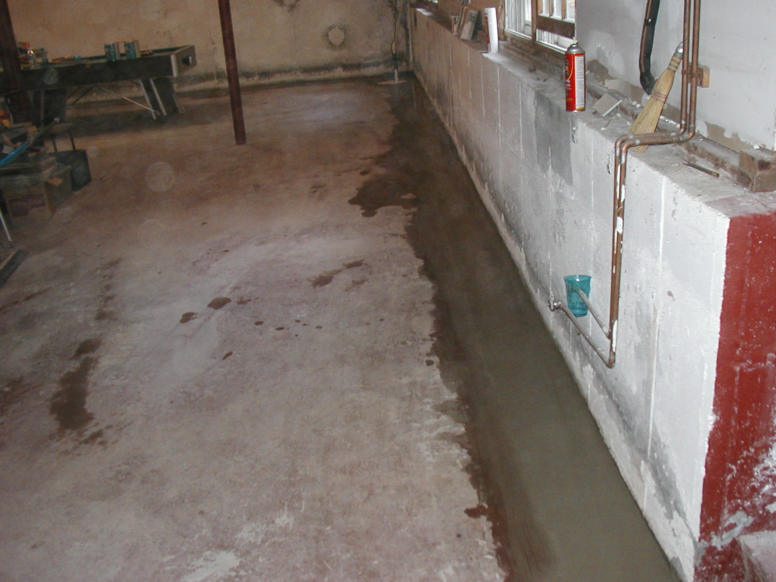

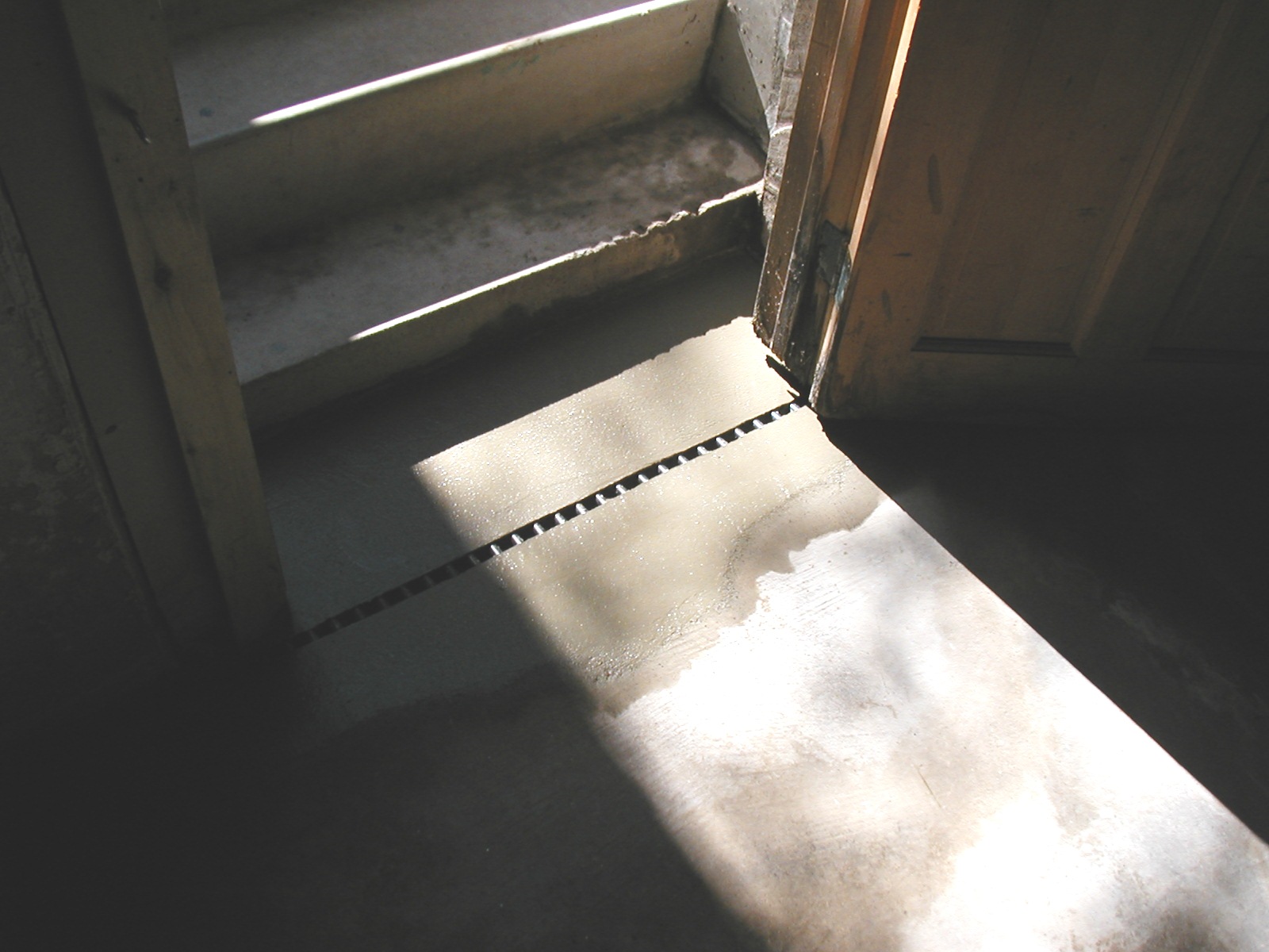

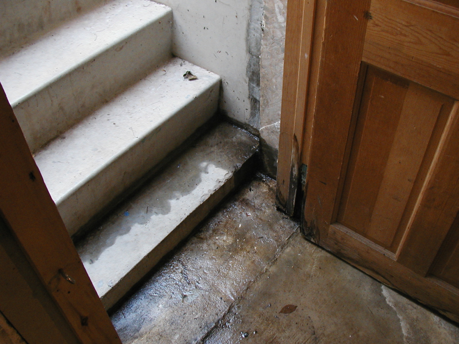

/ Water in Basement.....Help #68
Scotty,
Yes, you want a flat stable/level base for your pump, you can put an inch or 2 of the crushed stone under the patio block, that helps you shift the block around to get it as level as possible, a little trick to this, if there is water in the pit like in your case, is to pump the water out, leaving enough to just cover the surface of the block, then you don't need a level since the water surface will be true level in all planes, just move the stone around till the top of the block match's the surface of the water.
I see the holes in the liner you referred to, is there more than 1 row of those holes? if possible try to line the pipe up with one of the holes, but don't lower or raise the pipe more than a couple inches from the pipe path's plane along the footing. Ideally the pump would be set up to go on before the water level reachs the bottom of the pipe, that allows the water to always drain out and prevent sediment build up in the pipe.
Eric,
I am in full agreement with you about the advantages of doing the work on the inside, I just didn't want to push my agenda since like I said earlier, others believe as strongly that the outside is the way to go. I can just say that 99% of our work is on the inside, we wont even patch cracks from the outside (don't patch cracks at all) we make what we call an in wall channel drain, where we cut the crack (on the inside) about 2" deep and 1.5" wide, all the way down under the floor then we put a bridging material in the channel and cement over it leaving a hollow core in the wall crack and a hole at the bottom under the floor to drain out into the footing pipe. Never had a call back on one of these, everyone wants a guarantee and you just can not guarantee a patch, no matter how it's done IMO.
I do tell people that anything the can do on the outside would be helpful, but nothing they do will stop the water on the inside.
A couple of pics showing the in wall channel drain and what we do when those window wells (area wells) turn into aquariums, call it a window well overflow drain. we didn't invent these methods but have improved on them.

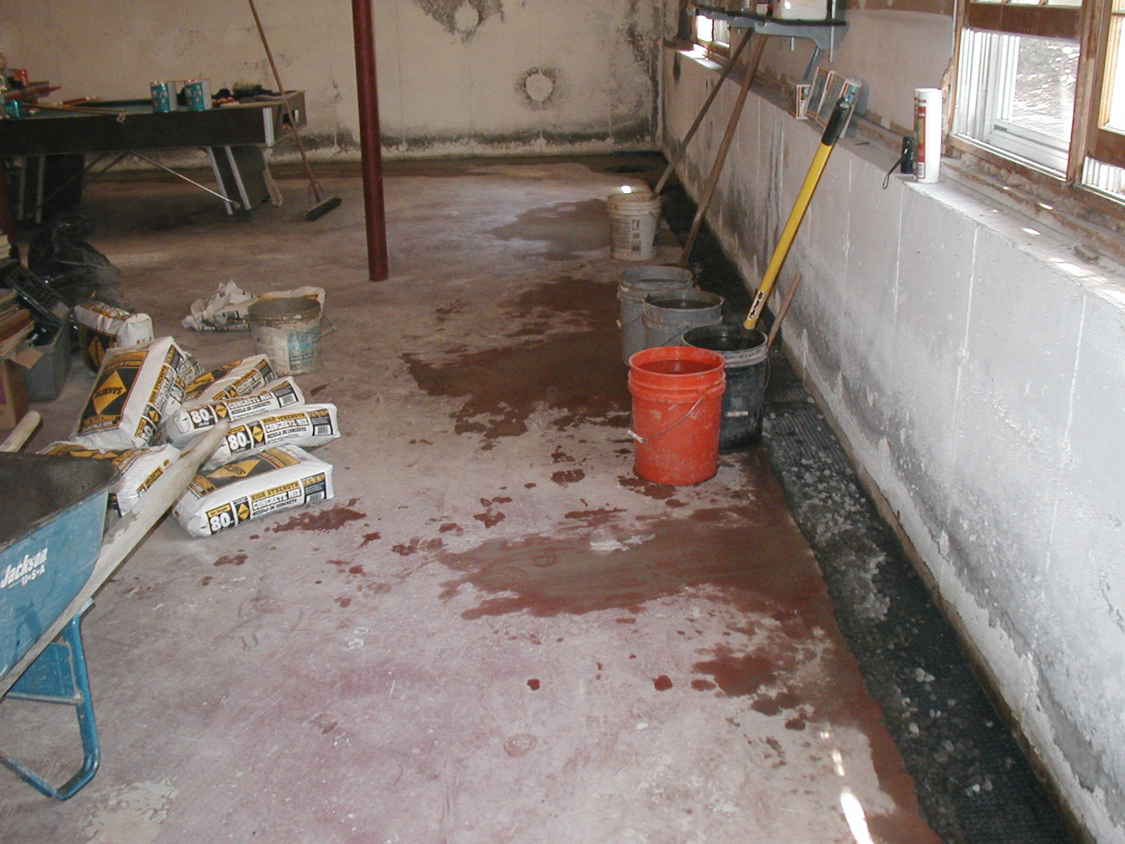

#69
JB4310 said:
Scotty,
Good Evenin Guys,
I did get some quality work time in on this project today ! :) John, yes there are two sets of holes around the liner, a few inches in from both ends are a series of 6- 2" holes around the perimeter.
As you can see in the first picture I managed to get the pump installed in the liner today. Although it didnt go as fast as I thought it would because, when I went and bought a 2" hole saw and arbor yesterday I got the wrong arbor ! :confused: I drove back to the store today and got the proper arbor and then realized that my 3/8" drill wasnt going to work, I needed a 1/2" drill ! :( At that point I said screw it and used my good 2" forstner bit and got lucky enough not to hit any nails ! :)
In the second picture you can see where I just layed the drain pipe in the trench with the right angle drain stuck on the end of the pipe. I also managed to get my lanscape cloth cut to size but not installed yet.
At this point if the trench fills with water the pump will take care of it, which makes me feel pretty good at this time ! Next time I can work on it I will need to get some 1 1/2" crushed stone and install my pipe.
I believe that you said earlier that I want the top of the drain pipe to be about even with the top of the footer ??? Thanks again !
