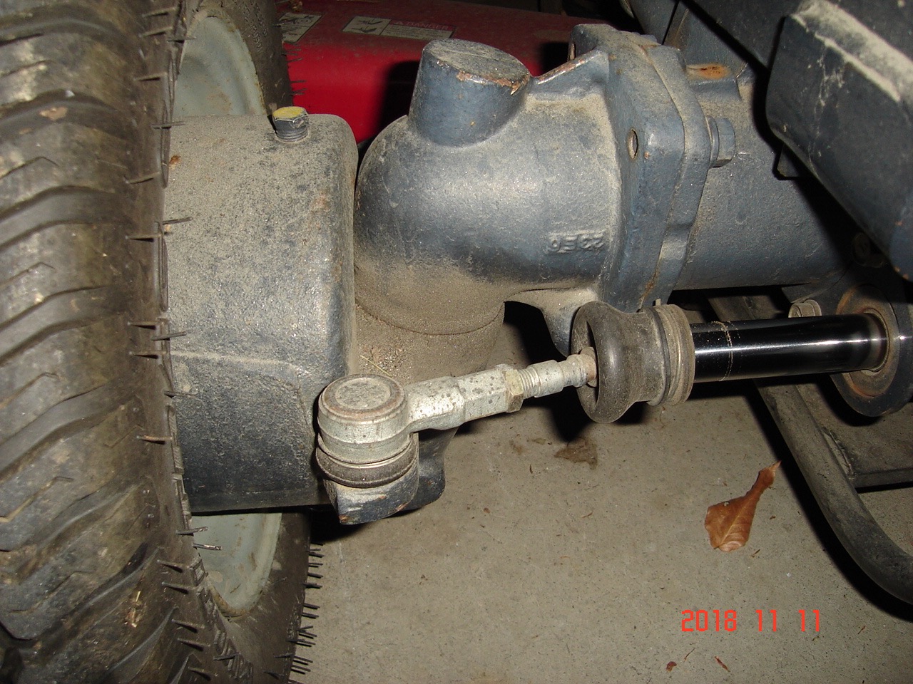

I thoroughly de-greased my 2310 a while back, and now can see some dirt/oil buildup around the right front axle. Somewhat disappointing, but it's not a lot... and I'm not worried about it...yet. Mine's a 2007, now with about 800 hrs on it. Attached pic is after about 5 hours of lawn mowing & leaf removal, pretty dusty, so the slight leak shows up nicely. Left side is still clean & dry. I take it your leak is worse? (maybe a pic?)
Observations:
1) Pretty unusual to have to change axle seals at only 89 hours!
2) I doubt you'll get any warranty out of work that was performed so long ago... but it may not hurt to ask, I guess.
3) ...and to have to re-build the steering wheel, again with only 89 hours... sounds like it may have been used pretty hard.. but these things are pretty tough. Great little tractors.

No streem of oil....so no leak !
/ Warranty on work #5
The gear oil is about the same viscosity as the Permatran. So, unfortunately it will not fix leaks.
There should be a breather on these to allow for expansion. It's been so long since I messed with mine, I can't remember if the fill caps have a breather valve in them. I don't think they did. :confused:
If that valve is not working, or there is too much fluid, they could be the issue.
The dealer will no doubt, feel real bad, and "take care of you", on a redo, if you complain. But, I doubt they will do it over, no charge.
Front axle leakage is not unheard of, but not a big problem with these.

If the "leak" is a minor seep I'd just check the level and keep it topped off.

That type of seal is problematic at best for seepage issues, and synthetic oil in general has a habit of getting through gaskets where dino oil won't.
It wouldn't hurt to talk to the dealer about it, they might take you out to the shop and point out several examples that show it's typical.

Also there is no vent and I did here some pressure being relieved when I unscrewed the fill cap for the front axle. I did have it in and out of 4x4 and worked the tractor yesterday. I checked it this morning .

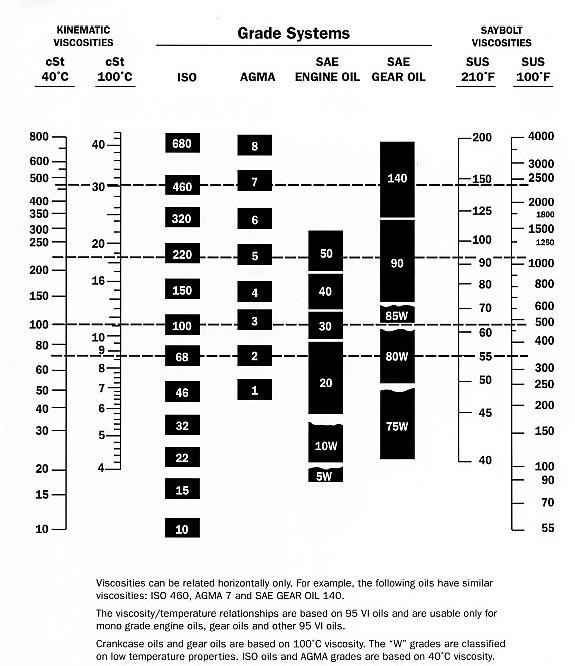

Disagree. Permatran is standard MF transmission oil which is much lower viscosity than 75-90WT gear oil
No, it's not.
You are making the common mistake of thinking the gear oil is heavier, because it's 75-90W.
But, gear oil is NOT measured on the same scale as motor oil, which is where the transmission oil is measured.
Both 75-90W, gear oil, and most hydraulic transmission oil, (which runs around 30W), are basically the same viscosity.
Viscosity varies widely by brand. A 30W from one company can be thicker or thinner than another, but give or take a small margin, both are about the same.
You will see this for yourself, if you do a simple side by side pour test.
Kubota SUDT is an exception, which if I remember correctly is closer to 20W.
That could be the problem.
Perhaps someone will know. But, I would think there is supposed to be a way for the pressure to vent.

Good info. I have never seen that chart before. The problem with the chart (or with my memory, one of the two) is that I was basing my comment more on the side-by-side pour test (really in my memory, not actually side by side) and I remember the transmission oil being much thinner than the bottles of "gear oil." Now I gotta go try that.
/ Warranty on work #17
They are basically the same product, with different additives. And, are interchangeable in many applications.
80w gear oil, and hydraulic transmission oil, are both light weight gear oil.
The transmission oil has more additives. (i.e. wet brakes, and anti-foam).
People have trouble accepting the fact that the 80-90W gear oil is not thick. Because, the 80-90W classification convinces them it is.
You should be able to see it by eye, when you pour them. But, even better, you can do a timed Zahn cup type test, (cup with a hole in it), or a side by side cup, or bottles, with a hole in it, test.
Again, viscosity often varies widely in products of the same weight. But, you will not see a difference that is significant between most of them.
