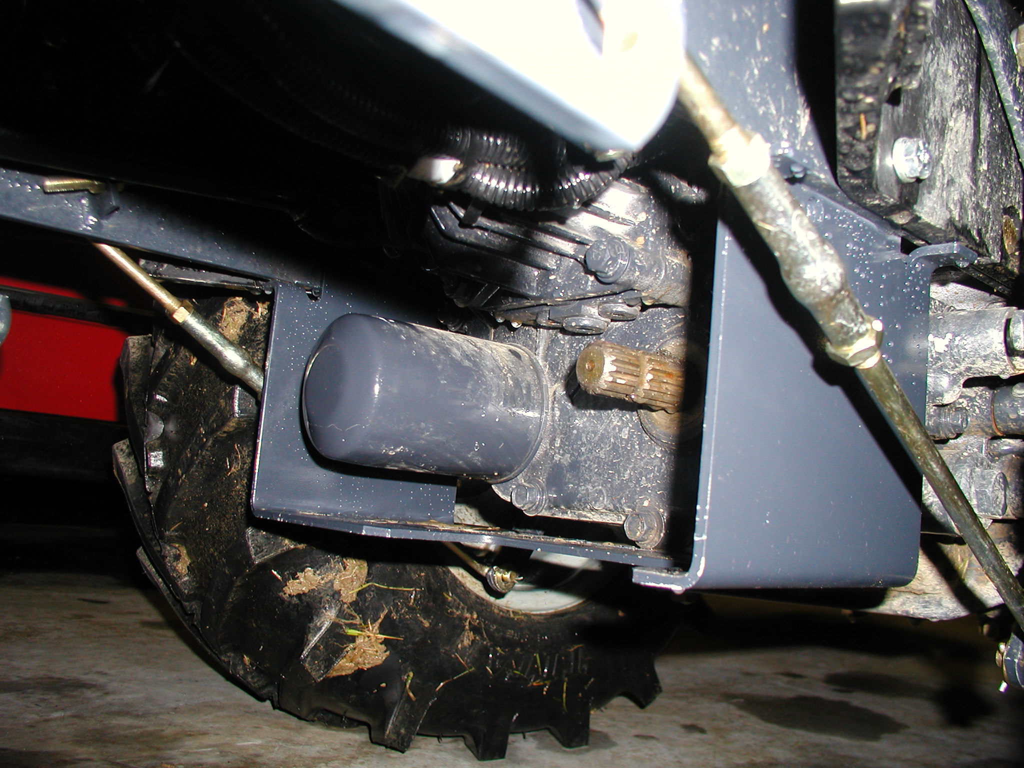

/ Warranty on work
#23
The previous was an accident. Below the first two pics are operators right side front and the last two are operators left front axel. Thanks againIMG_7190.JPGIMG_7191.JPGIMG_7192.JPGIMG_7193.JPG
Yea the operator left side I wiped down prior to this post. Did It when I changed fluids. Thanks again for the help.
/ Warranty on work #24
Thanks for the photos. That is a little more evidence of leakage or seepage than I'd call normal or typical in my experience. However, if I'm in your shoes, I'd keep a careful check on the level of the lube and just watch it. I would NOT be running right out to replace any seals based on what I see there. You have not seen any drip or puddle on the floor, right ?
/ Warranty on work
#25
No. I haven’t seen any sings of fluids coming off the tractor. Minus the whoopsie I had when draining the hydraulic fluid. Big guy. Small space. Thanks for the insight. It reassured me. Next question if I may. Just recently I heard i high pitch, but not really loud whine coming from the front of the tractor when I lowered the arms. That’s the only time I heard it and it was consistent when lowering only. It happened with or with out weight. Well not really weight as I was moving bins of leaves. Good thing too. Freaking snowing pretty good out right now. Any thoughts?
