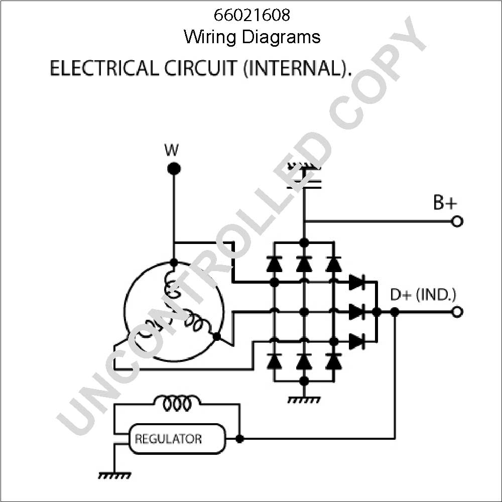

9.20 Evidently tachometer is connected to alternator in some way. Will have to take rear shroud off and start checking wires.
The tach is probably connected to the W output.
/ Warning lights on while running and do not go out
#9
Agvg: I found the wiring diagram.
It is connected.
There has been a suggestion that I take an 8 ga. wire and connect it between the alternator and the hot lead on the starter. That is supposed to bypass the wiring harness. Would this work?
