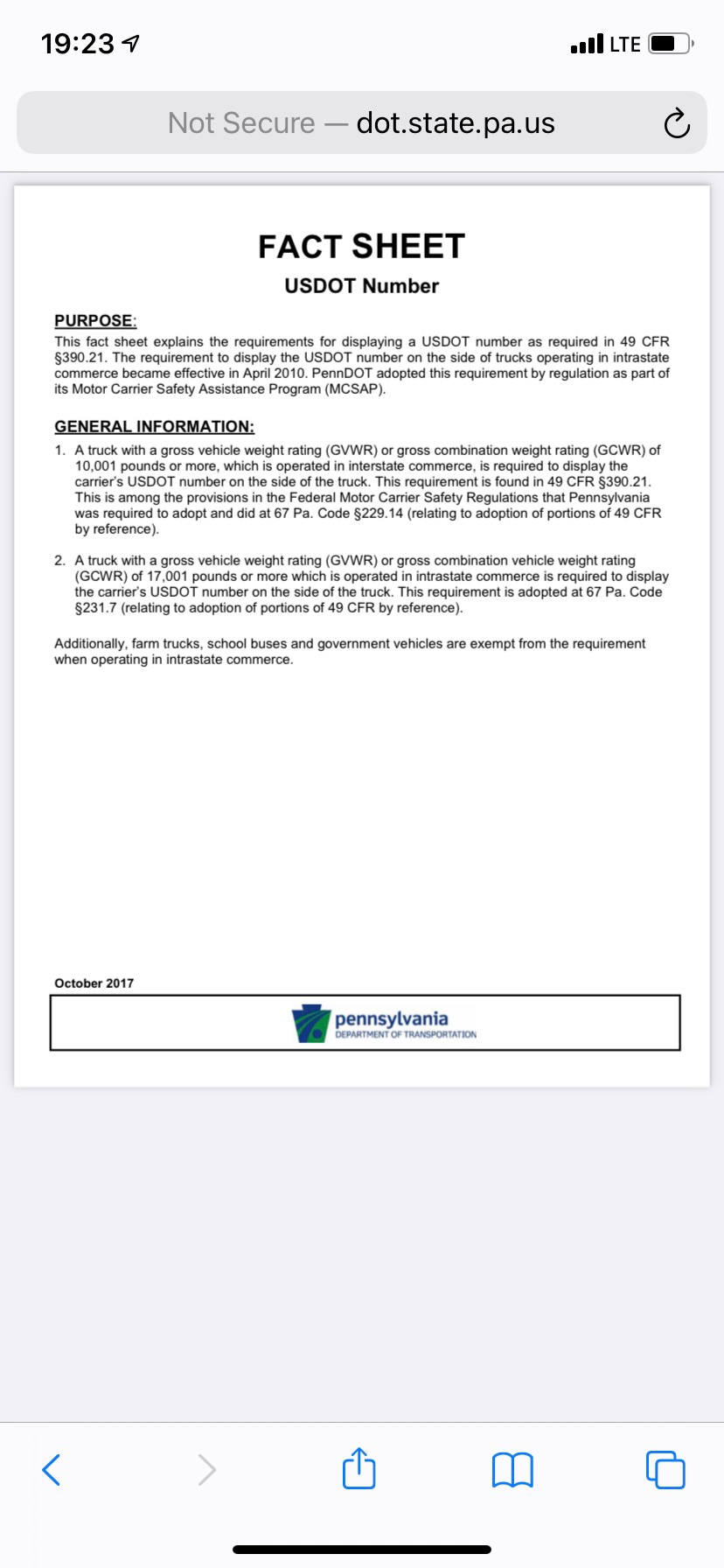

Scratch those tasks, I don’t leave PA, was correct before.
That is pretty wild. Per your link it is obviously a PA intrastate thing. I am not aware of any other state in the nation that has that number as a threshold.
