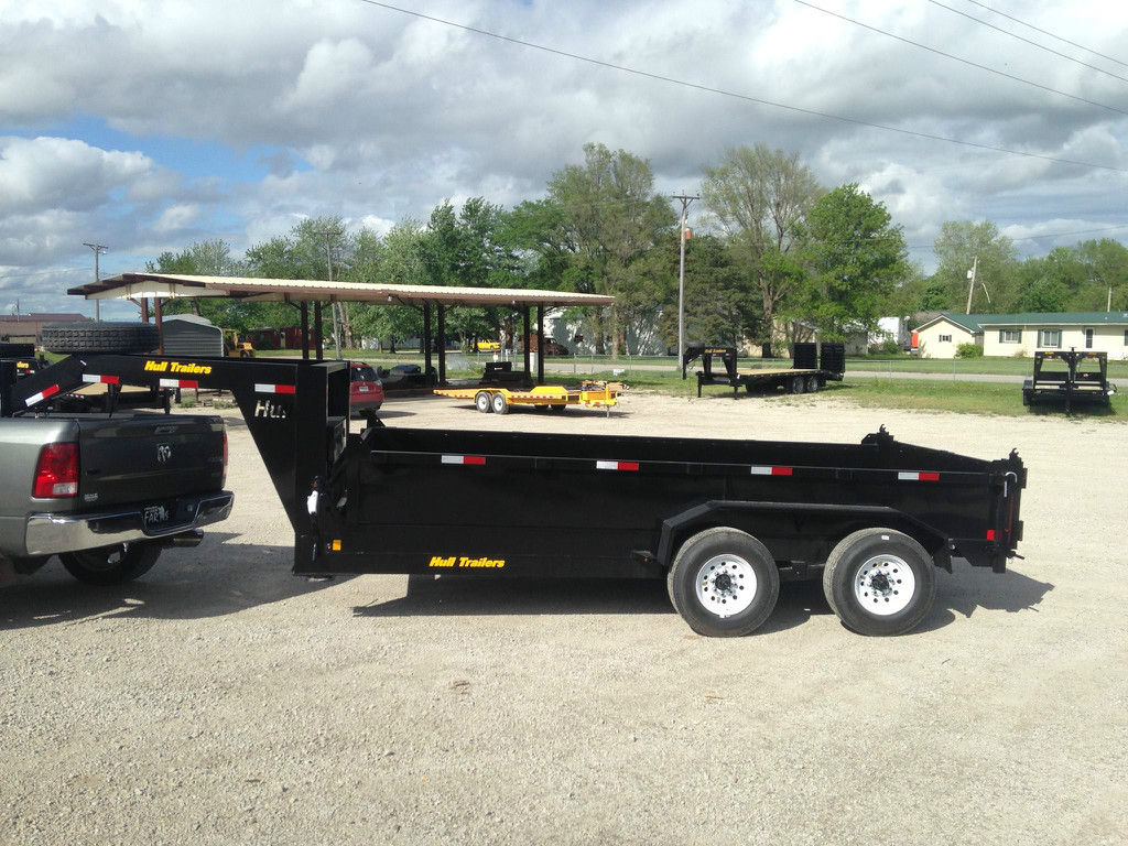

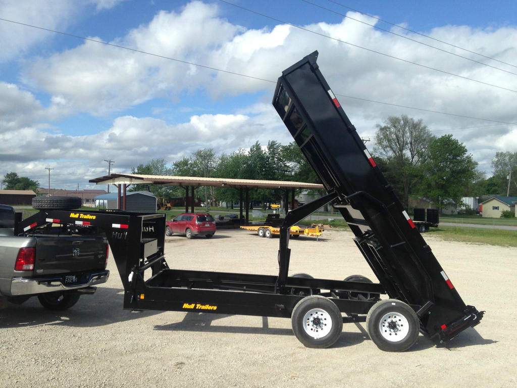

Company up in Iowa right by the northwest Missouri border. Owner is the one that originally started H&H back in the 90’s.
The link don't work for me so I did a search and found their web site. They have a lot of good info, yet some of the important stuff is lacking. Overall they appear to be a fine trailer. Only 20" sides standard, $70 per foot for 24". The sides would concern me, no side stiffeners in uprights or horizontal, just the top rail. I wonder about the axles, generally if name brand is used, they say so, it is not posted.
Do your research, read the fine print and look at other manufactures, they are not all created equal. Add up your options, tarp kit is a must. Couple pictures of the spread axle model.
This link might work: Equipment Utility Trailers For Sale | Pullhp.com
   / Want to buy a dump trailer, kinda torn here. #175
Agree. That trailer looks light-built, but maybe it’s a 10k dump. Agree the sides look flimsy. Cant tell how heavy the hoist is. Dump angle looks good.
View attachment 696130View attachment 696131
I’ve looked at all kinds of brands now till I’m blue in the face. I’m around a lot of construction jobs for work and see various brands. Mainly big tex, I’ve seen a PJ or two, H&H and some load trails and one Diamond C. I also looked out the HP’s when I bought my my other trailer from there. The Big Tex’s look cheap and cheaply built imo. The load trails I’ve seen look pretty solid but they sit high. I’ve called a local dealer about a PJ and they want a arm and a leg for one of he could even get one right now.
