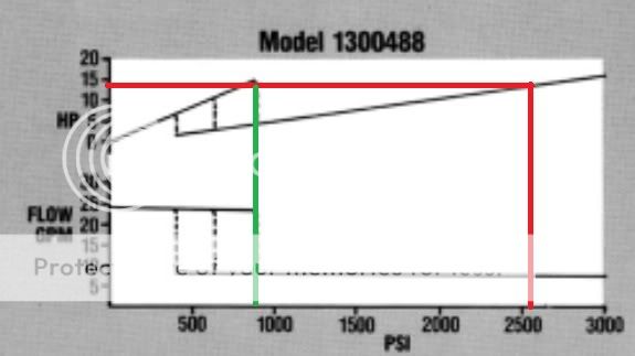

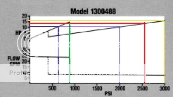

22GPM Barnes. P/N 1300488. Notice high flow @750psi peaks at over 14 HP (red line is approx 14hp).
I might have to adjust the shift point lower ... Not sure if i want to screw with it though. It splits everything as is
Are you saying that it is stalling on the HF-LP side?? I thought you said it was stalling above 2000psi which could care-less where the HF-LP side is set at.
And if you have enough power for it to shift with it set at 750psi, you certainly shouldnt be stalling at a tad over 2k on the LF-HP side

Northern says its rated 22GPM@650psi and 6.5GPM@2500. If its shifting at 650, that puts me at around 11 HP required. 11HP should only capable of pushing 2000 PSI with that pump.
Heres the same curve with ~11hp, 650PSI (LP) and 2000 Max press.shown in blue. 3000PSI is in Yellow. In order to hit 3000, you need minimum 16HP by that curve. The calculations say that shouldnt be the case though. It should be OK with less. Thats why I suggested going bigger than 14 and certainly bigger than 10 or 11 as Northern suggests. In practice the pump uses more HP than it should

If your pump is shifting and is stalling your 14 hp engine at 2500 psi, that is exactly what the red line in your diagram tells me it should, within 10 - 15%. That's about as close as I would expect under the conditions I would expect on a splitter. Oil viscosity and filter condition (if so equipped) as well as ambient (outside) temperature will all affect oil properties and back pressure.
I agree..
The whole point I was trying to get at was that Northern and Hyd Sirplus are saying that 10-11 hp is OK to use. You'll never see its rated output using that (aside from what IO and TW seem to be getting away with)
Curve calls for ~14 ish HP, but i could never get it reliable with MY 14Hp engine at 2500. I agree there can be outside factors as listed in your post.
Calculation says you can get by with 11.15 Hp@2500 & 6.5 GPM. (2500*6.5)/(1714*0.85) = 11.15 HP
Basically all im saying is follow the curve as the bare minimum and not the calculation when using these pumps, or you'll end up short on HP, doubly so when you start figuring in real world conditions like thick oil and other loads.
This is what burned me. I calculated (and read) ~12Hp to run the pump @2500 reliably. I stepped up a bit and went with a 14Hp engine. I still cant hit 2500 reliably. I really need 18 maybe 20 , in real world conditions.
