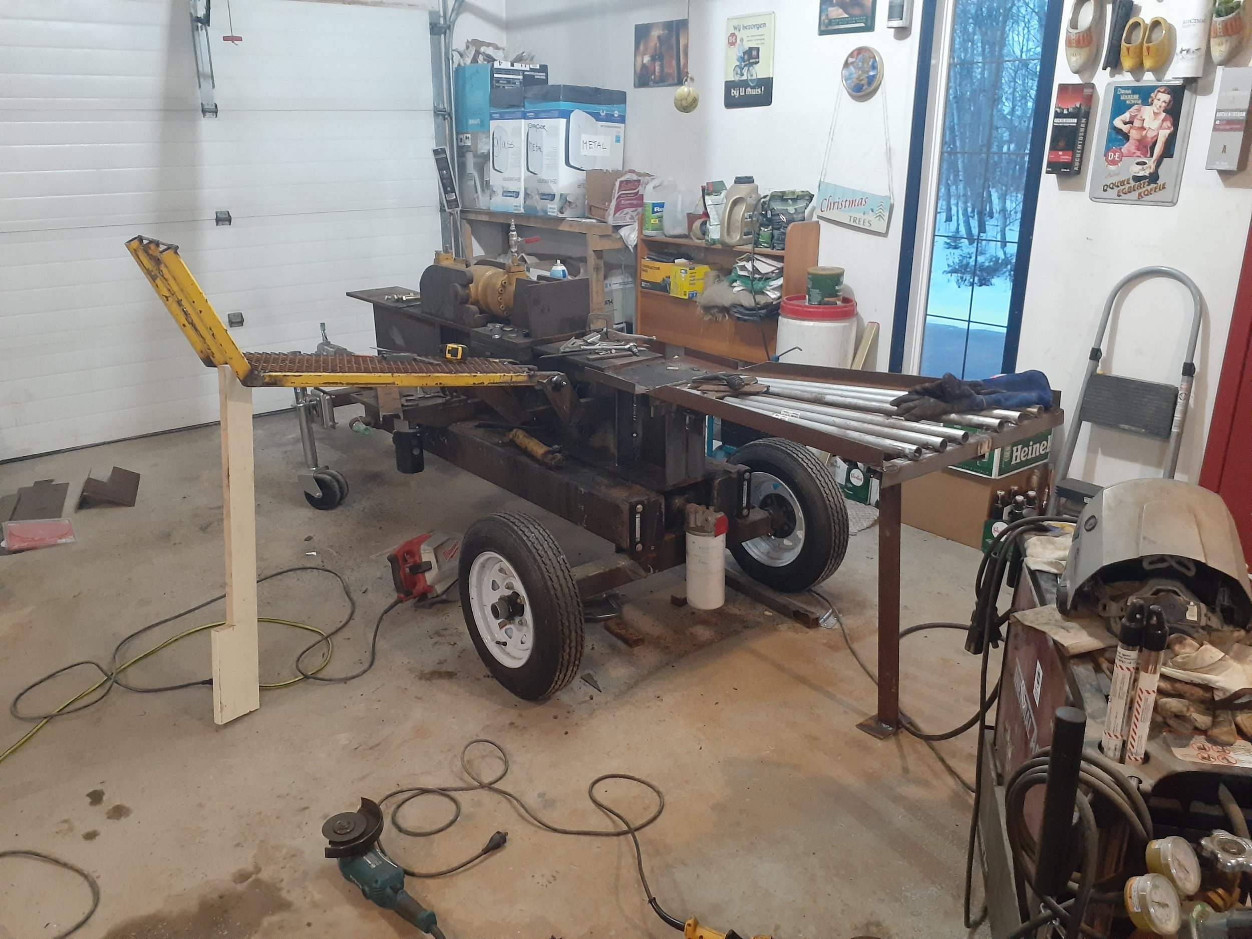

   / And yet another log splitter build #23
Richard it's beam is a light weight 8"-18# house beam that I scrounged off a house development. She flexes pretty good.

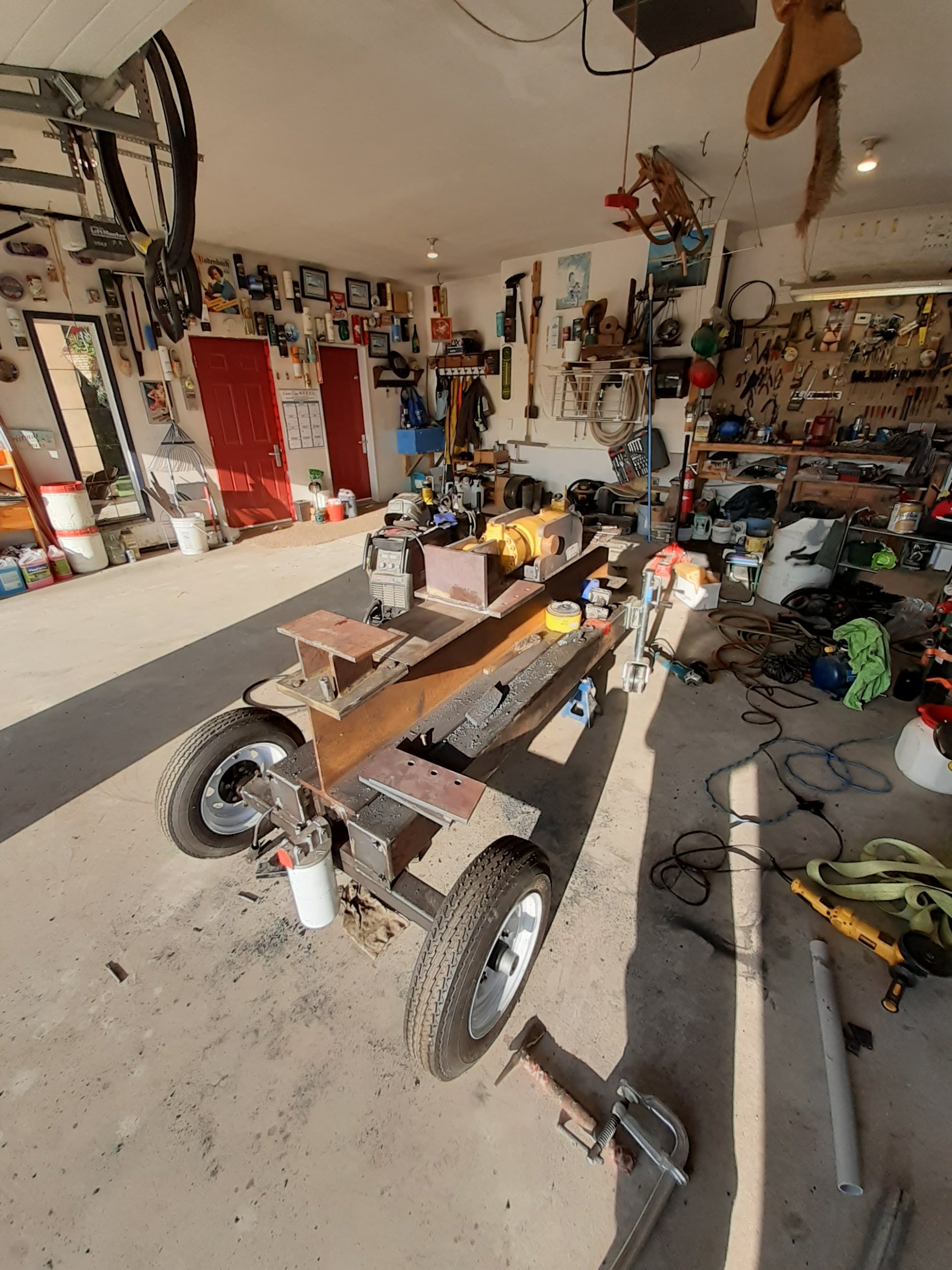

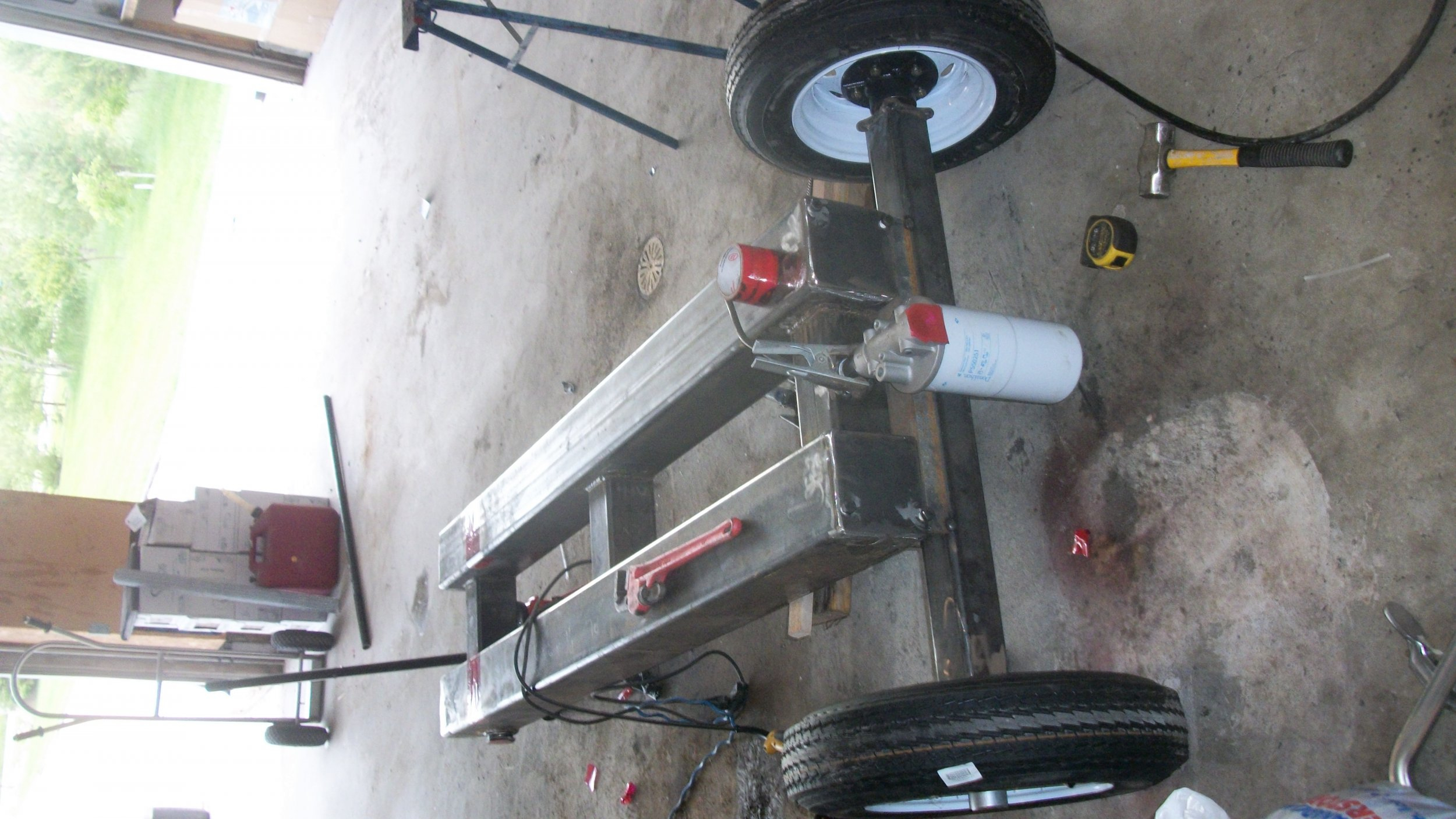

   / And yet another log splitter build #25
Well, decided to build a splitter as i couldn't find any of the lower priced ones liked. the main beam is a W14X61 the oil tank is double 6X6HSS holding about 80 liters of oil, the motor is a old 19hp briggs opposed twin with a 22GPM two stage pump, the cylinder is approximately 5" bore off of some sort of cat NOS from the scrapper. if i did it again I'd definitely do it different its very tongue heavy but it does allow you to pull it from the pile of splits rather than burying your own hitch. Still need to find a way to slow the log lift down. (sorry don't know how to resize these)
View attachment 727891View attachment 727891View attachment 727892View attachment 727893View attachment 727894View attachment 727895View attachment 727896View attachment 727897View attachment 727898View attachment 727899View attachment 727900
Very good job. What's the painting setup you have used there? Painting job is spot on too, all project is nicely done. Well done. :)
#26
just a cheap canadiantire mastercraft paint gun with rust oleum and hardener, not much experience with the hvlp painting setup most of my painting experience has been with industrial airless setup. it turned out decent.
   / And yet another log splitter build #28
When I built my splitter I also made it out of a beam that was undersized. When I got the splitter completed it would split fine, except if it had a piece that was a little tough to split, when it made it through both halves of the wood would end up about 8 ft on either side of the splitter.
Took me awhile to figure out what was going on. It was a little scary to split wood with it. I finally figured out the splitter beam was flexing, you could not even see it. But it was just enough that it stored enough energy that when the anvil made it through the wood, it had enough velocity for a very short period to fling the wood to either side of the splitter.
A truss welded to the beam to stiffen it fixed it right up. If you look at the splitters you can buy at the store, most of their main beams are fabricated and stitched together from flat stock, even though from a distance they look like I beams. Don't be afraid to add some metal to a main beam to make it stronger.
