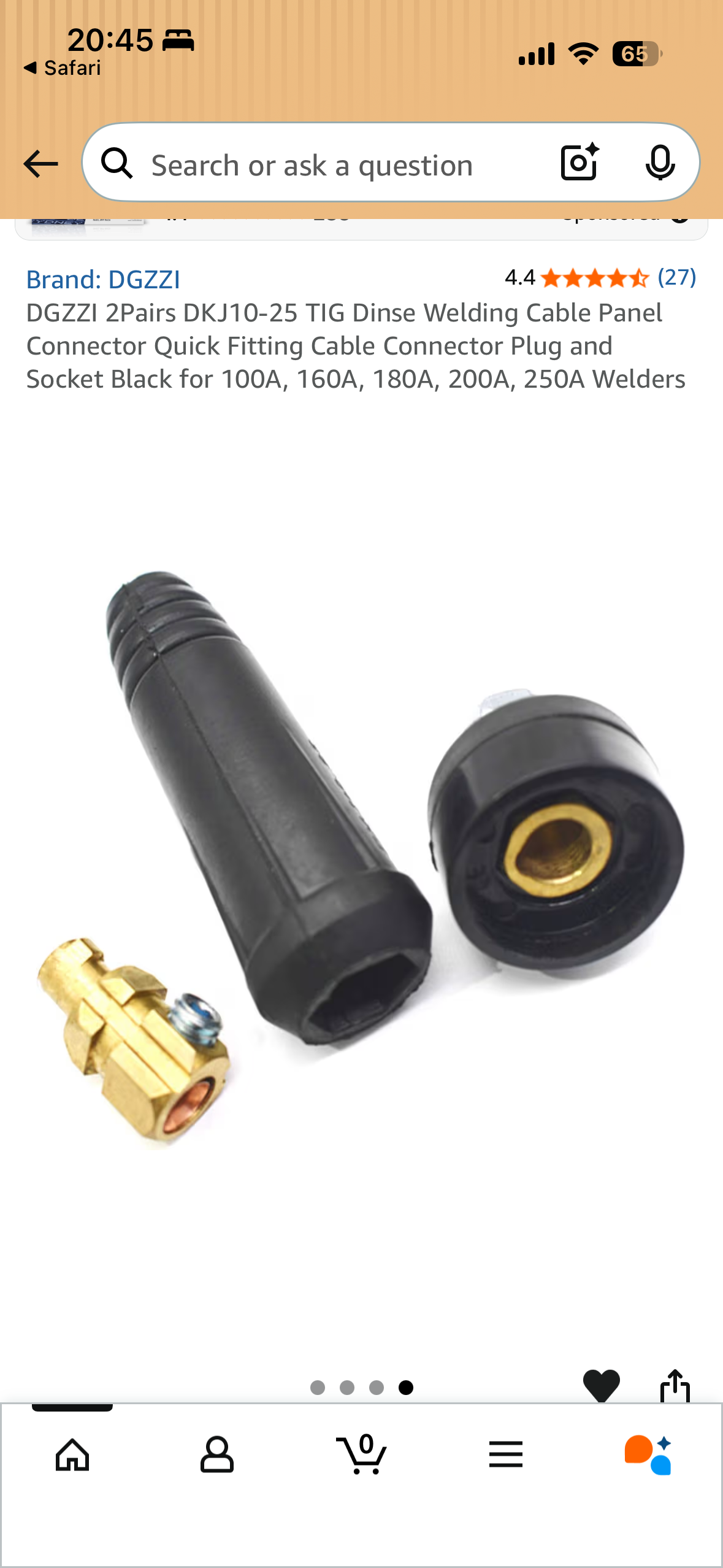

All I want to mount a quick connector for my generator ground wire.
Would a Dinse 10-25 panel mount connector work or is there a better option?
Dinse 10-25 connector & panel mount:​
Note the wall is brick/rock.

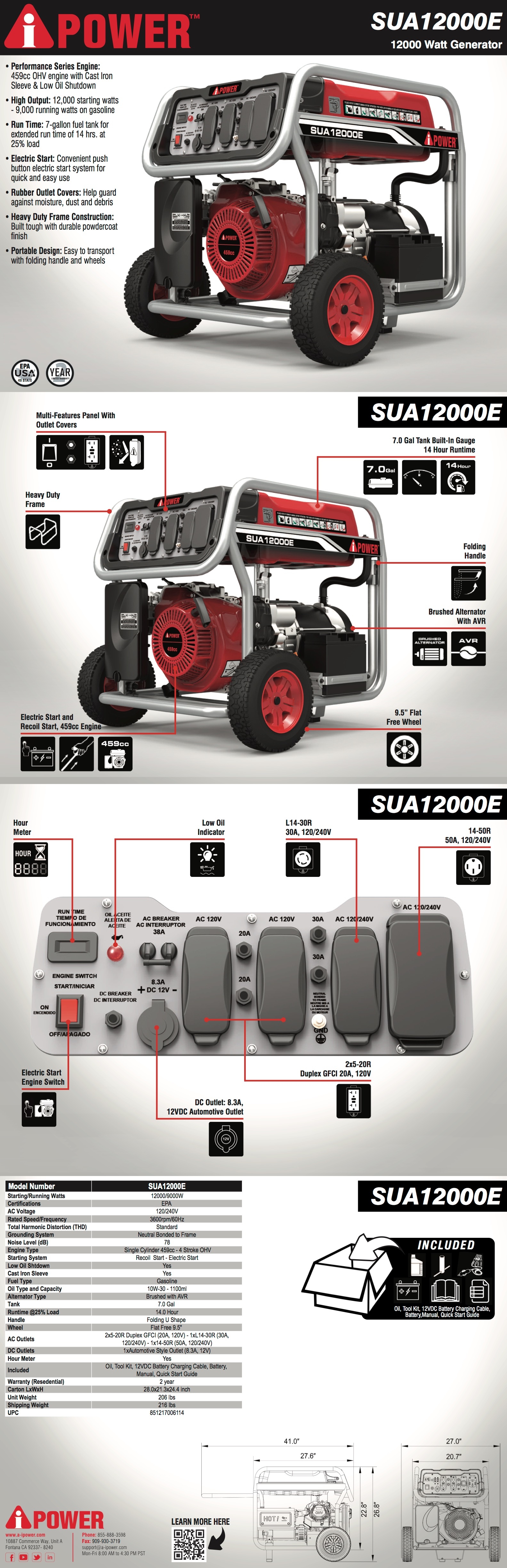

Peter,
1) is your generator internally neutral to ground bonded? It states it is neutral bonded to the frame.
2) does your plug go to a transfer switch, or a breaker interlock? It connects to a breaker interlock.
3) n/a
4) is the ground rod specific to the generator? No it’s also the house ground rod.
5) is your 12kW double insulated? It doesn’t say if it is.

If your generator is permanently wall mounted why would you need a quick disconnect for the ground? If you forget to attach it or it vibrates loose you'll have no safety ground at that point.

The generator is portable.
I just want a neat and easy way to connect to the ground rod for the house.

Assuming you are feeding an electrical panel, the ground to neutral bond needs to be disconnected at the generator.
The Equipment Grounding Conductor (EGC) needs to be run with the neutral and phase conductors. The EGC needs to be bonded to the ground bar in the electrical panel you are backfeeding. This gets the EGC from the generator connected to the ground rod via the subpanel.
If there is no subpanel, then the neutral ground bond is made at the generator and ground rods need to be driven to connect between the ground on the generator and the driven ground rods.
The main point is you only want one point where the neutral and ground are bonded together. Otherwise you make a safety risk of possibly not being able to trip a breaker.

This creates a safety hazard. Ground needs to be a connection that can not be pulled apart.
/ Wall Mount Generator Ground Quick Connector
#11
Ok, but the dinse connector twist in to lock and have to be twisted to unlock.
The attached picture shows the lug that locks into the female end.
/ Wall Mount Generator Ground Quick Connector #12
The safety issue is that a DINSE connector can, fairly easily, come apart, unlike a ground wire bolted to (second) ground rod.
There's a difference between trusting a temporary electrical connection for use for a non-life safety use such as welding versus a life safety use to keep you and anyone else who touches the generator safe.
My advice is put in a second ground rod, and every time you use the generator either bolt the solid ground wire from the generator to the ground rod, or bolt the wire attached to the ground rod to the generator. Don't touch the house ground rod or the house ground wire or the house ground wire clamp.
Is that clear?
All the best,
Peter
