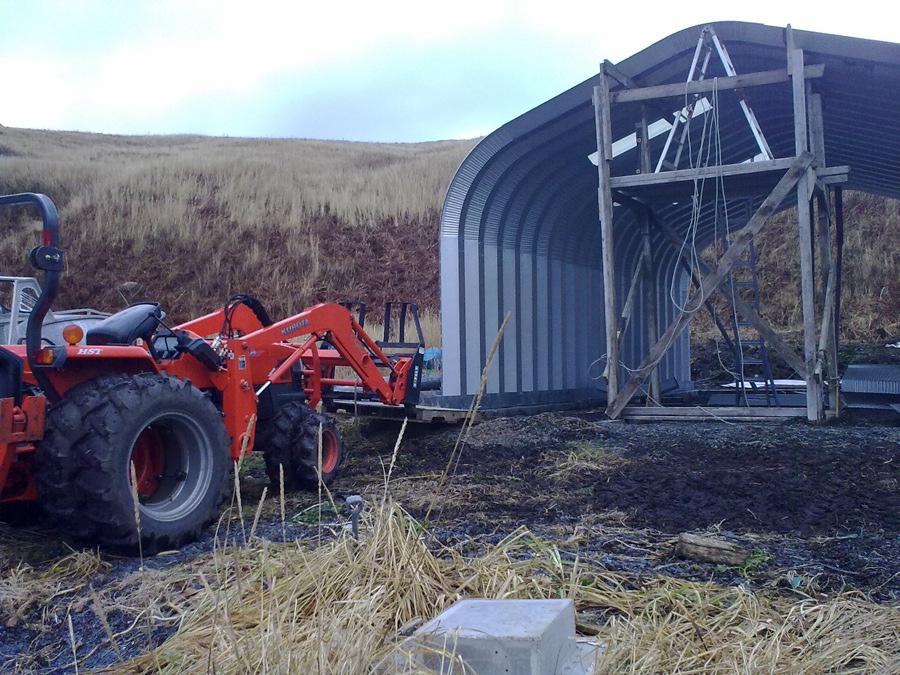

I can't believe that people are putting those steel arch truss buildings up in 3 days. Has taken me almost 3 weeks just to get all the arches up but got the last tonite:drink:scotch n a cigar.
Then tomorrow get to bolt it all tight and then the end walls, might make it done by thanksgiving. End walls should be easier as I can reach both sides at the same time for bolting hopefully. No more up and down a ladder 2x just for one bolt, yea!

Will do thanks yooper, got enough scotch for one more after tonite and 1 more cigar for when it is all done. Rigged up 2 4x4's with a cross piece to hold a wrench for the roof bolts, haven't figured out what to do for the sides. Maybe just make a couple of varying lengths to lean against the wall. Need a few more half inch wrenches. Hopefully won't have very many that I can't get from the inside alone or need arms that stretch as long as rubber man to reach around the building:laughing:
Anyone out there got any ideas of holding a bolt you cant reach?? Wish I had a couple big sheet magnets out here, that might have worked with a stick tied to the wrench to catch on another bolt head.
Last 3 arches were ez as I took the pallet off the forks and was able to go from fork to fork up the walls putting the bolts in, didn't have to use the ladder.
If you are saying,"you can get the bolts in the panels and then trying to put the nuts on".
When you install the bolts, put some silicone sealand on them. Let it cure. Then install the nuts and tighten them.
I'm not sure I understood what you were trying to do. Maybe this will help. Dave

CTW the building is sitting on beach gravel, 4' down it is pretty much a river of fresh water coming out of the whole cove so it is great drainage, just pulled the beach grass and poured the footings
Mark V The building is 50x26x16 so hopefully there will be room for the tractor too. I do 3 or 4 fisheries out of here depending on the year. Used to live here most of the year round til the kids needed school in town then lived in the town of Kodiak during school year (135 miles by boat) but the last one just flew the coop this summer so will get rid of the house in town along with the wifes job in the next year or so. This will be home base then with a few months in Oregon and a little harassing time our 4 kids thrown in wherever they end up.
As far as deadliest catch goes, I am no expert, only seen the show 2x but I do have over 30 years fishing both the Bering sea the gulf of Alaska and they really hollywooded the show up. It is way more fun than they let on.
No other tractors around here(but a neighbor emailed me the other day and said he just bought one) a few have bobcats but I wanted the pto and double attachments that a tractor would give me. Had to do the duals as the tractor without them can barely get up the beach. The dealer set me up with the rears(unverferth.com) but wouldn't help with or warranty the front. They were ez to make with a extra rim that I cut up and welded to the smaller wheel. Until my wife quits her job, I am mostly solo out here so I will be hangin out with you all on tbn alot!!
Crazy Al, thats a good idea about the duct tape, would have to torch it to get the frost off but then it should stick. Got the first 8' of the side walls today, used the air socket wrench set on 60psi and it torqued just right to seal the washers and for the 3,487,409 bolts I did(slight exageration) only 26 spun on me so with so few I just grabbed the tail end of the bolt with the vice grips and tightened the nut with the end wrench. Figured that few if I ever have to take them off I can just break them off. Someone was smilin on me today and if I have that kind of luck tomorrow with the bolts not spinnin, I should finish tightening tomorrow.

Yes I am happy with the building, it is rated for 150 mph winds and all thru the construction I have had 50 plus knots from all directions and it has done fine. We had gusts over 70 last night and everything was still there this am even with no door and half the front wall missing. I would not build another one solo though, having just one other set of hands to put a nut on while you shove a bolt thru would probably 4x the speed and save a lot of running back and forth. Doing it with the trough foundation would have been impossible solo with my weather but the welded base plate made it fairly ez and kept things from moving around with the wind. Will put a wood floor in part as well as lofts on 3 sides in the spring when I get back. Be nice to have some room to work out of the weather and my little Kubota is glad to spend the night oow too:laughing:
