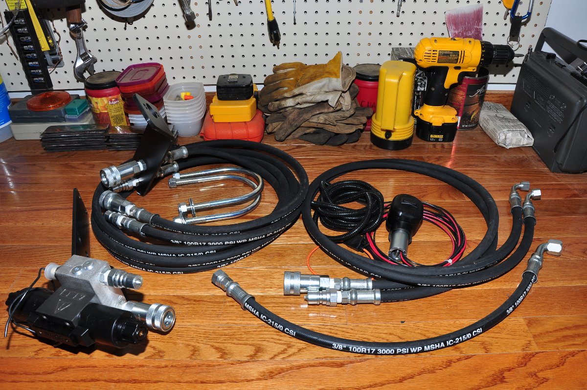

I'm about to pull the trigger on a W.R. Long third function electric over hydraulic kit for my 2008 Kubota MX5100 with LA844 FEL.
I've called four different dealers in two states for pricing. Three quoted the identical price of $571 for the valve kit and $95 for the bulkhead plate, plus shipping/freight; and one quoted "about $1300" for the same outfit. Guess I won't be going with that last guy... (Shame too, because he was the closest W.R. Long dealer to me -- about 25 miles).
According to the dealer(s), the kit comes with everything I'll need -- valve, wire, switch, hoses, fittings, couplers, etc.

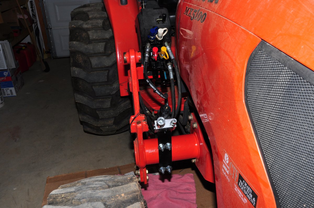

W.R. Long's web site says the most common location for installing the valve is the inside of the starboard FEL post. I guess I'll see if that's the best location when I get the kit laid out. I'd appreciate any hints from other users of this kit on similarly sized Kubota tractors.
I'm also interested to learn where you might have connected the solenoid electrical supply.
I might be consulting the experts here in the hydraulics forum in a week or two. :)

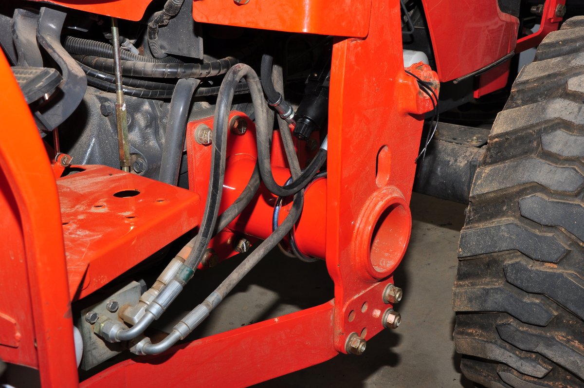

Put one on L3130, real simple, just make sure you torque down all fittings so they do not leak. Went to fuse box and tapped the switched buss and put in a seperate fuse and holder in. When routing wires to switch from solenoid make sure not to get them into pinch points and I added spade terminal connectors to solenoid wires so if you wanted you could reverse switch logic for your own preference, dressed, sleaved and tied all wires up and works good.

I installed one (WR Long) on my L3400... It fit perfectly, from plumbing to electrical to the mounting of the valve itself... felt like it was made for my tractor, and was $400 less than the Kubota kit.

The Valve is mounted with u-bolts in front of your right foot on the horizontal bar that is part of your loader frame. This kit is one of the easier ones to install. If you have any questions you are welcome to call.
