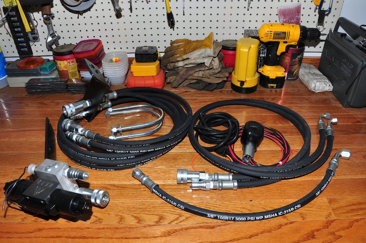

Nelson, can I ask you a few questions?
I'm installing a W.R. Long 3rd function valve kit on a Kubota MX5100 with LA844 loader.
The first shot shows the kit (obviously). Am I correct to conclude that the coiled hose pair on the right isn't needed since I bought the bulkhead plate assembly (which is the coiled hose pair on the left)?

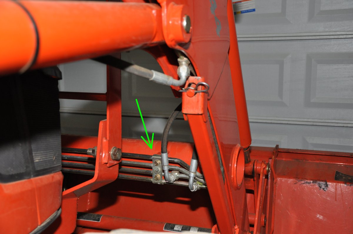

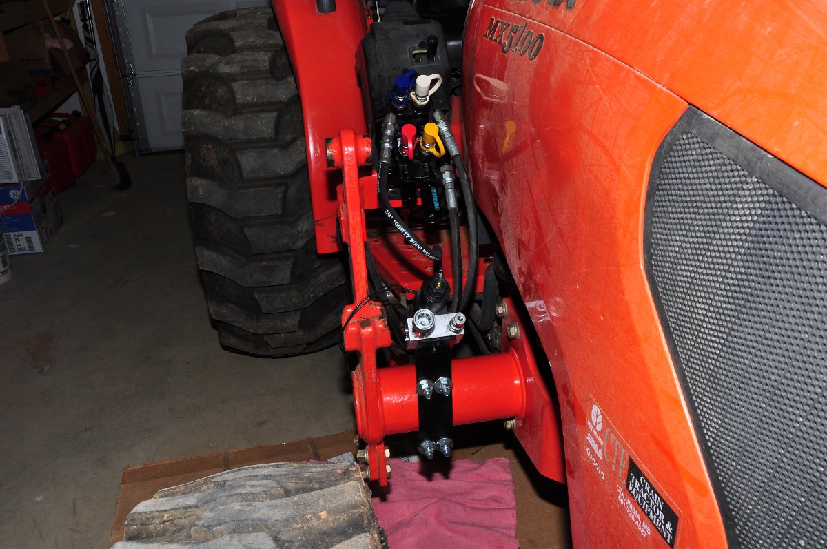

The second shot shows where I placed the 3rd function valve on the FEL spar. I placed it a bit outboard of center to avoid having the attachment hoses chafe on the hood. After thinking about it though, I believe I'm too far outboard and the quick disconnect fitting will be too close to the loader arm when the loader is mounted. Where do you normally position the valve on the spar?

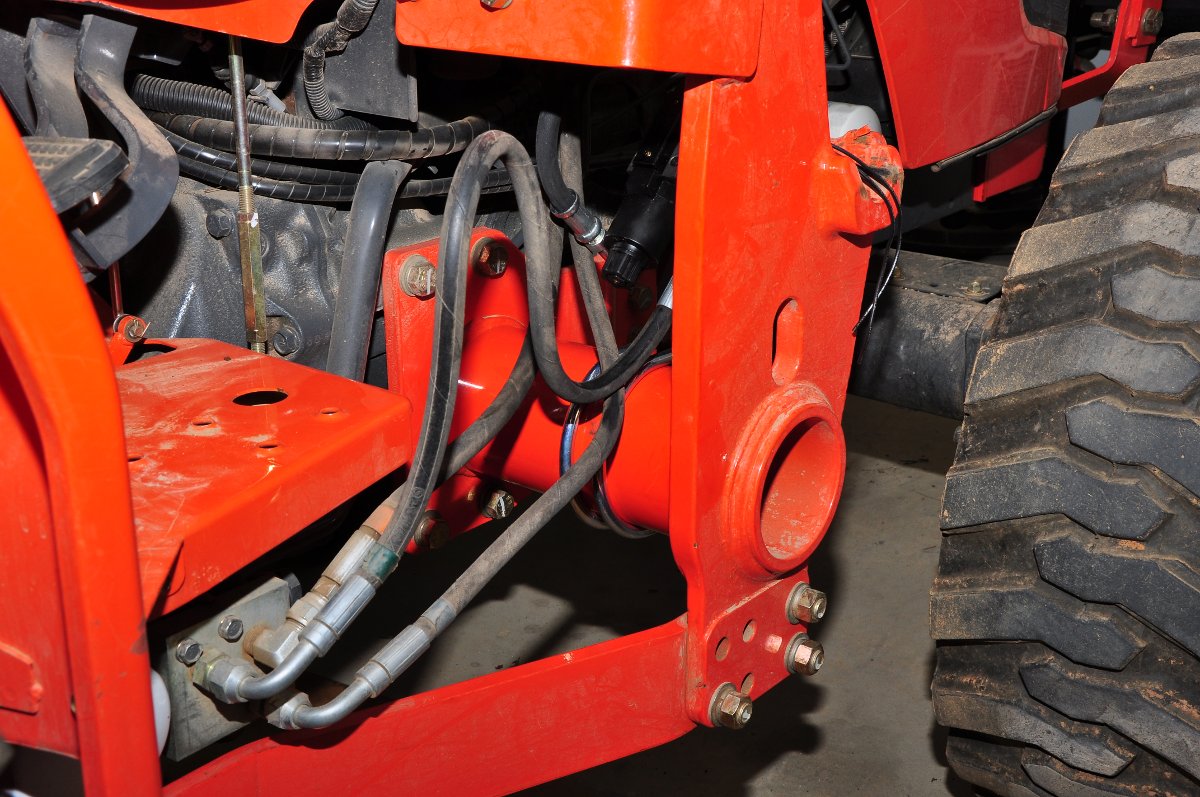

The third shot shows the power beyond hose (with green tape on it) running from the 3rd function valve T port back to the manifold. This is the one that was originally connected to the power beyond port on the FEL valve. As you can see, there's a good bit of extra length now. Is it okay to just leave it with the big curve in it?

Sure,
The hoses on the left connect to our 3rd function valve A and B ports and the other end connect to the back side of the bulk head plate. The hose on the bottom right connects to your power beyond port on your loader valve and our P port. The hoses you are asking about are connected to the front side of the bulk head plate and the other ends to the back of your attachment. As you know we manufacture attachments and valve kits. We decided years ago to include hose in the valve kit all the way to the back of the attachment.
By using the U-Bolts is give you the installer/owner the flexibility to move the valve around. I would get everything put together and the place the valve where you find is the best location and then tighten up the bolts.
No problem with the big curve. I would tuck it below the other hose and in toward the tractor.

Sure,

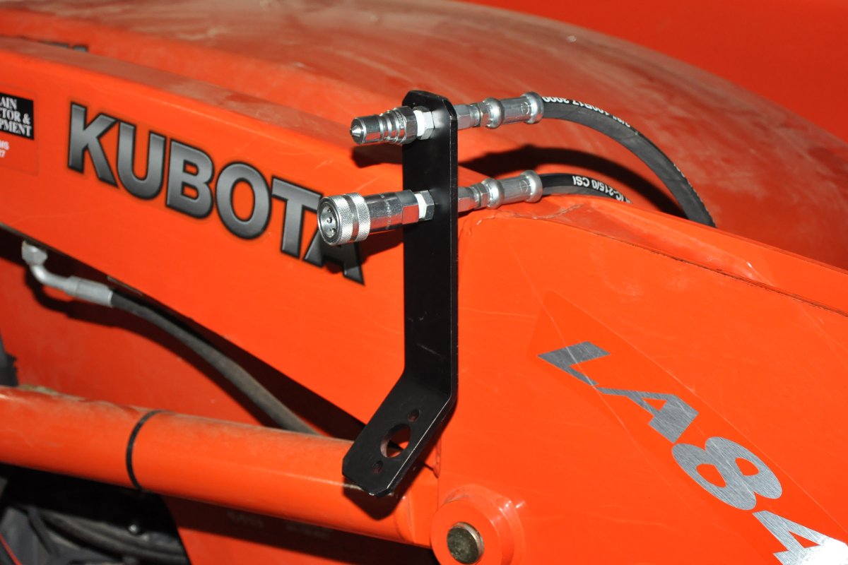

The bulkhead plate is angled (see first photo), but the bracket where I want to attach it is vertical (see second photo).
The holes in the bulkhead plate line up perfectly with the bracket, but if I install the angled bulkhead plate onto this bracket, the quick disconnect fittings will point toward the ground instead of straight ahead.
I suppose I could mount it with the couplers on the bottom, which case they'd point upward. Nelson, your recommendation?

Can you bend the bracket straight?
I don't have a torch, but I suppose I could take it to a shop and have it done. I'd rather not, though, just because it's brand new and for my hard-earned money I'd like to have the correct piece out of the box. :)
I'm hoping Nelson will swoop in with sage guidance. I have a feeling he's going to tell me the correct orientation is the couplings coming off the bottom of the torque tube, pointing upward.

I called W.R. Long today. The angled bulkhead plate is appropriate for my LA844 loader and should be mounted upright; the couplings are intended to point downward.
