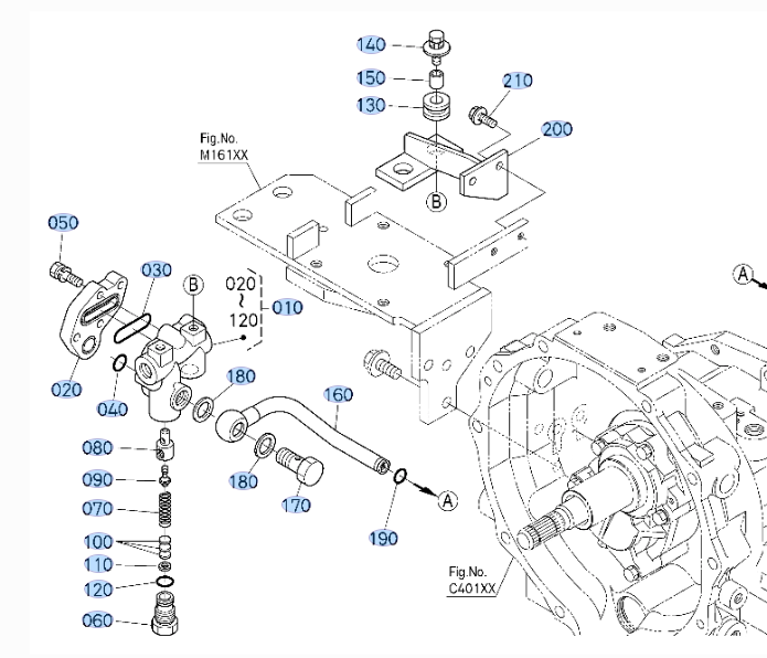

On most tractors, and I believe this one too, the steering pump is what feeds the HST.
Also, on this tractor, it uses a tandem pump. One section for the loader, remotes and 3 pt and the second, smaller section for the steering, HST and PTO valve on some tractors.
At first, I thought it stripped the splines on the pump input shaft but since it's a tandem pump and you still have HST and steering (I assume), this is not the case as the same driveshaft drives both sections of the pump.
After the bigger pump, it goes to an hydraulic block that then feeds the loader valve. On this block, the only thing that could possibly go wrong is the relief valve. Maybe some trash managed its way through and the relief valve got stuck open.
This would be my first go to component to investigate as it would cause the loss of loader, remotes and 3 pt.
Here is a parts view of the hydraulic block. Part #80 is what I suspect is stuck open. Or, although very unlikely, the spring #70 broke.
My thoughts exactly , in a system like this check the relief valve first then possibly the detents.
