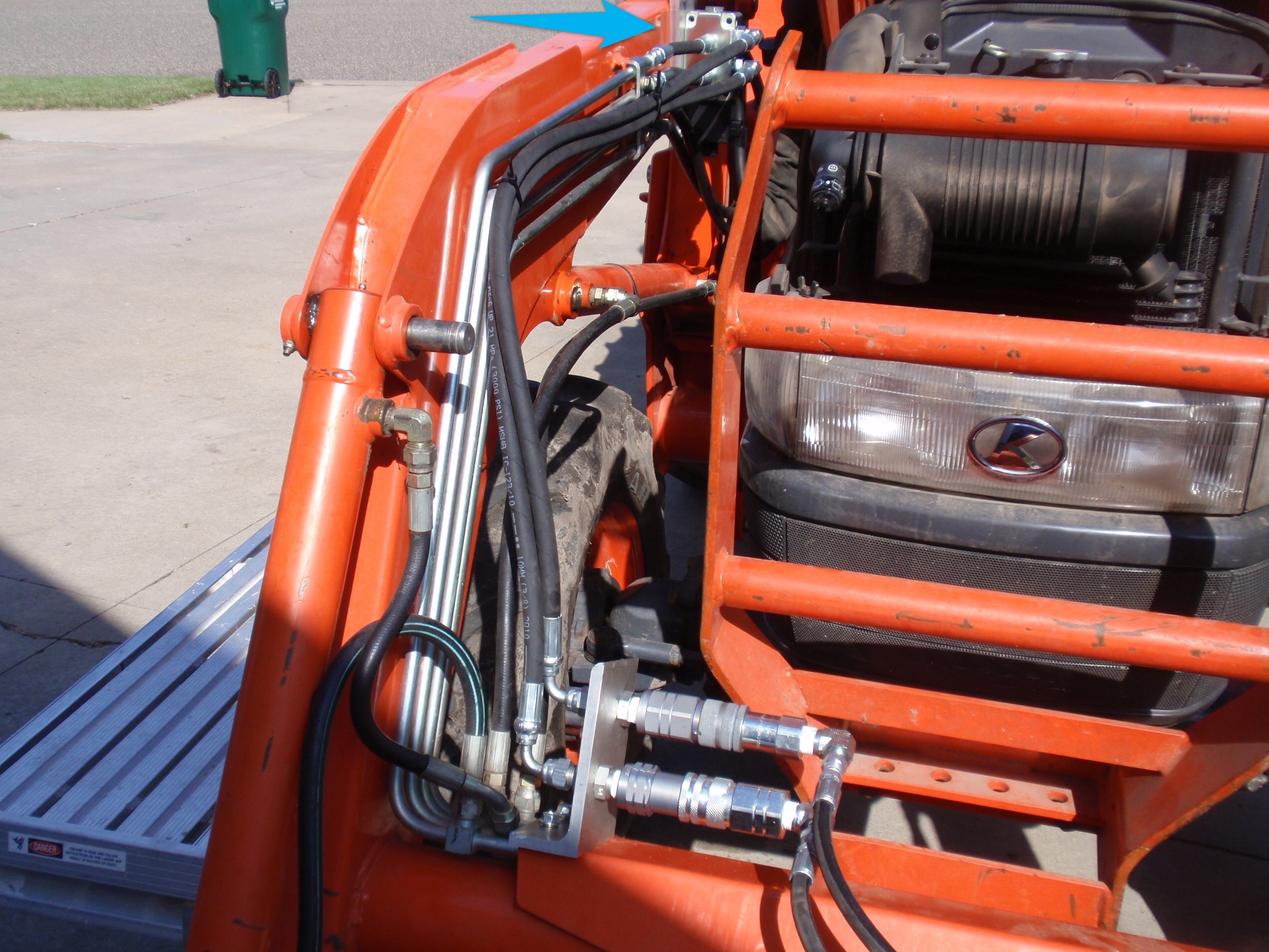

Why do you think a diverter is bad? I put one on my 3130 originally and now on the newer 5240. I tapped into the curl/dump circuit and use a momentary switch to change modes from curl to grapple lid. Easy peasy. I attached it to the loader arm (see arrow at top). And yes hydraulics are very expensive for what they are.

I have to agree I have no idea why anyone would want full on or off, I use a diverter setup, my tractor can barely run 2 ports at the same time anyway. I can almost hold a egg since i can feather so well
