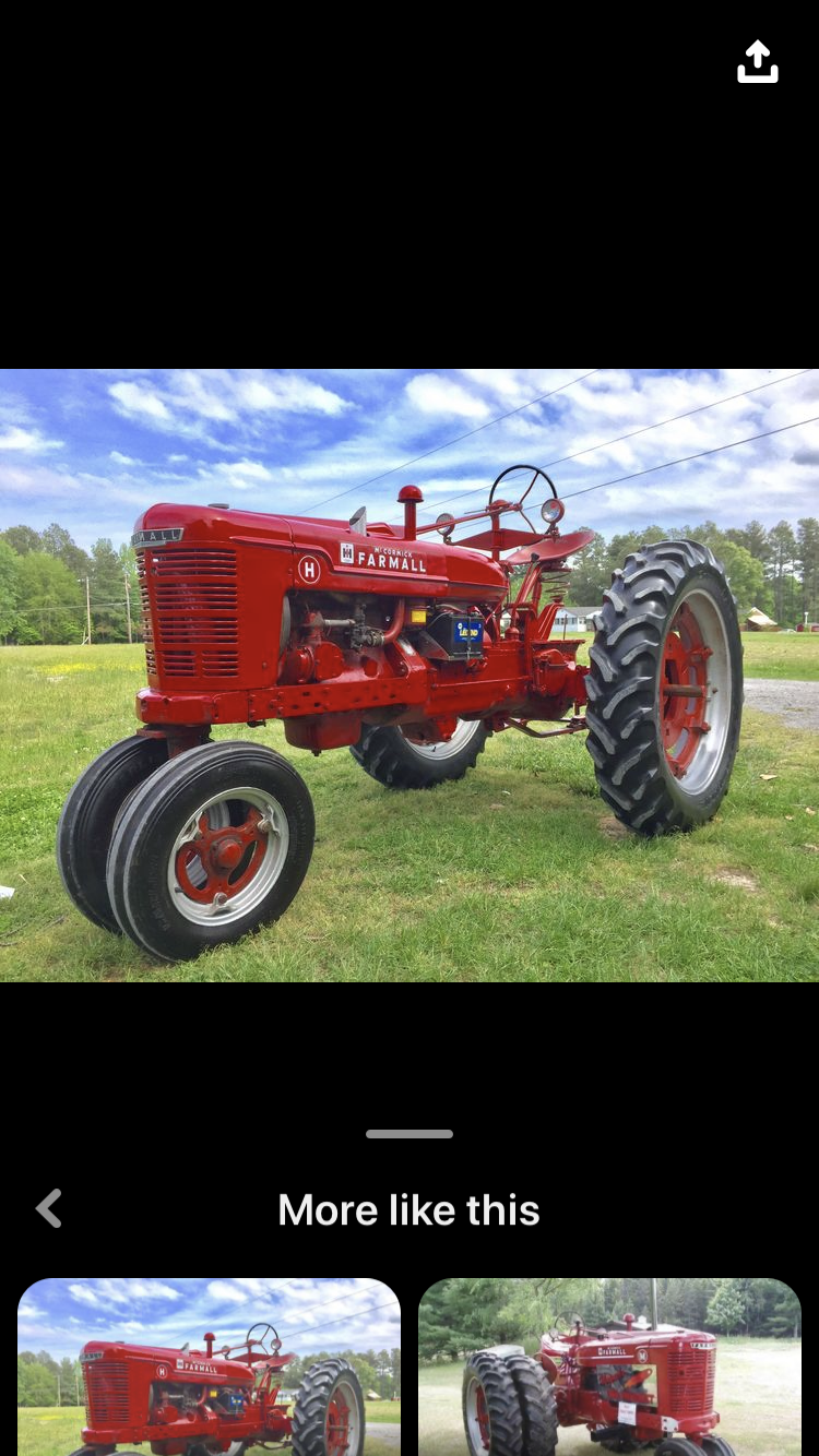

A farmall H with a tricycle front end comes to mind.
But headroom going through a 8 ft garage door could come with an unexpected surprise!
