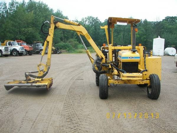

I don't know the proper name but what are those articulated bush hog things that are on a boom. I see the farmers using them to clear branches from trees around the perimeter of farm fields and dept of highways cutting grass/brush in ditches. They are hydraulic. They have no problem cutting branches. How do they cut.
/ Vertical bush hog idea #5
All those I've seen around here used for cutting branches are flail mowers.
Bruce
PS: I see that Bush Hog has a rotary head available for their boom mower. Says it is for grass and brush. I wonder how it would work in the vertical position.

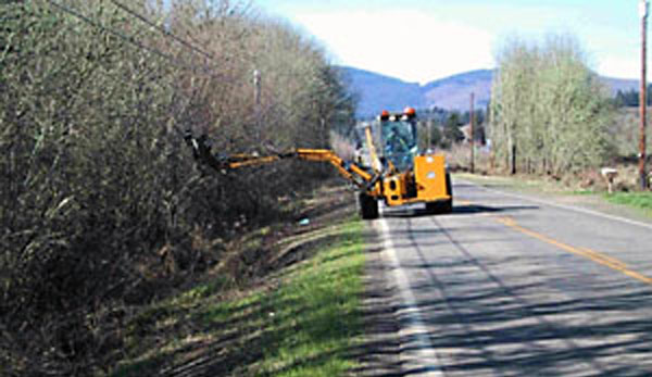

/ Vertical bush hog idea #6
Rotary boom mower is what they use around here.. really tears up the trees :)
