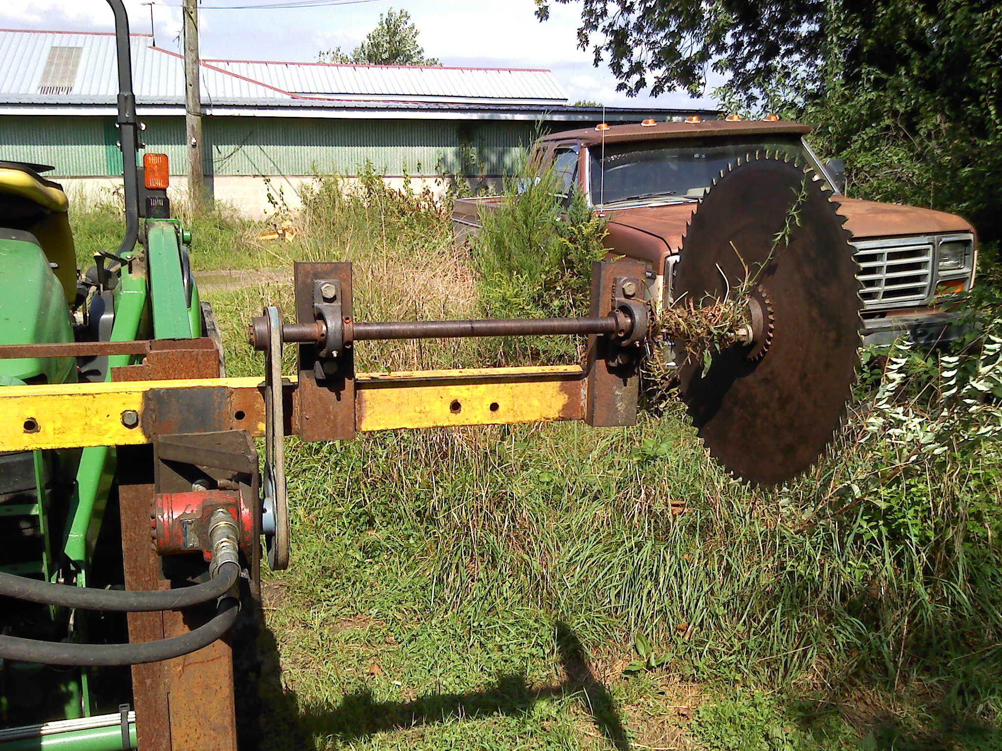

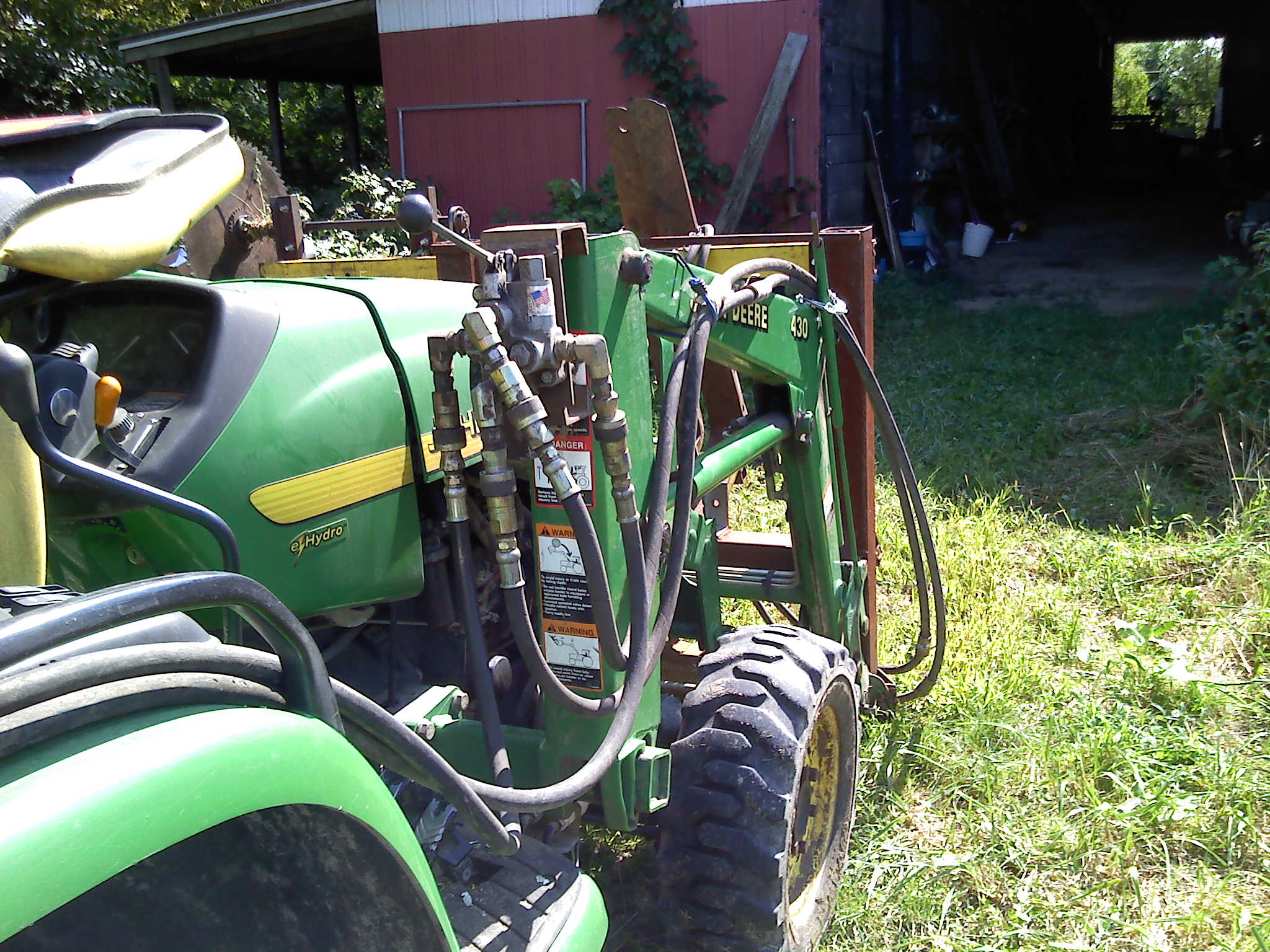

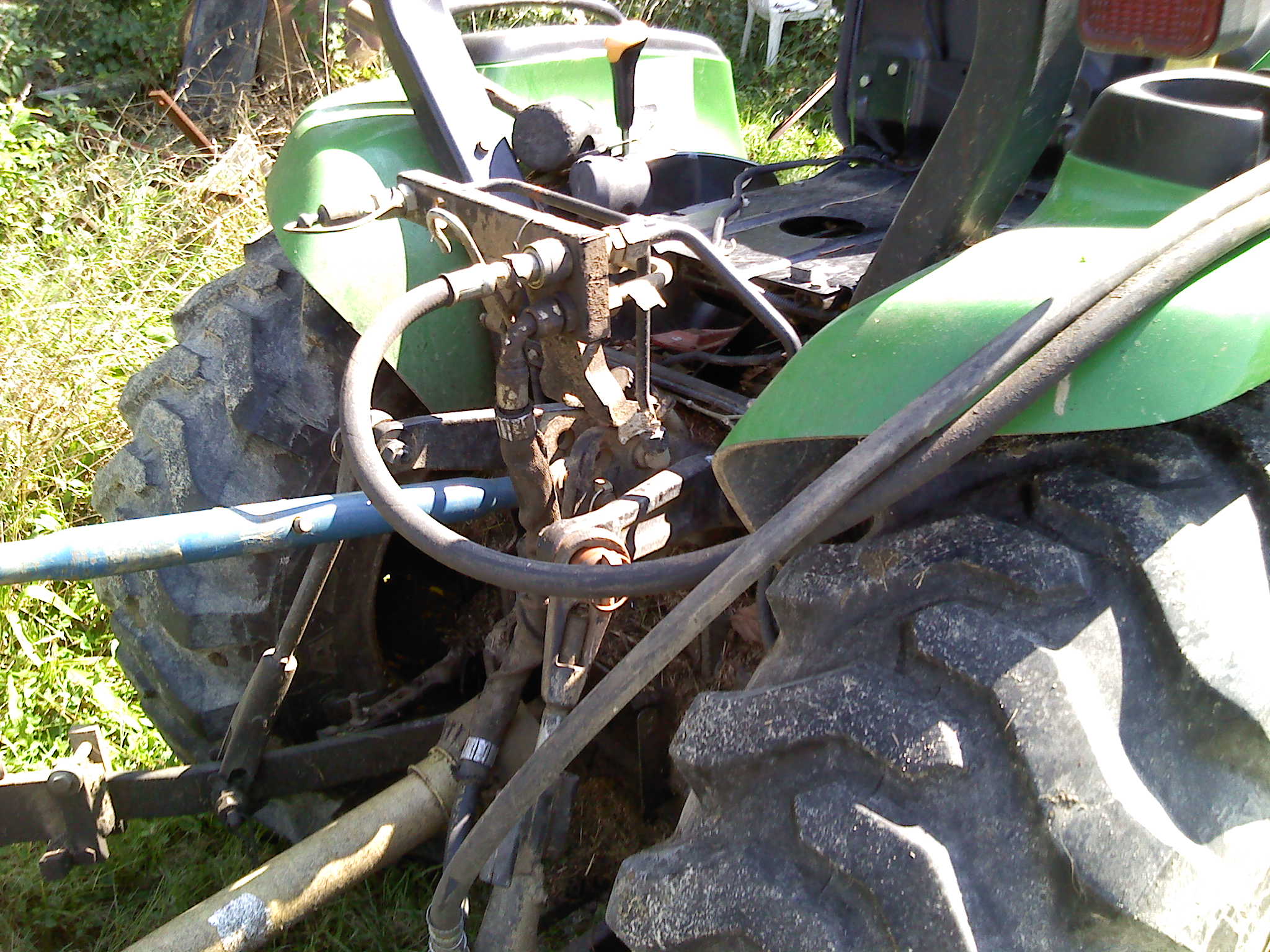

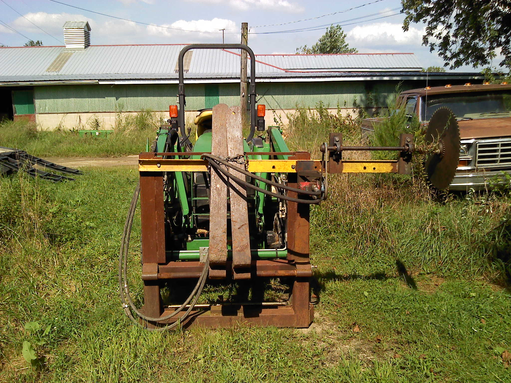

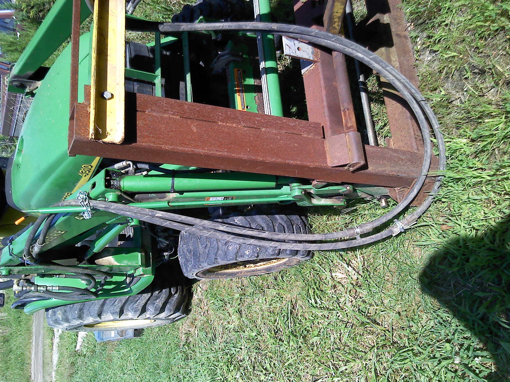

Looks good!
   / Vertical bush hog idea #23
works well if you don't rush it
it can cut limbs of several inches
   / Vertical bush hog idea #24

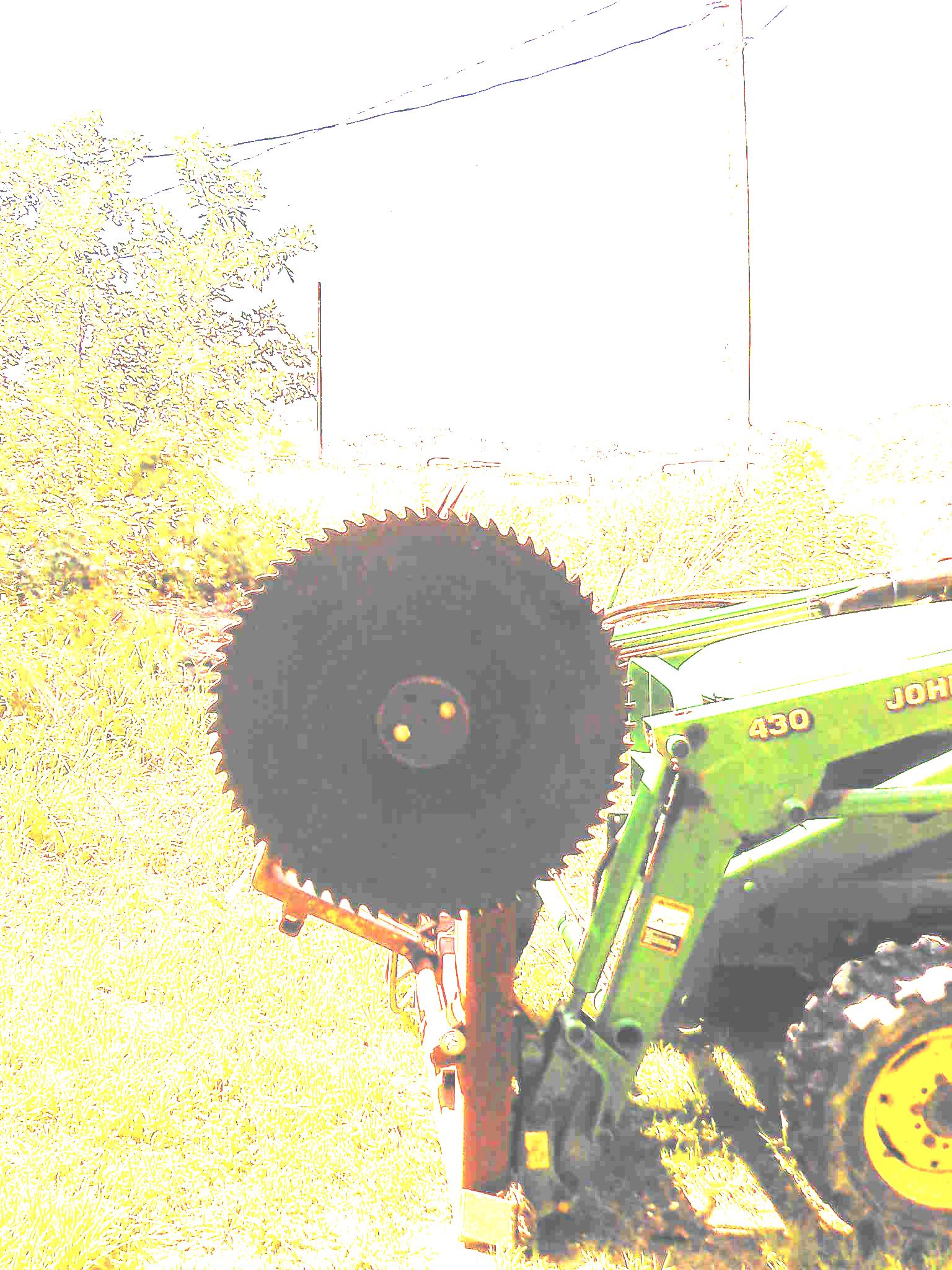

I love it. I have been thinking of doing the exact same thing for a long time. Is there anything you would do different next time? What is the specifications on your motor? I thought about making the shaft extend to the other side and putting another blade on the other side too. I either want to do this or mount a bush hog on the front.
   / Vertical bush hog idea #25
the motor was laying around when i got the farm and is used on another device or i would have it connected to the shaft directly through a coupler, which would improve performance.
the blade i bought used for less than $15, hoses were expensive and i think i could have used a smaller diameter
why would you want a blade on each side? i think that would introduce more problems than it would solve.
it could be made to mount on either side.
i originally made so that 2 other beams would mount to the fork frame at the saw beam was mounted to them and cut horizontally and close to the ground but that wound up not being practical.
this is simple and i can cut up to 12-15 feet off the ground and close to the ground
it will cut 4" to 5" limbs but you have to experiment to do it right.
if i had it to over i would use 2x4 box steel and mount the motor and shaft inline using a flex coupling with the rubber insert.
with a couple pieces of angle you could mount it to a bucket
the hub is a chain sprocket with 2 matching holes with the ones i drilled in the saw blade and a round piece of steel on the outside
i've used it for several years with no problems.
just be careful of flying bits of wood, i doubt if osha would approve it.

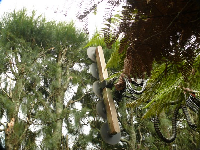

I also though about putting two or three blades on the same side like this.

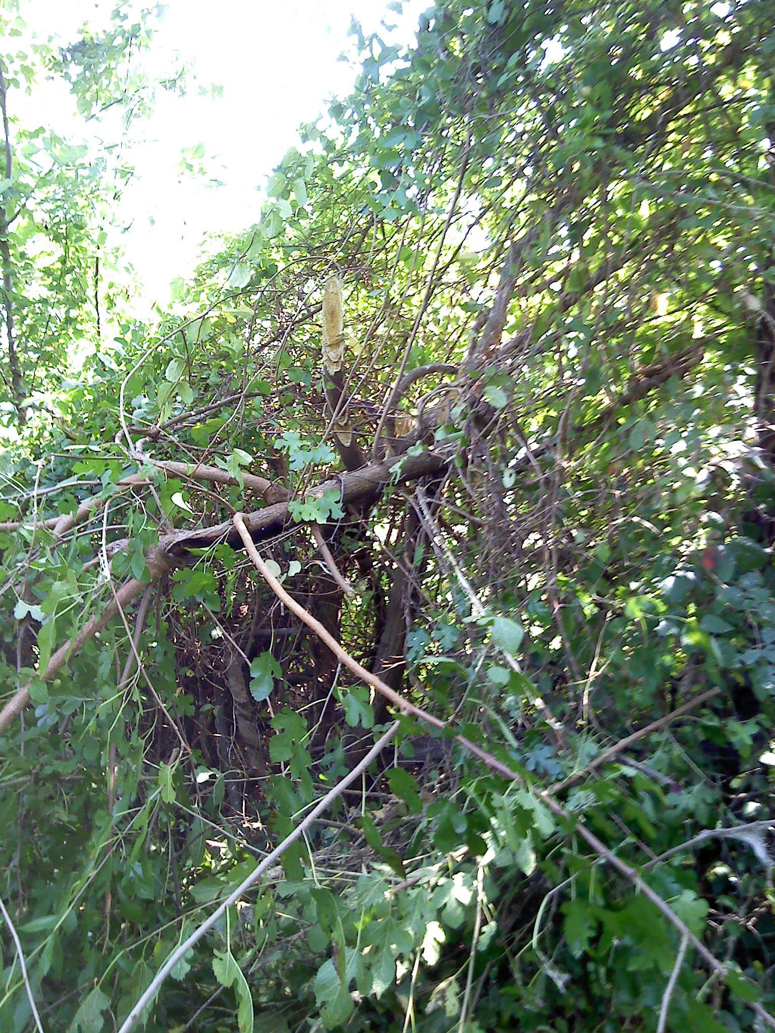

in use

won't work. Nothing to hold the brush from getting pulled with the blades. On the ground, the roots holds the brush.
Highway Department uses a articulating arm with a brushhog setup on the end to cut embankments and small trees. Doesn't look like they have a problem.
   / Vertical bush hog idea #33
Are they cutting close to the ground? Or high up off the ground?
