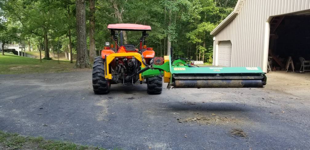

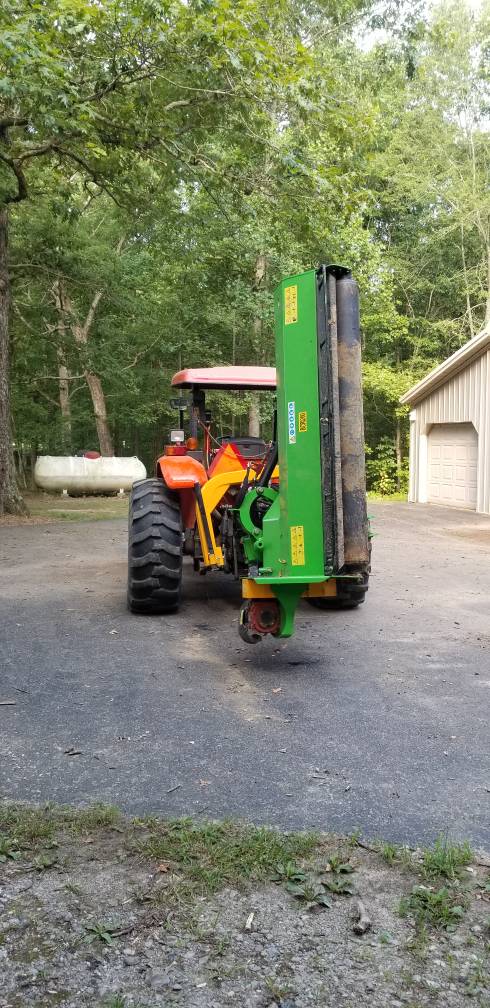

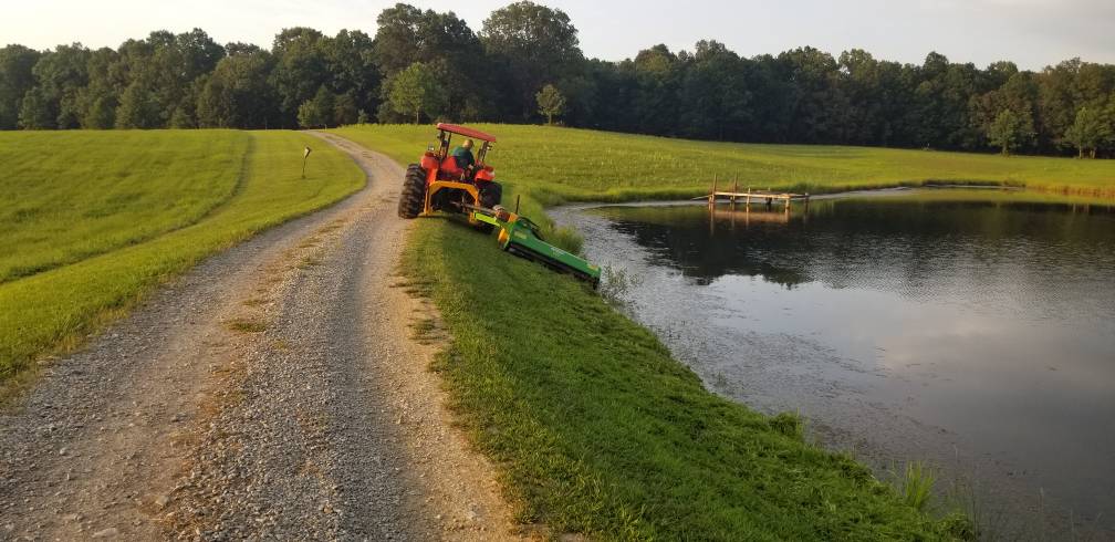

Finally got mower back on tractor and did some mowing. SO as I mentioned, I would take some pictures. 20190803_085113.jpg20190803_085028.jpg20190803_191511.jpg20190803_193923.jpg20190803_193734.jpg
