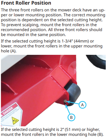

Can the Ventrac finish decks be pitched? I read the setup manuals and there is no mention of it. Not required?

/ Ventrac finish deck pitch? #4
Assuming that you're referring to pitch front-to-back vs side-to-side, you have some control via the positioning of the front rollers.
Nope. Pitching the deck lower at the front than the rear is how they cut best. Watch a video on setting up a zero turn deck.
The rollers are only used to prevent scalping.
