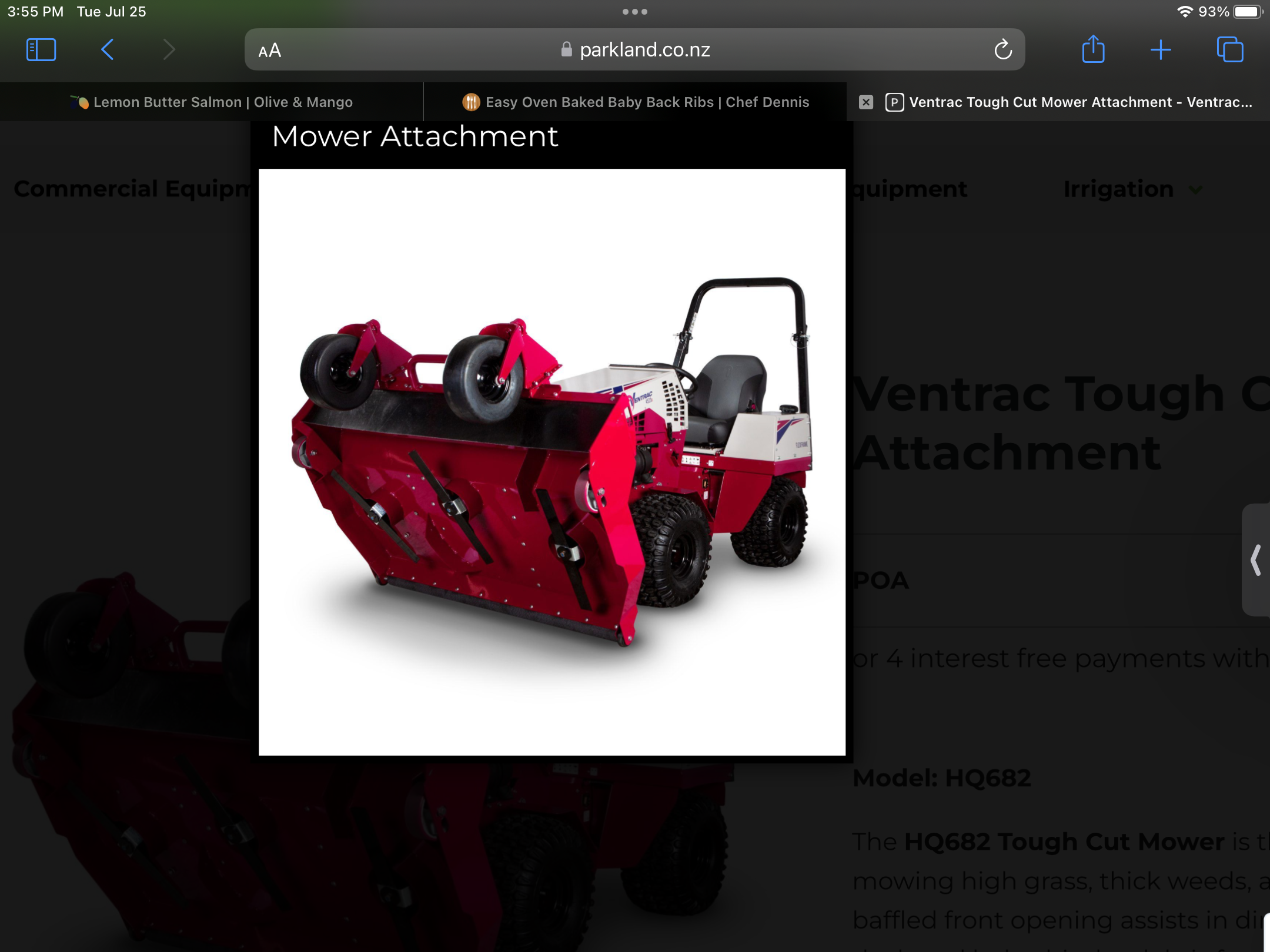

here is the free swinging blades most rough mowers have. (in the mini version) These blades have a step down to them which allow them to strike objects and minimizes the blade damage.
