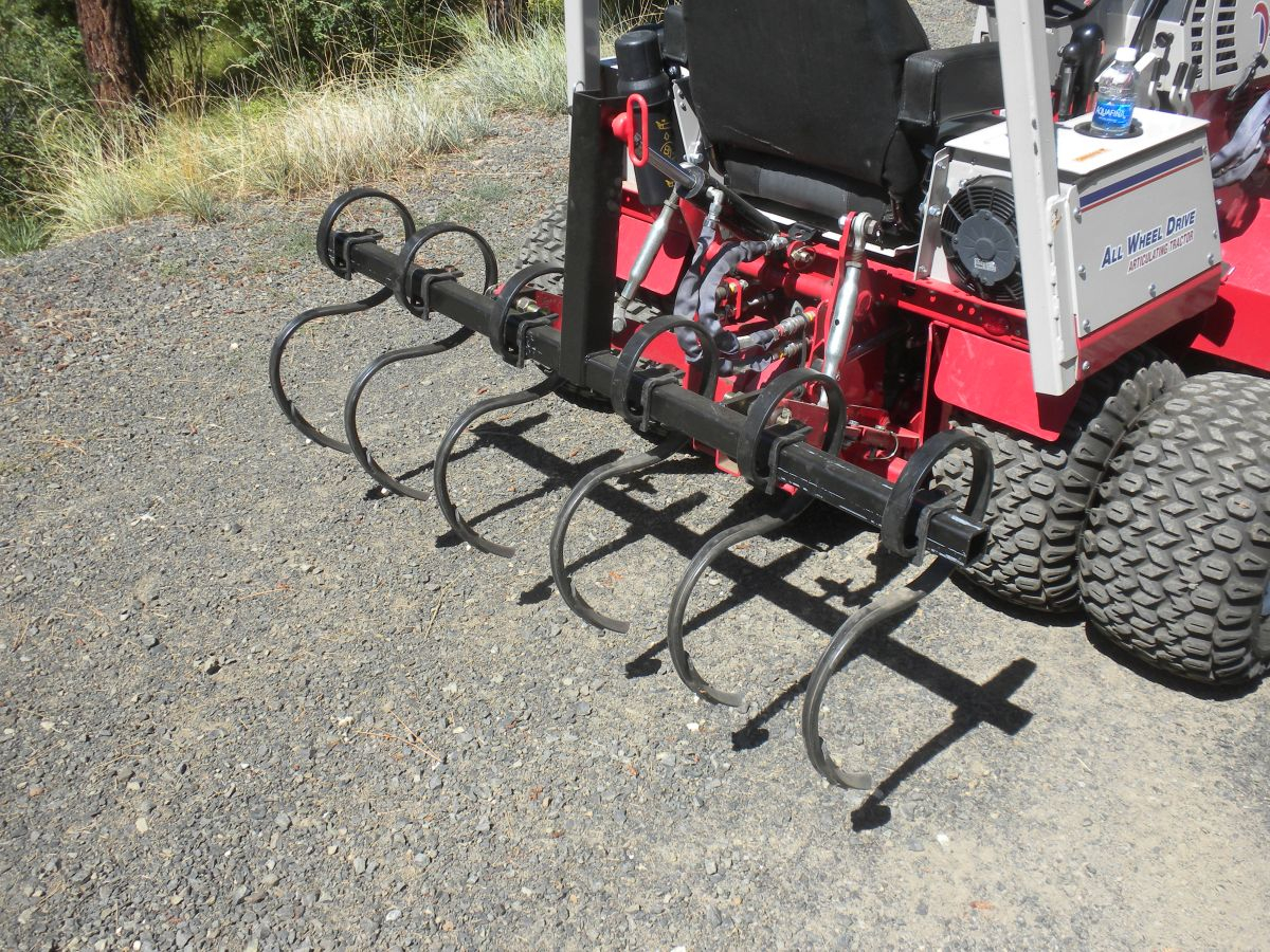

I keep a Norwood "log hog" on it most of the time for skidding logs. I also use a cultivator and rake that were originally designed for Kolpin's ATV 3 point hitch. The cultivator works great for loosening things up for seeding. I use the rake reversed to cover seed, and in normal position for raking. The Kolpin rake is pretty light compared to most Cat 1 rakes so it can't move a whole lot before it fills up and jumps the pile, but a typical CAT1 rake is heavier than I'd care to drag around on rough terrain.
Occasionally I use the 3n1 adapter back there to bring the bucket or another Ventrac implement along to wherever I'm working. For what I do where I work in the woods I can't imagine not having the 3 point hitch.

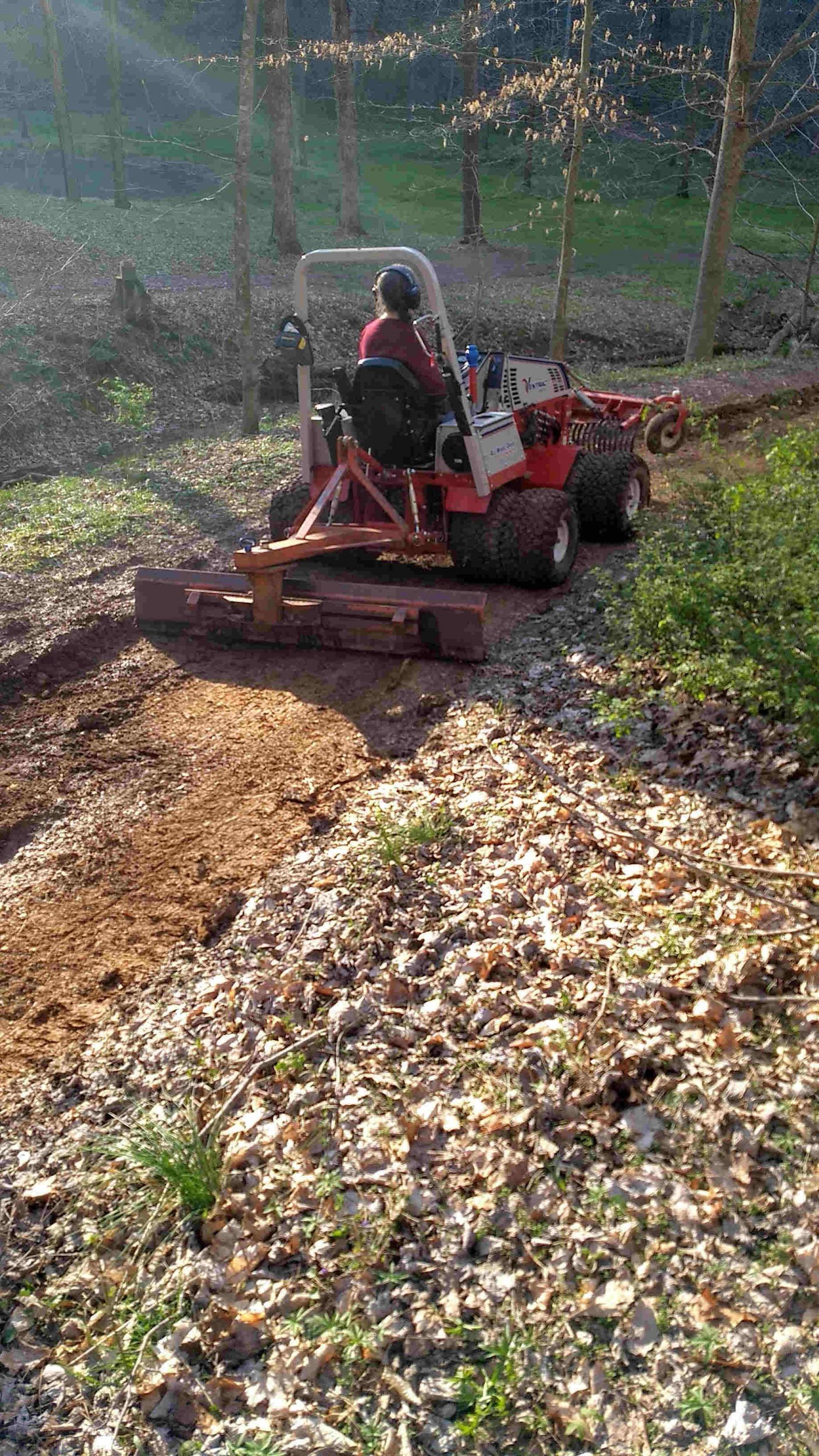

I do okay with this rear scraper blade.
