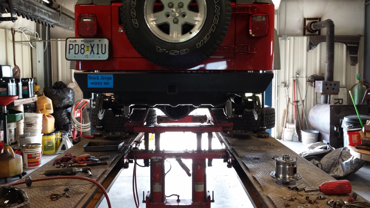

My 4 post has two air jacks. The hoist is plumbed with air. A short air hose plugged into the hoist post allows me to run an air impact, rotate tires, work on brakes, have wheels off with no additional equipment. Additionally I lay the tire/wheel on the hoist rather than dropping it to the ground. Heaviest thing I lift is the impact wrench.
Here's a pic of installing a locker in the rear axle of one of my Jeeps.

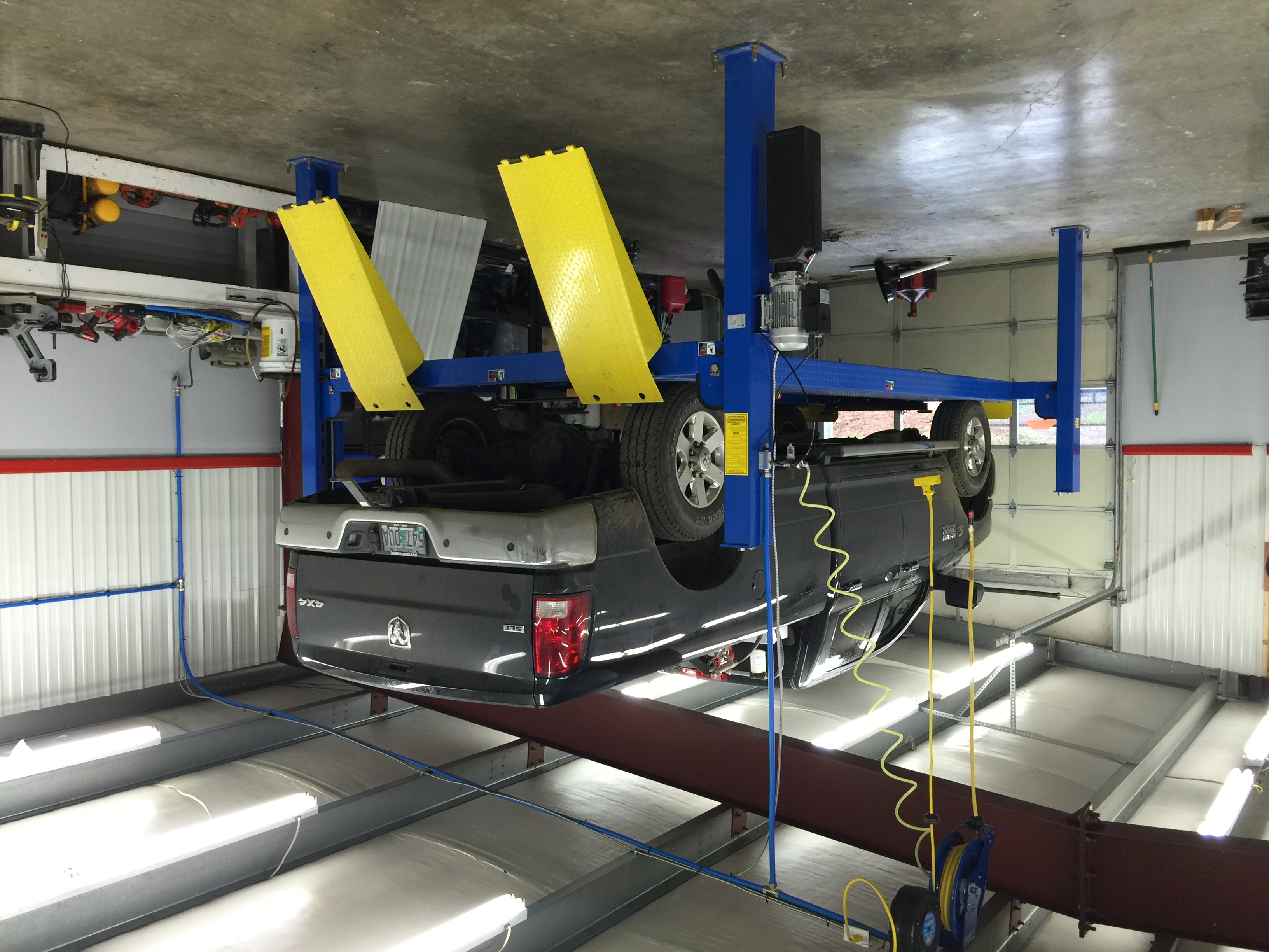

I put a Greg Smith 4 post lift in my home shop a while back. It's rated to hold 14,000lbs. It's been great and I use it on a regular basis. There are times that a 2 post would be nice and I went back and forth when deciding which style to buy. In the end I think this was the correct choice. I've put my tractors on it as well as my small dozer. These would not fit on a 2 post very well. No matter what you get you'll enjoy getting off of the floor!
what is that blue pipe/tubing that appears to be a air line ? I need to run some air line myself
Yep, that is 3/4 Rapidair. Super easy to install and so far I haven’t had any issues.
