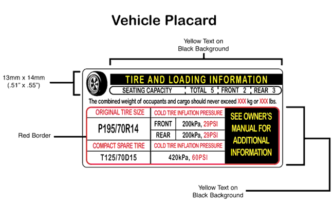

As of Sept 2003, all new vehicles under 10,000 lb GVWR are required to have a payload label that states the maximum allowable payload. If you subtract the payload from the GVWR, you will get the approximate curb weight of the vehicle.

I had thought that too after I made my original post. It would get you in the ball park and close enough for most purposes.
Q: Did you post the right example label? That is a tire rating label which gives the correct tire size and pressure for the tires on the vehicle. I did not see axle ratings or GVWR on there.
Those numbers are all on the vin tag.
/ Vehicle Curb Weight #9
It says on there "The combined weight of the occupants and cargo should never exceed xxxx kg or xxxx lbs" (just below the tire logo)

The trucks FAWR/RAWR and GVWR are on the trucks certification placard on the drivers side door post. Those never change with factory/owner added equipment.
