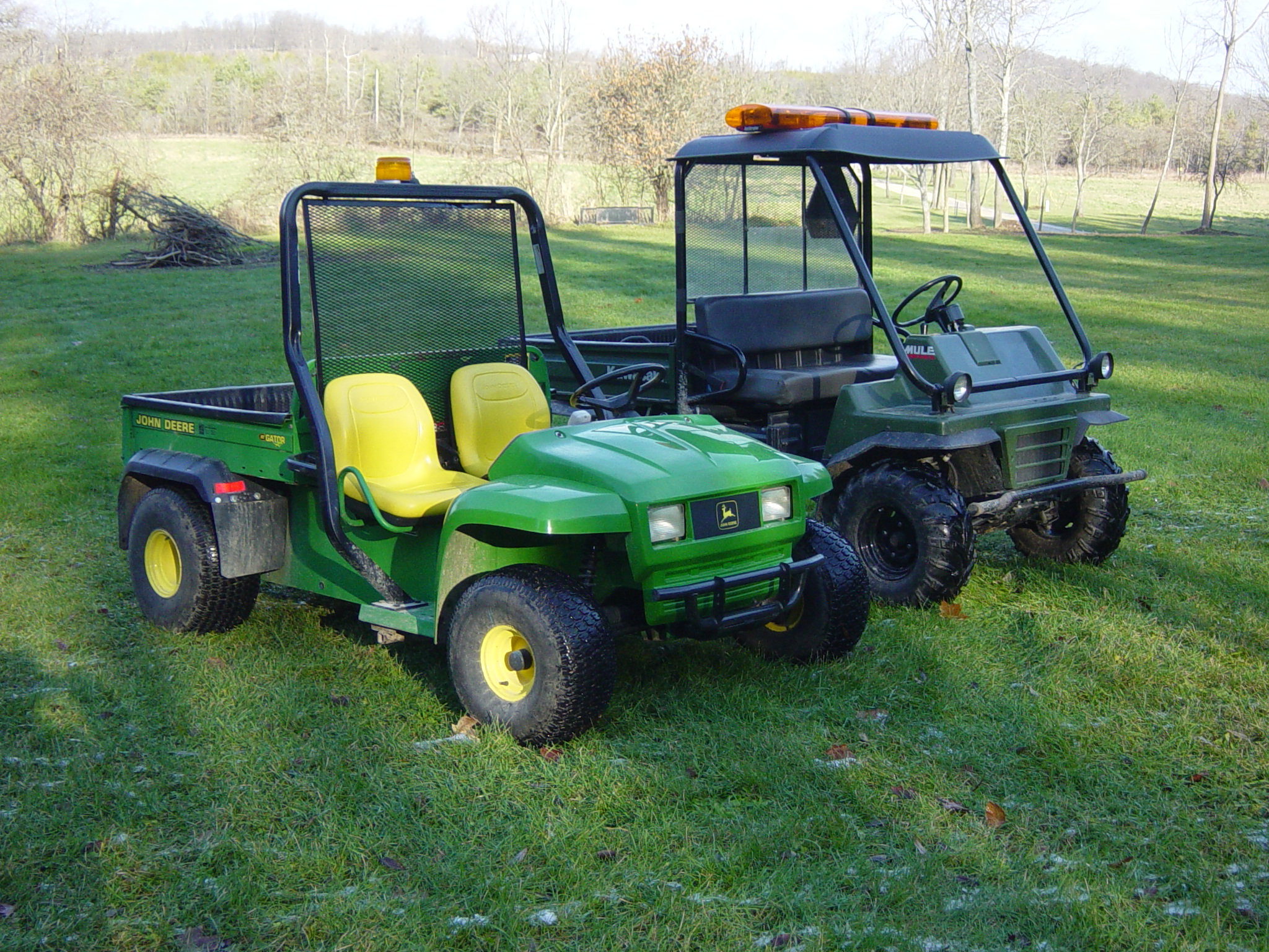

I bought a used E-Gator from a City Parks Dept. Fixed it up nice. It is my most used and probably in the top running for most loved piece of equipment. Despite having a "noisy" diesel mule.
WARNING, though. Parts prices are so high as not to be believed! I bought a wrecked $500.00 CDN, machine for spares. Already, saved me thousands!
Not just quiet, hear birds singing as you drive! But the effortless stop and go operation is what makes it so handy. Do idling, or restarts just to go ahead a few feet. Did I say I love it?
Not fast, poor performance in any mud or snow, and smaller battery option does not allow very long run times. Would be no good for children. Cold weather has a very profound effect on the lead acid batteries for run time. But then, it's pretty much parked all winter. But suits me perfectly if charged every night of a good days use.
I particularly love the simple, utilitarian, no-non-sense appearance. If there was some 4wd, electric vehicle stictly along utilitarian design, that would interest me, but I have not seen one.

One thing to note about the old Legacy Gators. They have no supension in the back relying on the low pressue high floatation tires.
I just put 15 pounds of air in my E-Gator, as suggested by a dealer, and will have to back that down as everything in the bed is airborn when hitting a bump.

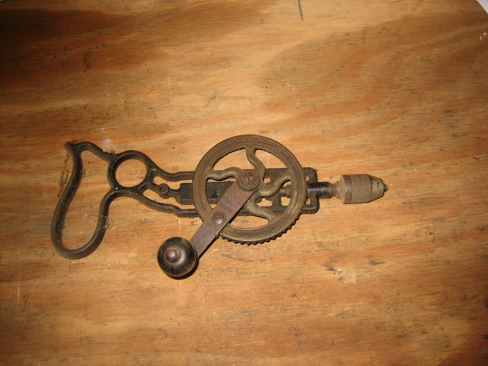

Here is a pic of my first cordless drill still running today.
