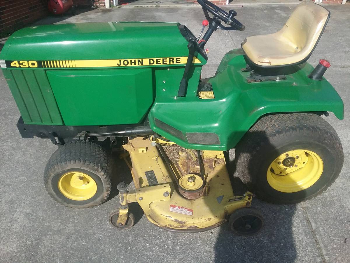

Wondering if a JD 430 With 986 hours would be worth $2,700?
I DO like the diesel aspect of it (love the idea of having one fuel for my International, JCB/backhoe and ???)
No implements, strictly a mowing machine. Is it worth the asking price?

Looks good, I would probably pay $2,400 for it if it runs well and the deck is in good shape.
