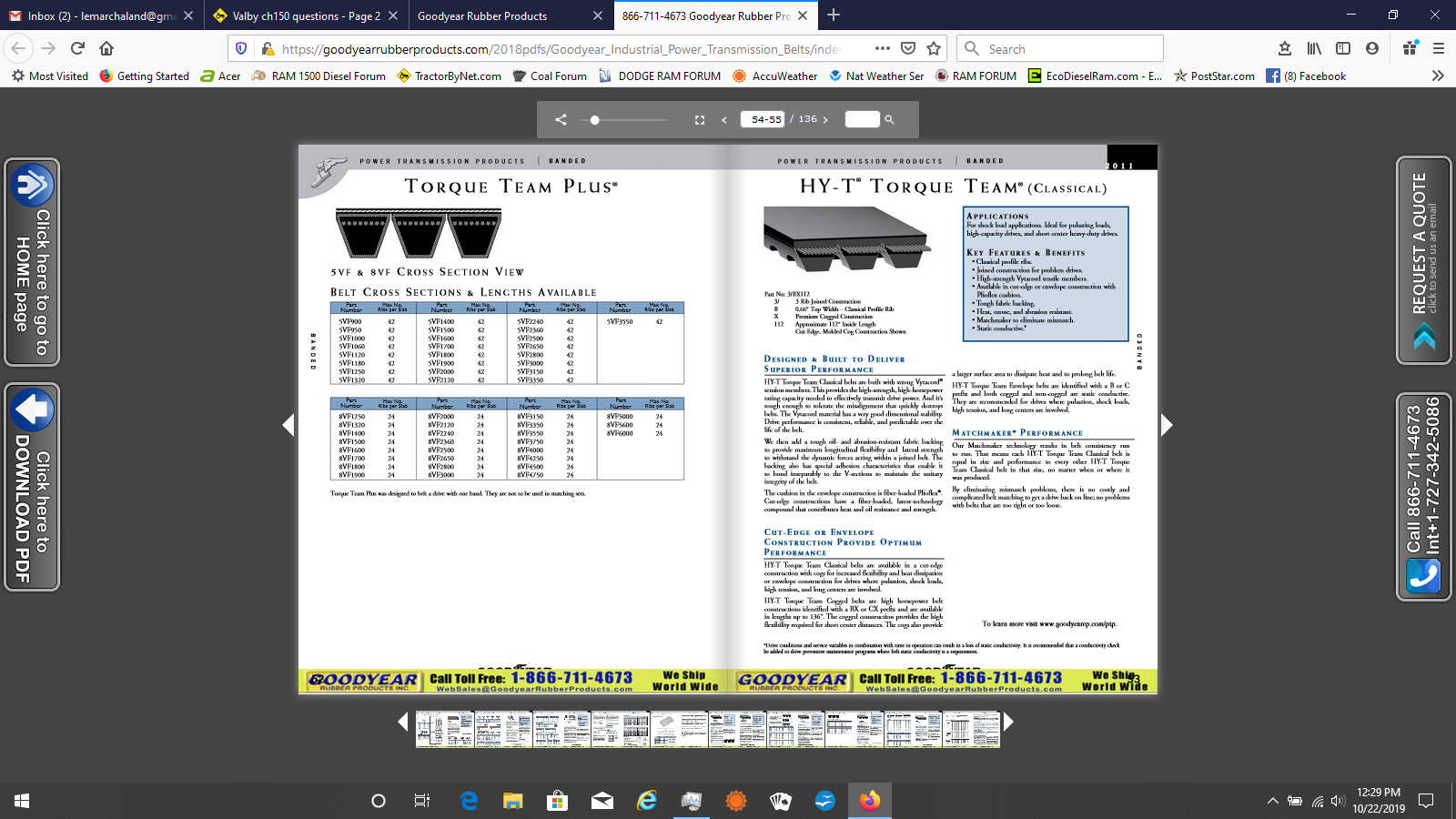

A couple of questions for you on your belts,
when you buy them are you getting matched sets or just the same numbers?
for multiple belt setups they used to all ways recommend matched sets.
are your belts the proper width, they should not touch the bottom of the pulleys,
and should sit just a bit higher then the outside of the pulleys.
Also there are multiple belts in one that can transmitt much more power then multiple single ones,
such as the Goodyear HY-T Torque Team, if this link works it would be on or about page 55;
866-711-4673 Goodyear Rubber Products Goodyear_Industrial_Power_Transmission_Belts

/ Valby ch150 questions #14
OK, thanks. I am getting a few in the pulleys also. I wire brushed and sanded the pulleys as much as I could before the back started giving me problems. I ran it with the 2 stretched and one still kind of good belt with the pto going for about 10 minutes and all seemed well. I then ran a couple of 1" branches through it and that worked but, (as I thought) when I went bigger, the other belts broke and stretched beyond any use. So, my question is do you all use regular belts or do you use the kevlar/ better grade belts? I really want to get an hour or so of chipping with the cheap belts before spending $50 on a set of belts. I have been buying D&D PowerDrive A49 belts. Should my tensioner be this close to the pulleys? Well, I tried to attach a picture but for some reason it isn't letting me. At asny rate the tensioner is pretty much an inch off of the disk pulley.
You need to run Kevlar belts on any type of equipment that has and interrupted cut. The Kevlar bands keep the belt from stretching out and breaking. My 72 inch rear mower belt will last about 2 minutes if it is standard V-belt. A Kevlar belt will last me more than a Summer on the big deck. You should be running matched belts or better yet a banded belt. Basically there is 3 belts all made together with a tough band around the outside to keep them from stretching at all. I have one of these on my stump grinder. Look up banded belts with the size of your belt.

I have not been buying matched sets. I am pretty sure that they are the correct width and depth, they fit in the pulley fine. I did just order 4 kevlar belts (not matched). If they work better then I might go for the banded belt but, I want to get a couple of hours run time on a single set of belts. I did notice that the pulleys are't perfectly lined up so, I will have to move the disk a bit to get them perfect.
Thanks to Jim I learned something new today. I never heard of banded belts. The last time I replaced the belts on my chipper, I obviously bought the same part number belt. This spring, I noticed one belt was a little stretched. It appears banded belts would eliminate that.
