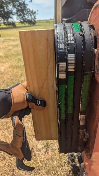

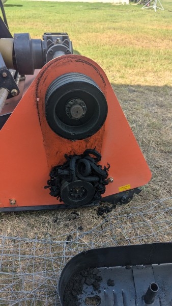

I'm trying to understand what's going wrong here. This flail cutter has been used twice as it's brand new, and both times I've burned the belts. I spoke with the representatives at Betstco on Friday, and their mechanics walked me through a few troubleshooting steps. The first issue identified was that the top pulley was out of alignment (came that way), which I promptly fixed. Fortunately, I had a backup set of belts ($75), so I adjusted the tension and corrected the alignment. After making these adjustments, I went ahead and cut about 10 acres of Coastal Bermuda mixed with Bahia grass. Unfortunately, the belts started smoking again and were nearly destroyed by the time I finished.
I'm at a loss as to what could be causing this issue. Should I consider returning this equipment, or is there something I might be overlooking? I've greased all the specified points, and the gearbox is properly oiled. My Brush Hog rotary cutter handles the same terrain without any issues. I’d appreciate any insights or help y'all can provide. The belts have 1/4" to 1/2" deflection as specified in the manual it came with.

It's not American made. Simple answer. You have an alignment issue, probably the main frame.

Are the belts a 'matched set'?

Far as matched sets of belts are concerned, there is really no matched sets of belts other than measuring various belts and matching them as close as possible to overall length.
No, don't believe it's a matched set. It's just the belts that came with the flail mower from Betstco. I think they're 21" in length.

Does the lower pulley spins freely when there are no belts installed?
Do hummers installed the right way?
To me it looks like excessive resistance, you just need to find out why.

Yes, lower pulley spins freely. The hammers are installed the right way and were installed by Betstco.
/ Brand New - Betstco FH-EFGCH195 Burning Belts #13
so, where does the resistance come from? Can it be you overload it somehow?
Also, what i can see on the picture , but it might be deceiving, the lower pulley groves are narrower. Don't know if it is true or if it is important.
Also, from my old mechanical days i remember that overtightening belts makes them overheat

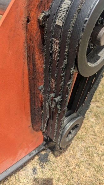

The belts aren't over-tightened. My neighbor, who is an Ag mechanic, and my father-in-law, who was a cotton farmer for over 30 years, both checked the belts after I replaced them. They said the belts were as specified and didn't seem too tight or too loose. We even ran the implement for a bit and rechecked—it was good to go. I'm not sure why they're burning up. They suggested it might be the pulley design, with the belts being too close to each other and generating heat. It's a real puzzle, but it's becoming an expensive one. It doesn't make sense to purchase something that's supposed to cut brush if it can't even handle Bermuda and croton weed in the pasture. Here's another picture you can see how they're all fraying on the edges after an hour of use.

Is the tension the same or close on all the belts? I think the idea of a matched set is that the belts are all the same length within a tight tolerance, so there's not going to be some loose belts and some tight ones.

Those belts sure seem to be riding too high in the pulley, causing the sharp edge to start the belt damaging process.
I'm not an expert, but there's just no way those belts can survive getting pulled into that sharp edge.
That's what several farmers in the area said after seeing the belts. Something isn't right with the pulleys or something... It's not the bearings because everything sounds good and turns. The belts aren't too tight or too lose.
It's the belts that come from Betstco. They come in a set but not sure if it's a matched set. The tension seems the same on all the belts. At $75 for four belts and with them burning up every time I run the mower at some point we're going to have to toss in the towel. I'm already $150 out on belts.
