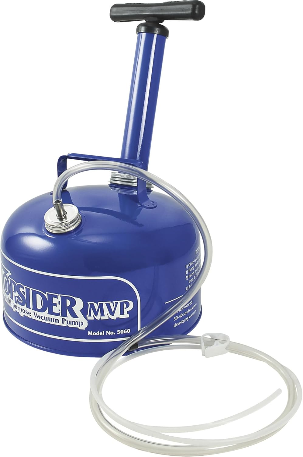

/ Vacuum diesel fluid? #23
I have one of these I use all the time. Attach a length of tubing and you can suction whatever it is out of a container. I also use it to spray liquids of various sorts directly from the container. Shop around...Ebay, etc.

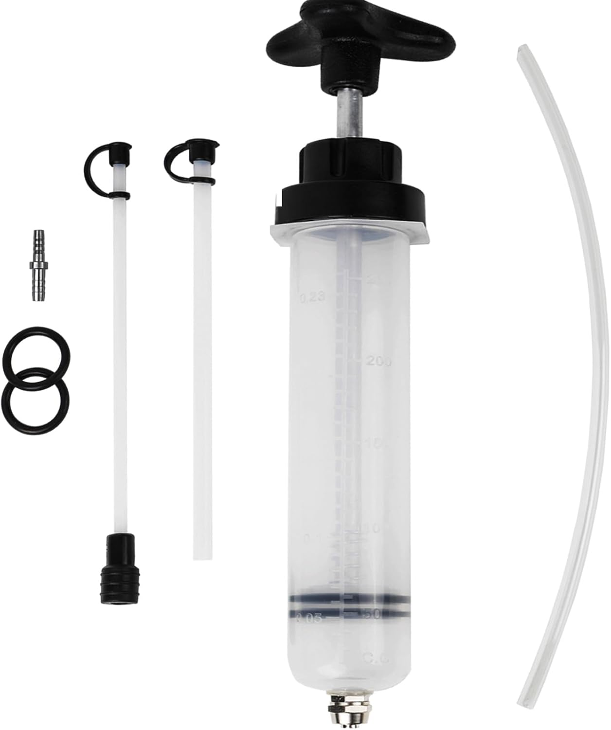

/ Vacuum diesel fluid? #25
Tool shopping time. Harbor Freight model

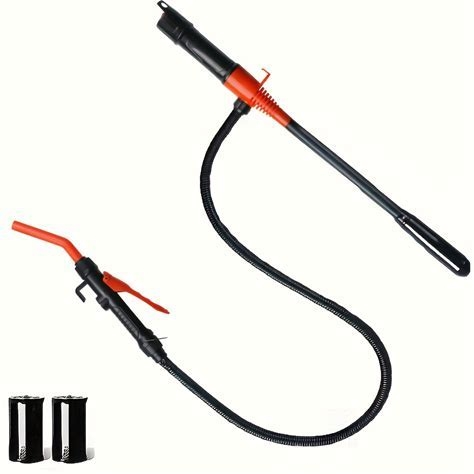

Interesting thread. I run fuel polishing units on ALL my diesel powered units with 10 micron Racor filters in each one and I run Power Service Bio-Kleen additive in my fuel and I never get any crud in the fuel tanks. If I did, my fuel tanks all have bottom drains on them.
The guy in the boat video is headed for issues as the algae he 'sucked out' will continue to grow without adding a biocide. The post depicting the battery powered pump, you can buy them at Harbor Freight everyday for around 100 bucks, less than 10 on sale. I keep a couple on hand in as much as they fail after a while. They suck everything, including gas and diesel.

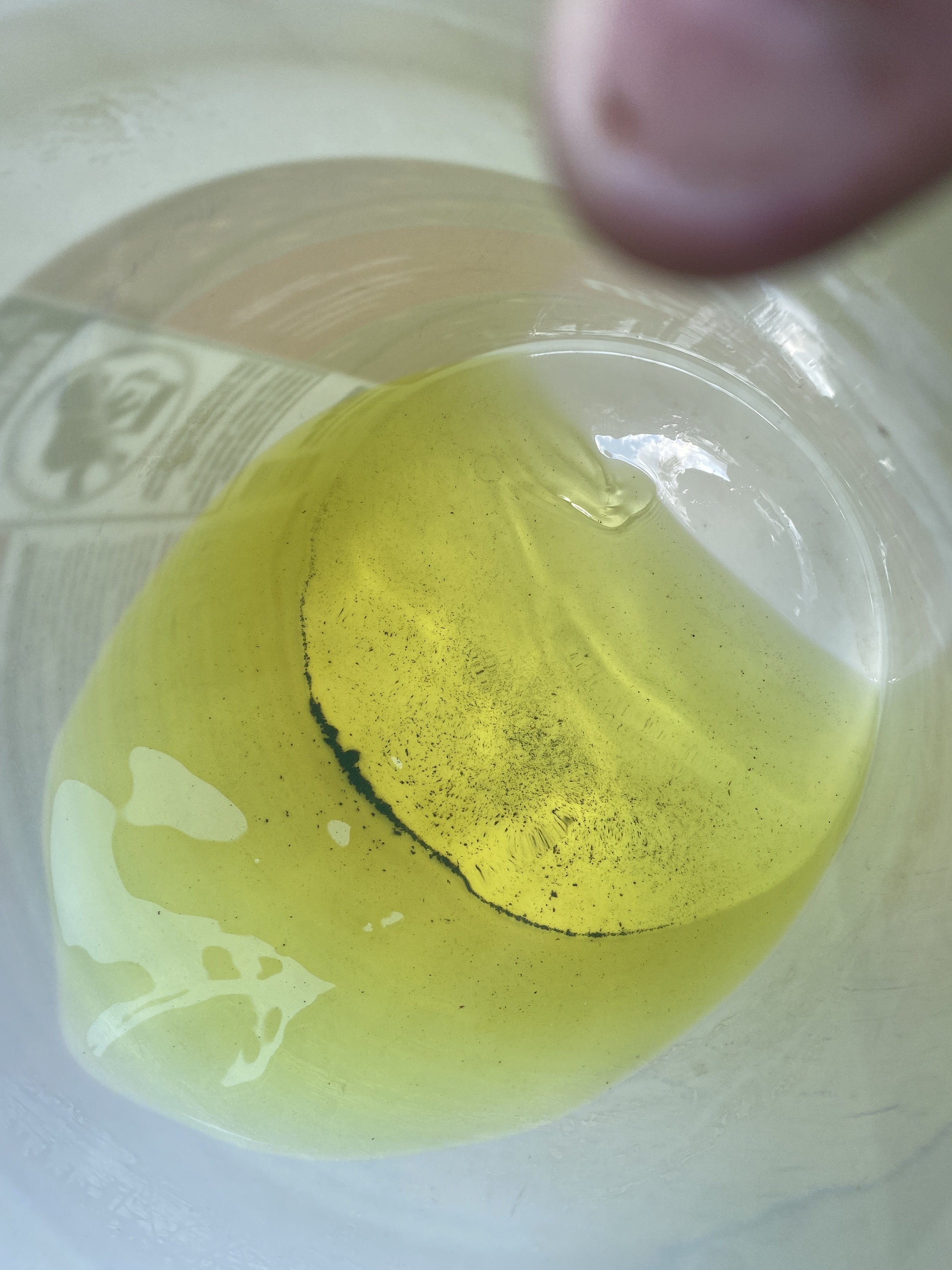

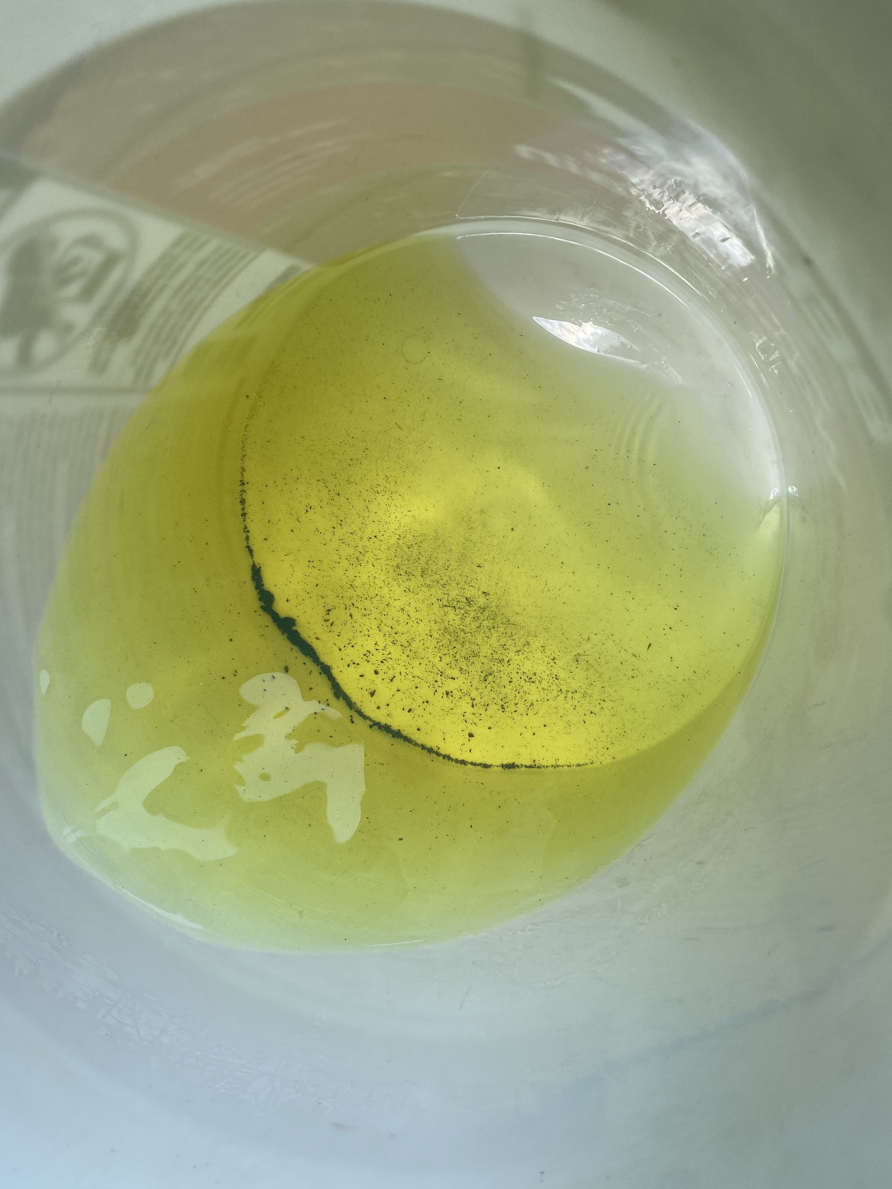

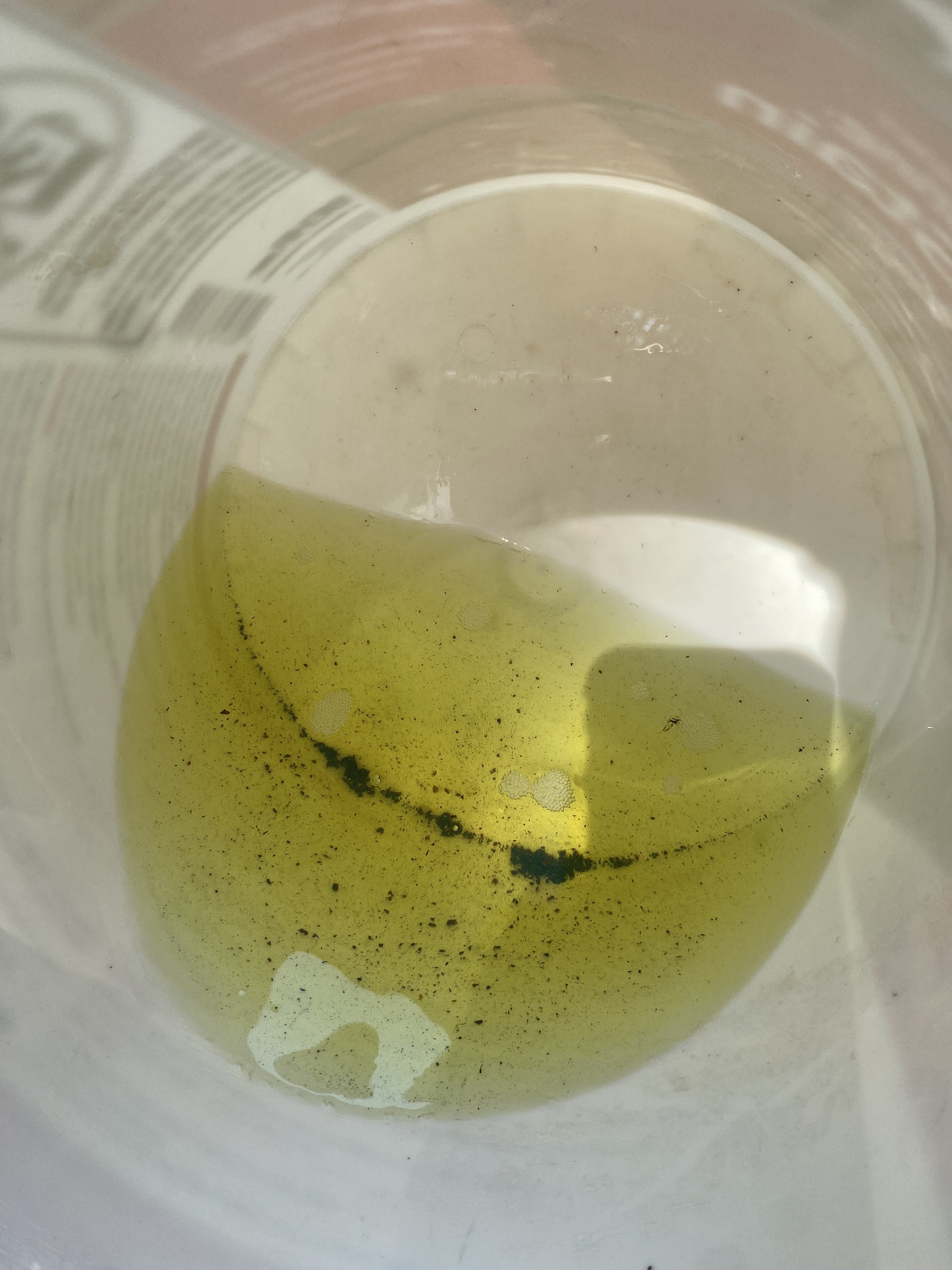

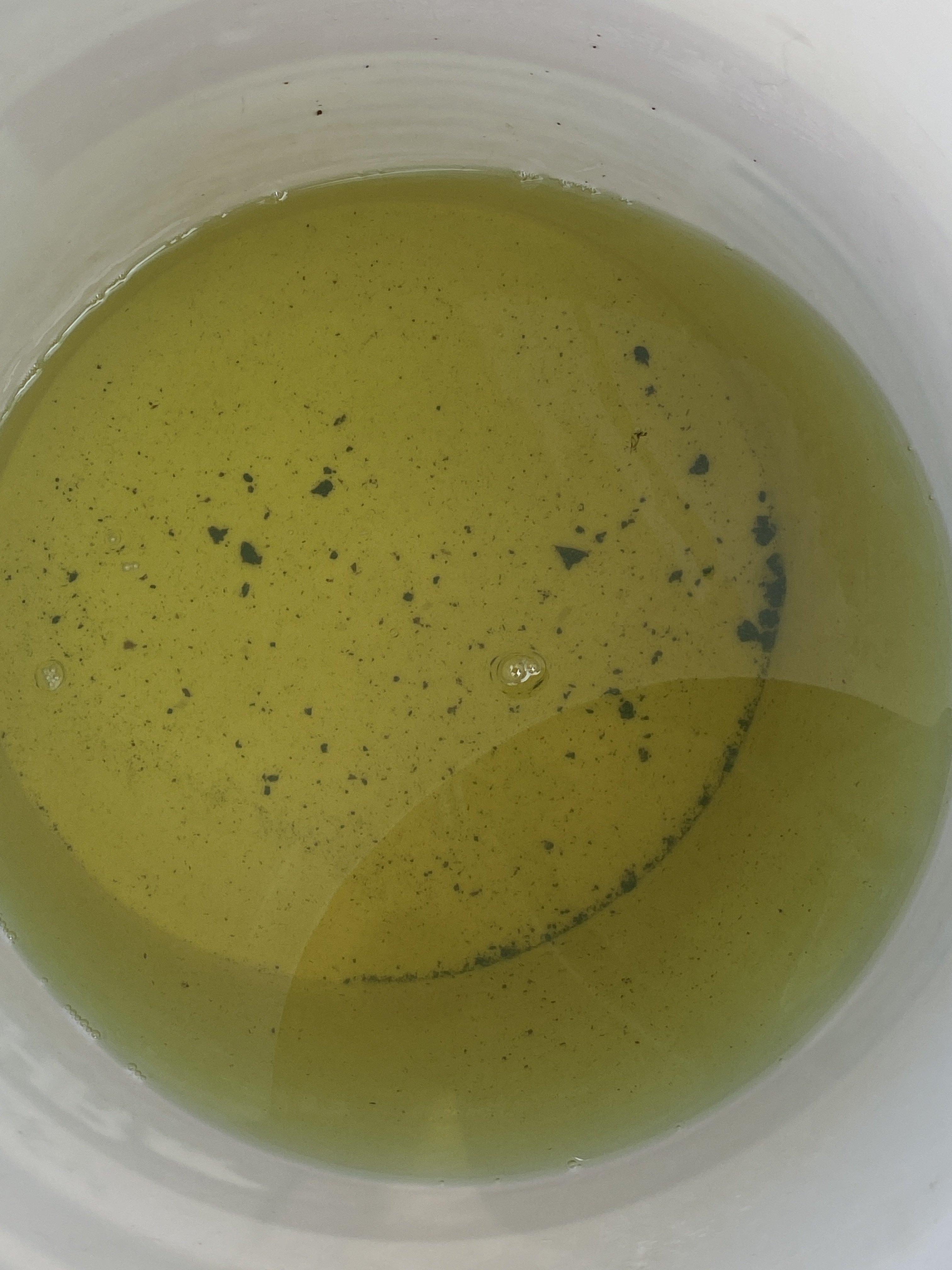

So an update to this:
I finally got around to messing with this, bought a self priming diesel fluid transfer pump kit from amazon for about 80 bucks. Got a bunch of stuff out of the tank, the setup worked perfect. See pictures below. I found no water by the way.
