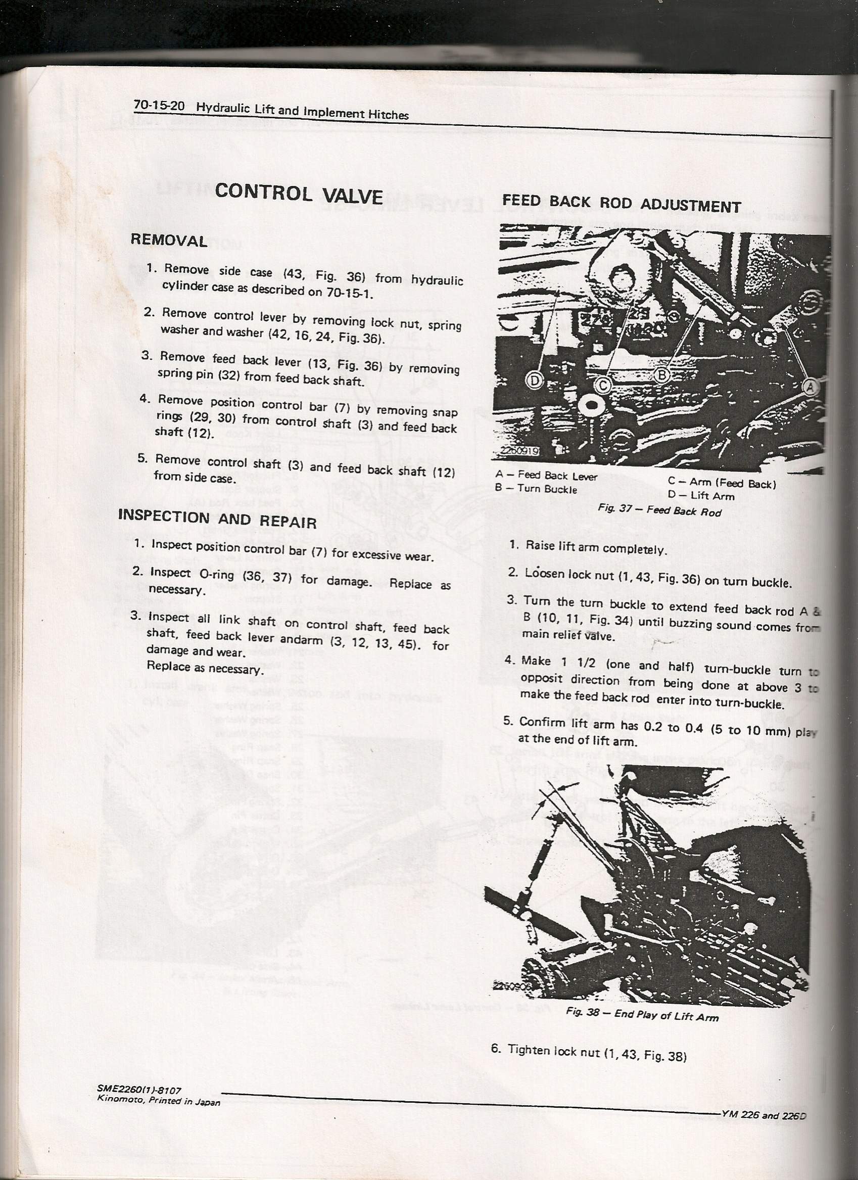

I have a Yanmar 2020D with the V2 Loader. All works fine but am I (new to this) experiencing some weakness in the system around the bucket curl.
I have been using my box blade to scrape up material and then using the loader to pick up the dirt. When digging, picking up material, or trying to pick up rocks, the curl on the bucket is very weak when the 3pt is in the up position. If I lower the box blade a bit I get curl stength back.
Should I test the system pressure?- If so I need to buy a guage and adaptors? Anyone have any idea what the fitting size is? And, where would I hook the gauge to check the system pressures? I assume once hooked up I put a load in the bucket and see what the readings are?
As for the curl being weak when the 3pt is up - is that normal? Seems the 3pt is calling for pressure / fluid while I am trying to use the curl on the loader. It has a blb joystick loader valve with no float or BYD.
I may not be able to really check into this until spring - Its bound to start getting cold here again! - and the ground should be too hard to dig, but I want to get my head around this so I can tackle this sooner than later.
/ V Teks Loader/ Hydraulics Questions #2
If you lower your 3 point just an inch or so how is the bucket curl? If it seems to be stronger there your feedback rod may need adjusting. The feedback rod is what tells your control valve to quit trying to raise higher. If your pump seems a little loaded when the 3 point is all the way up that is another indication the feedback needs adjusting. Whether you need it or not I will attach a page out of the ym220/226 manual showing the adjustment. I apologize for the quality of the picture but that is as plain as it is in my manual. Your 2020 may be completely different. :thumbsup:
Yes Winston - exactly. When the 3pt is lowered slightly, power is restored to the curl!. I will take a look at the file you sent over - THANKS!!!

THANKS Winston - I spoke to Hoye the other day and they said that it was more like number 1, but mine sure doesn't act like that and honestly, I like the ability to raise it up in increments so I am glad to hear that its number 2.
Hoye did confirm that when the 3pt hitch is up and wanting to move upwards and cannot (like mine) and the loader bucket is calling for fluid, that it could be dead heading which is not good. So I am going to try to make that adjustment this weekend...Thank you for the photos too!

As far as your problem Scotty in my minds eye shortening the reaction rod is where I would start so as the 3 pt gets to the top it is not pushing on the control however yours does that I am not sure.

I had my mine out of adjustment. When I raised the lever all the way up, it would load the engine ( like it was still trying to lift but was all the way up) I have a stop on the lever that I adjusted to keep me from moving my lever too far so, it won't do this. But, like others have said, mine will stop at any height & hold there
/ V Teks Loader/ Hydraulics Questions #15
Mine will do this, i just make a habit to not pull it up all the way. I think you can adjust this, im just to lazy to do so.
So i just pull it up to about 90% of the range of motion. After several years i dont even pull all the way to the back anymore(actually after several weeks of using it).
/ V Teks Loader/ Hydraulics Questions #16
If I'm understanding this correctlly :ashamed: Easy Fix even for me. When your Arms have "Almost" reached thier highest point that where you set the Adj. nuts on the Cam to your Linkage to pull the plunger away from the Hyd.valve. No mention of this Adj. All you need is a pair of pliers.
