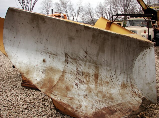

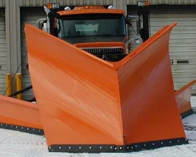

Has anybody ever made a V - Plow? I am thinking about making a small solid V Plow, (no power angling or anything) to mount in the bucket of my small loader. Would be about 4' wide. I can work out the mounting easy enough, but not sure about how to get the right roll / angle. I envision a small version of those pictured. I think I could cut the moldboard braces to the right curve and then form / weld sheet metal to them. Just not sure how to get it right. Any thoughts?

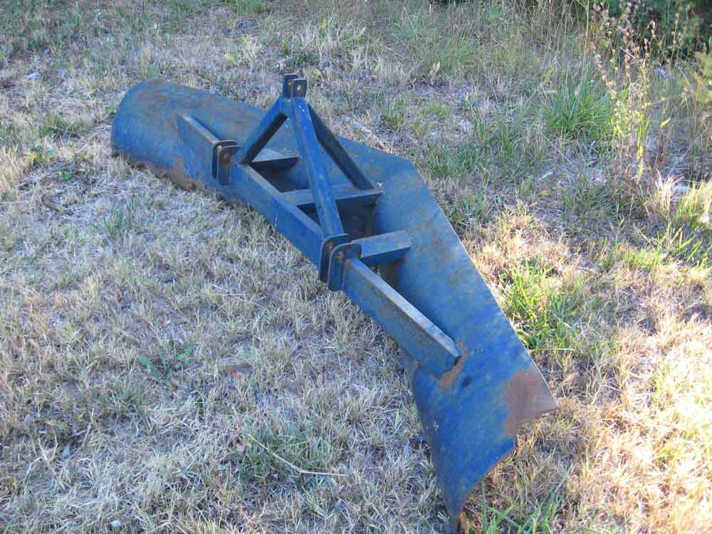

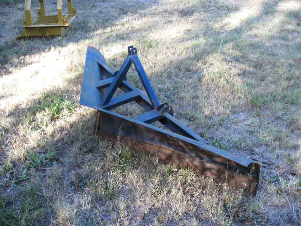

I had one and really didn't like it. It was built to go on the 3 point hitch and plow backwards and I found that a normal backblade worked better. I traded it for some tirechains and the guy who bought it made a mount for his loader and seems to like it. The one thing you really need is a skid shoe in the middle so it doesn't dig in, especially if your drive is dirt or rock. Here are a couple of pictures of it.

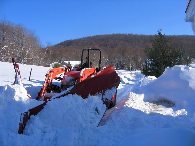

Hunt around for something already built. I found this one and just made up a SS quick hitch for it. Fun to use but it really takes a lot of snow to not feel like an idiot if some one were to see you in 6" of snow:laughing:

That is Cool!!!!!! I would love to find one already built, but don't suspect I will. I have done way dumber things than plow 6" of snow with my tractor!

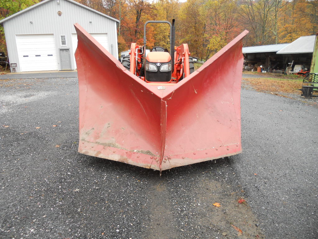

/ V Plow #20
Phew. That thing will do some damage!
