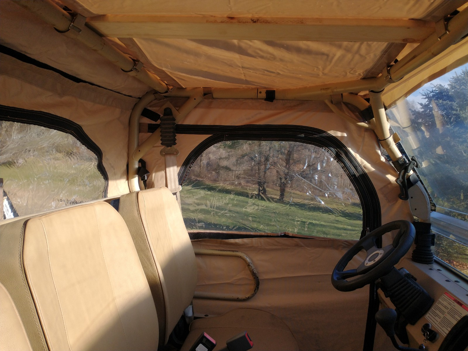

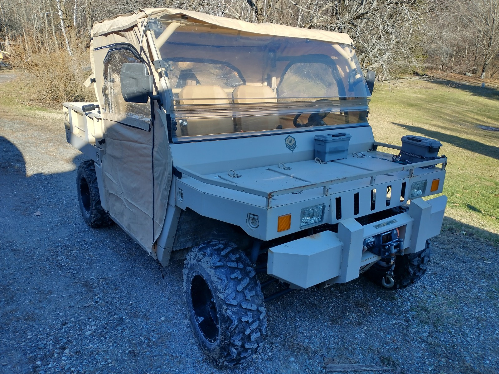

I've got an unusual UTV, a Warrior 800. Like any open vehicle it gets cold trying to use it in the winter.
I got a soft cab for it which helps a bit, but it has lots of air leaks while traveling at any speed and even when parked.
So I added one of these inexpensive chinese diesel air heaters, what a turn around for cold weather.
This Saturday I was up in the woods with my nephew while he was dropping some trees, it was in the low 20's outside in the cab it was around 50.
My UTV,
with the soft cab on her,
inside the cab,

and the ducts in the cab, I have longer ducts ordered to get better heat distribution, they just reach inside now between the middle and passenger seats,

I agree that diesel heaters are a cool thing! And the Warrior 800 looks both outside and inside just fine!

The only issue I see for your application is the enclosures of these things are made out of super cheap lightweight materials. I don't see it lasting very long on the back of a UTV bouncing down bumpy, dusty, muddy roads. Is there any dry storage areas on that machine? IF so I would install it there without the cheap enclosure. Just my opinion, I hope I am wrong and it works well for you.

I'm wondering how well it will hold up also. It is well secured, so I guess it's a wait and see issue.
No good dry storage areas to mount it in. It will not see much dust in the winter up here, it will be interesting to see
how it holds up in snow and freezing rain.
It can easily be removed with two bolts and an electrical disconnect for summer time as will the enclosure.
