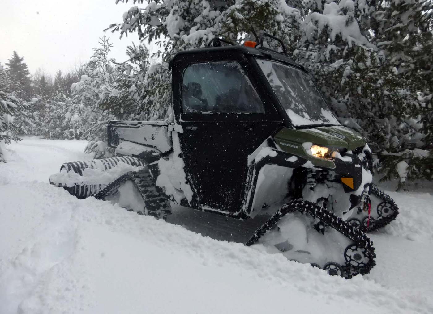

My work using UTV's is quite strenuousness and might be different from everyone here. Do note, I do not personally own a UTV or ATV for that matter but do operate them for my job. Nonetheless Kuboto UTV's have failed among the world of snow grooming. There hydro-static transmission robs so much of there engines power and drive axles have broke etc, etc. Again, we may be working harder harder than you folks will.
/ UTV Decision #31
If you are breaking drive axles on an RTV you are not working harder, you are just abusing and quit possibly don't know what you are doing... It's not the RTV, it's you! HS
/ UTV Decision #32
I'm sorry but don't they build snow groomers to groom snow?? To me I would but a snow groomer for grooming snow before something that will have problems.
Are you over sizing tires?? Putting tires on that aren't recommended by factory?? There has to be something that ain't adding up to cause you problems.
I think it's time to by the right machines for the job
