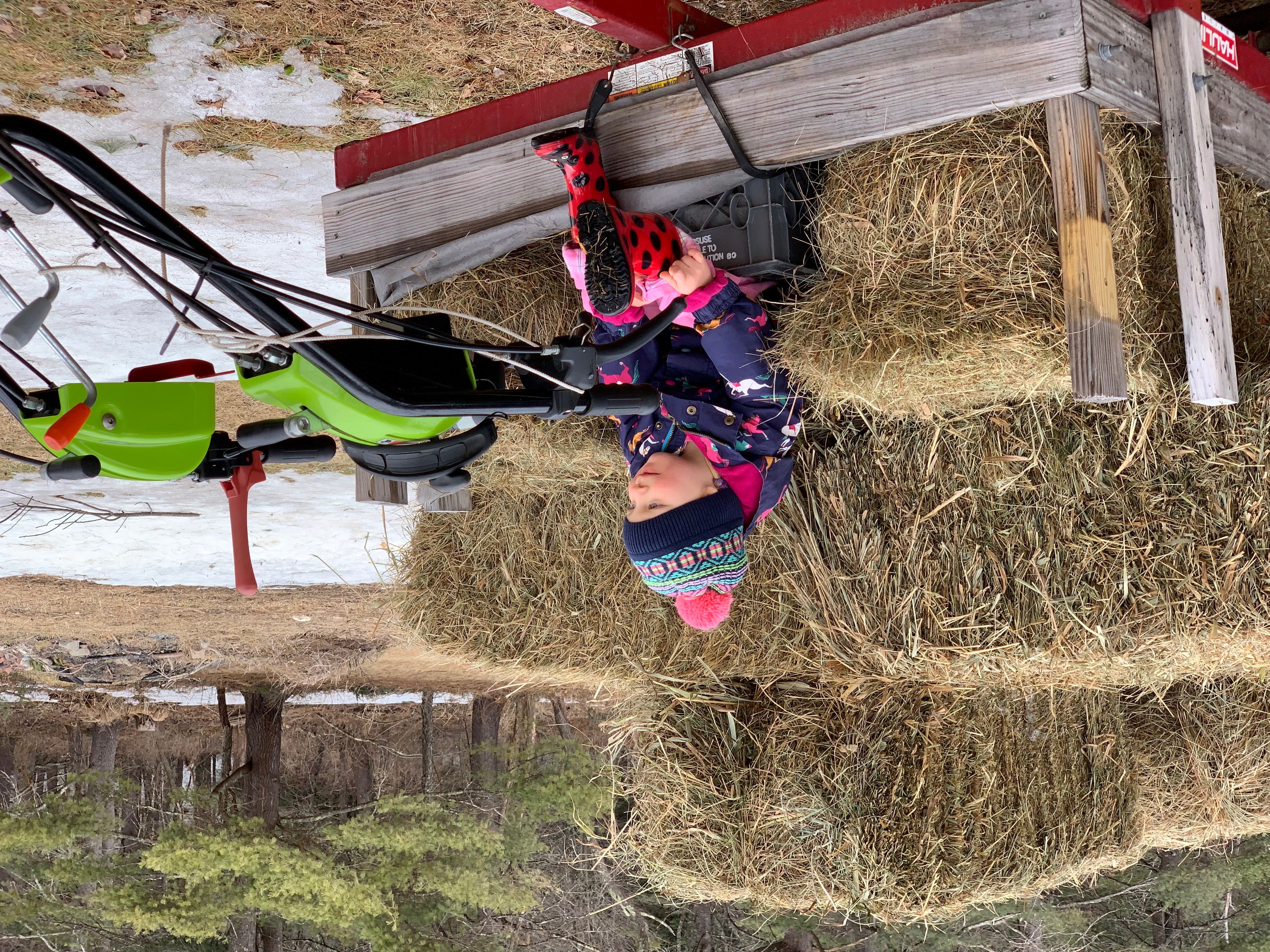

Ready to roll.
I think next I'd like to figure out a mount for a chainsaw, and maybe a better seating system. Still, I'm pretty happy with how useful it is given I had the trailer lying around. Anyone know if you can buy a rattle can of paint in Grillo Green?
I think that model trailer just seems to attract children,,, :eek:
:thumbsup:

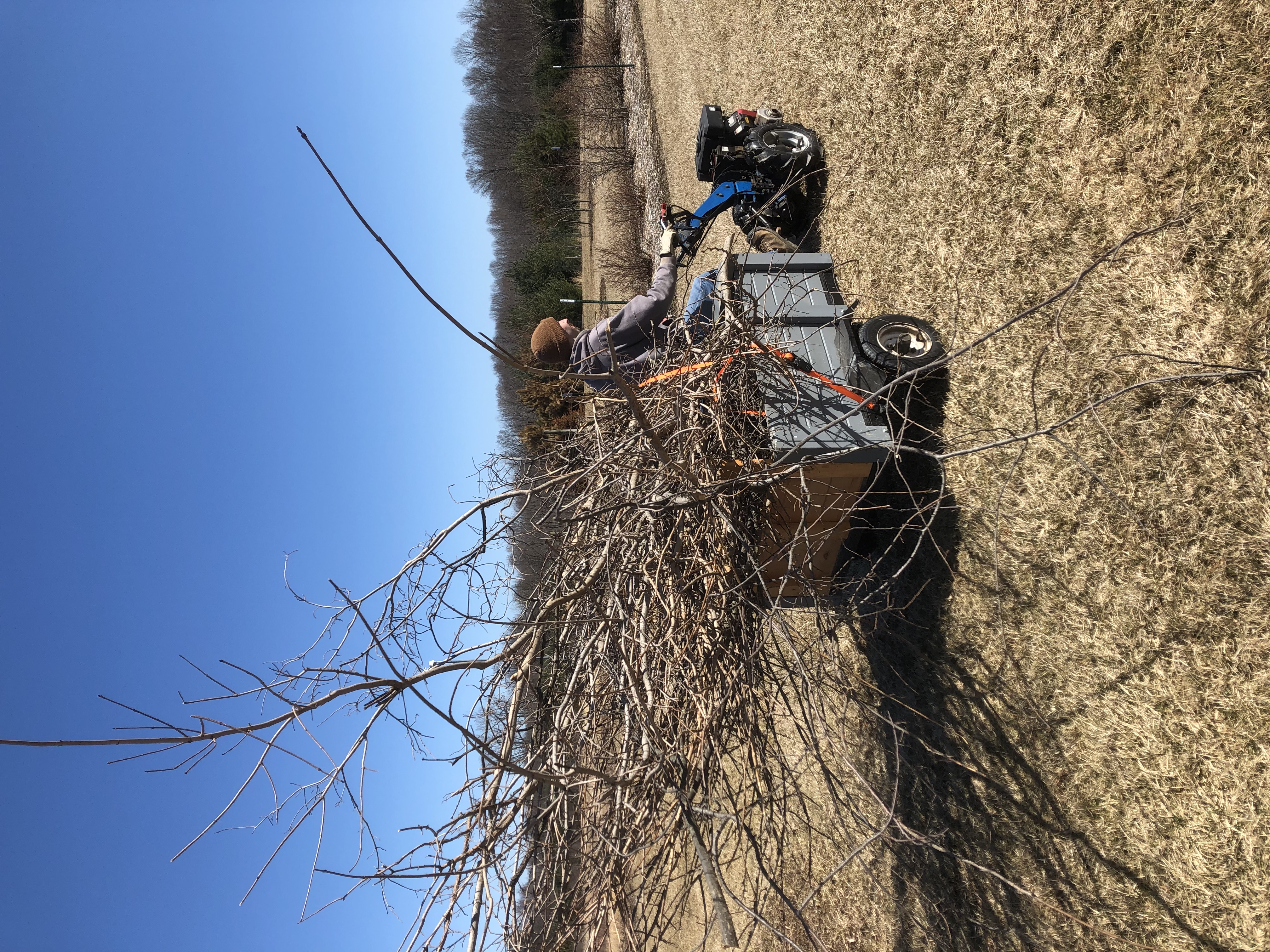

Here are a few pictures of my 605 in use with my trailer.

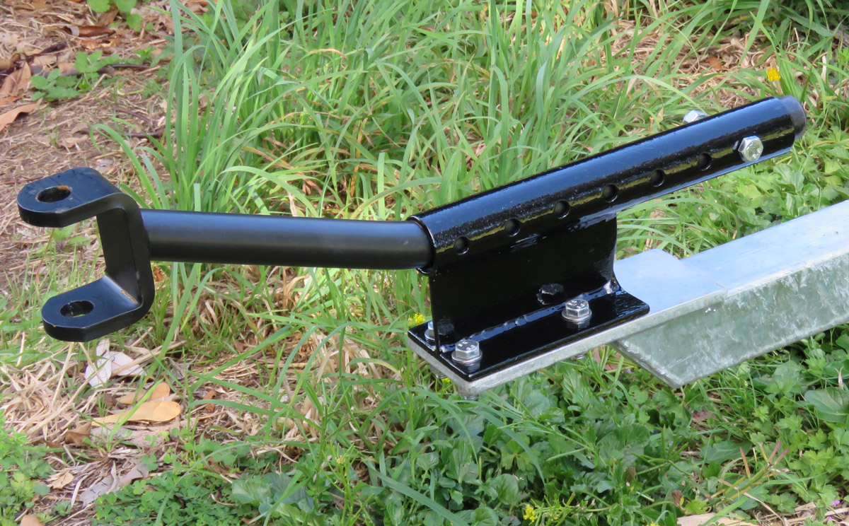

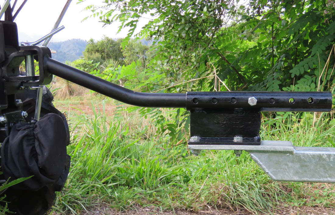

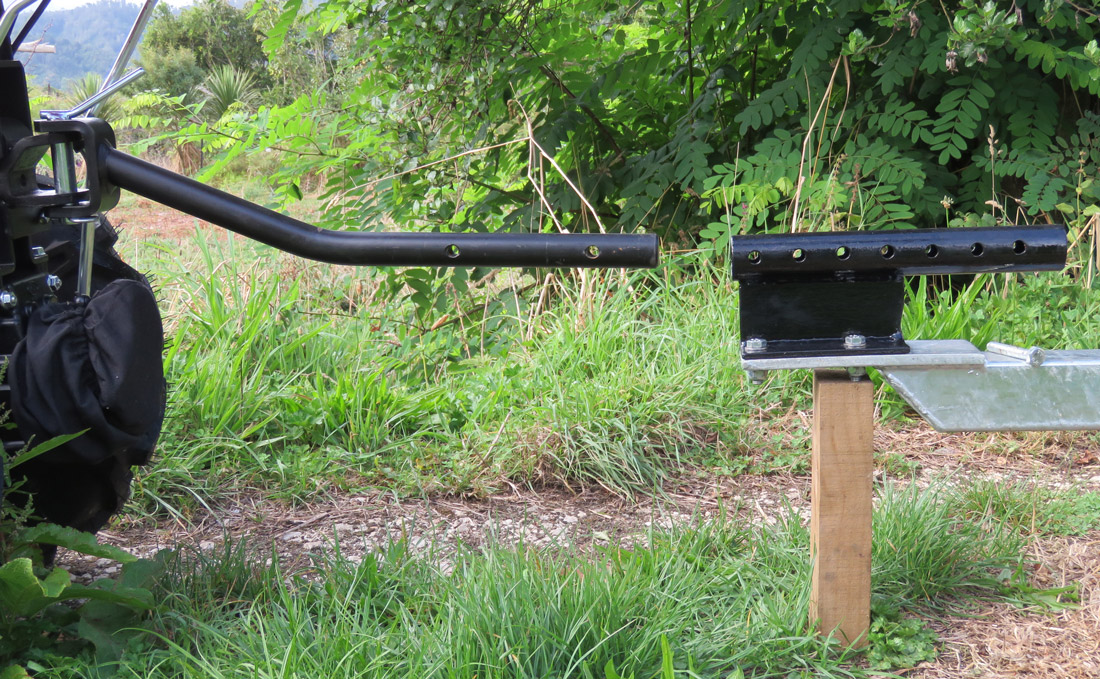

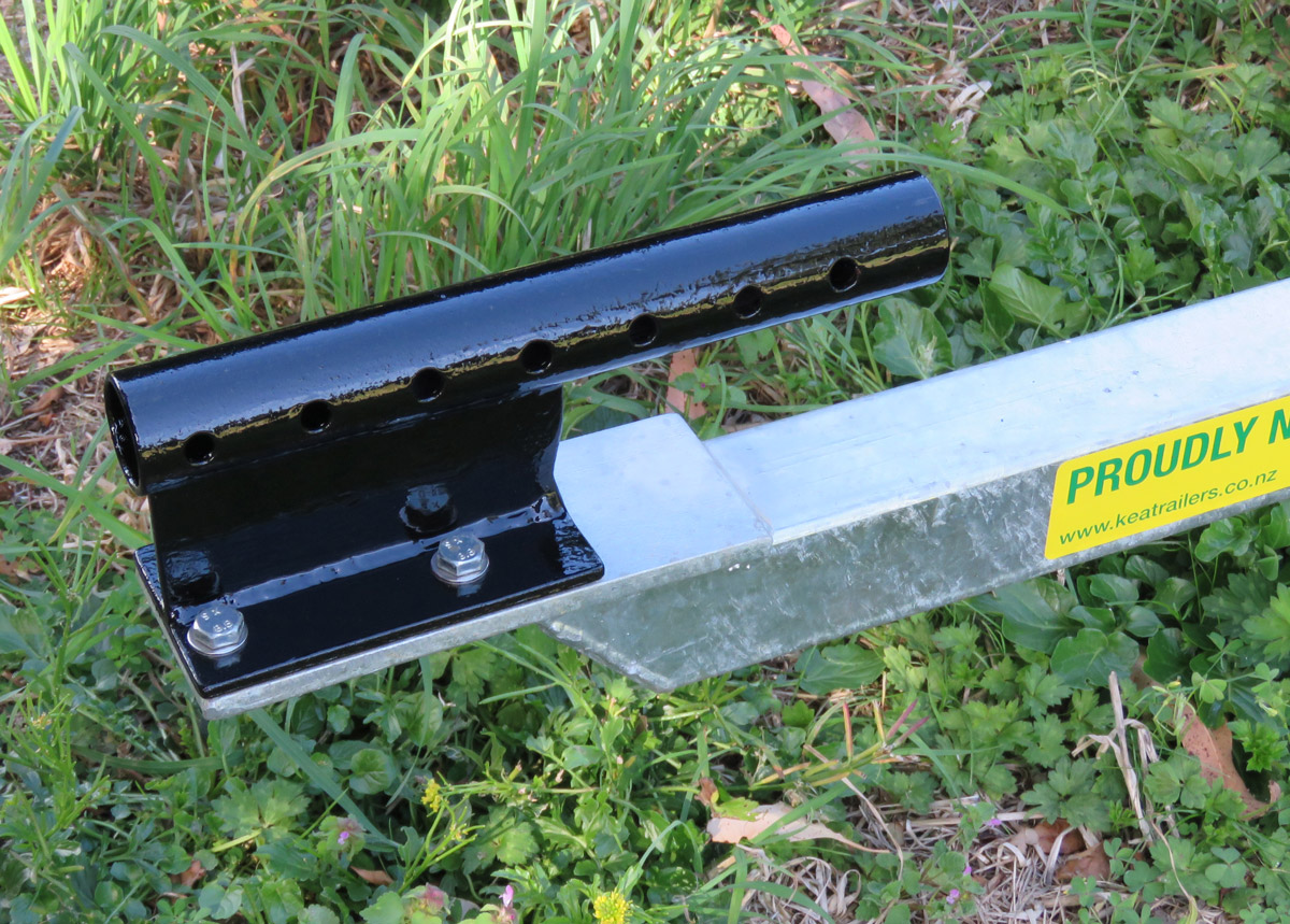

The tongue on my trailer is quite low so I had to make a different type of adapter to make up the height difference and connect to the BCS Curved Coupler (92247720).
Drawbar-Adapter_01.jpg Drawbar-Adapter_02.jpg Coupler-Adapter_01.jpg Coupler-Adapter_02.jpg

Very nicely done, lots of adjustment. A lot nicer than my piece of used gas pipe :)
