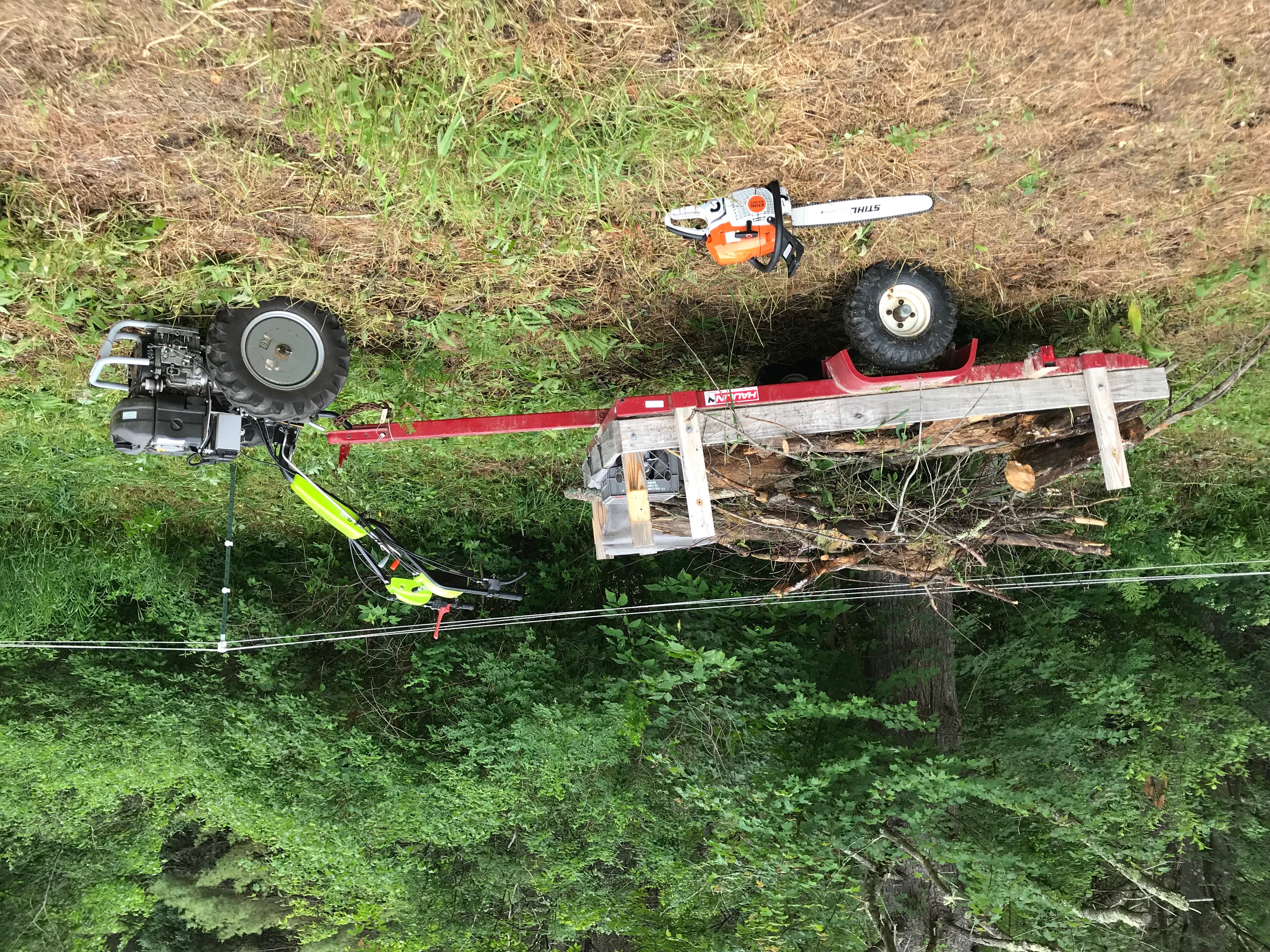

Ready to roll.
I think next I'd like to figure out a mount for a chainsaw, and maybe a better seating system. Still, I'm pretty happy with how useful it is given I had the trailer lying around. Anyone know if you can buy a rattle can of paint in Grillo Green?

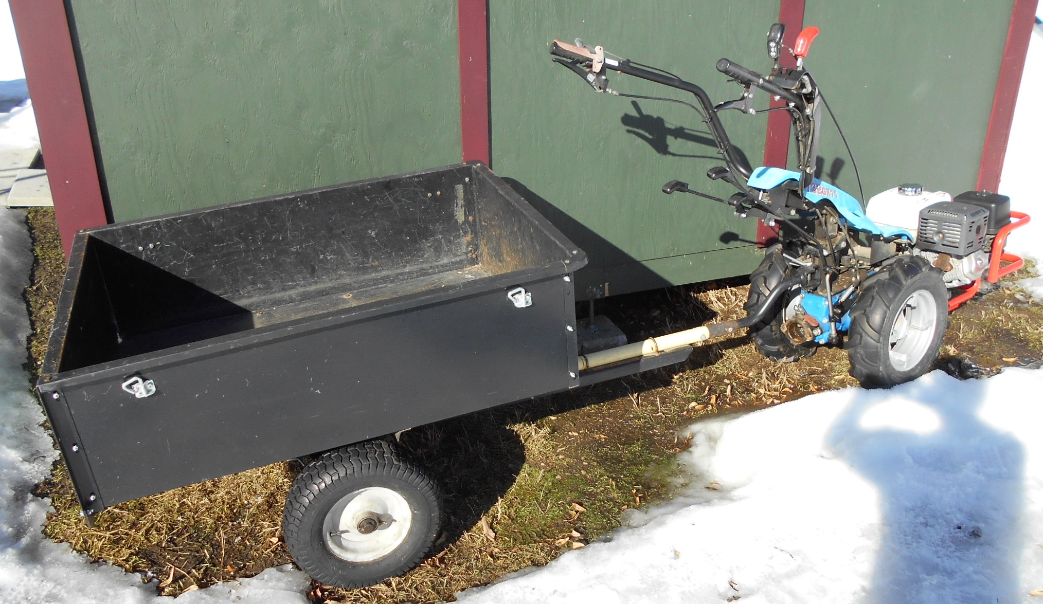

So.... I finally got all the bits and pieces together along with the BCS back from its Spring TuneUP. Yes, it works but I have to admit I'm not totally satisfied with the results. First, I used a simple 2x6 across the front of the small utility trailer as a temporary seat. Trouble is I keep sliding around and fear I may eventually slide right off! Not good. Also, the BCS has a VERY wide turning circle when used this way. I assume there's nothing I can do about this. And, the clutch does not fully release so it creeps forward even when the clutch lever is locked open. Will have to investigate further. Hope to get a good picture soon. Sudden rain storm prevented any photo opportunity today.

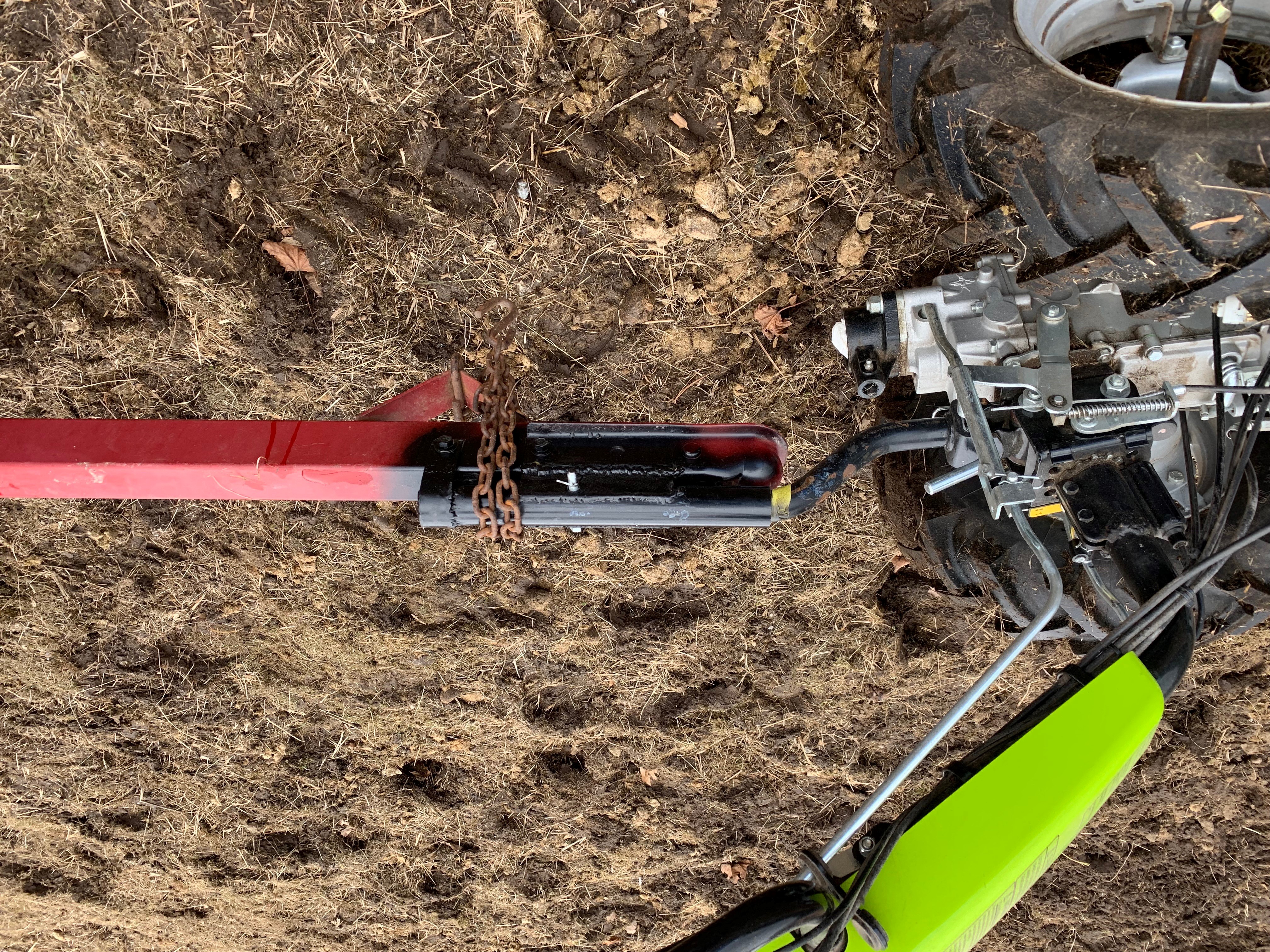

Here are a few pictures of my 605 in use with my trailer.

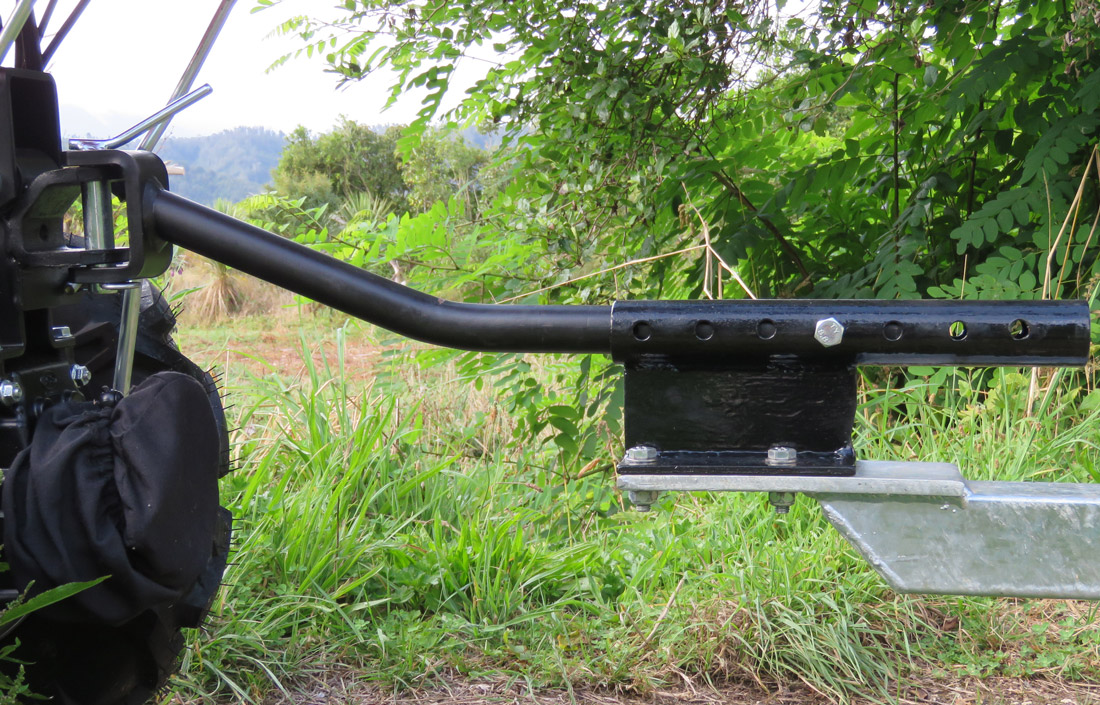

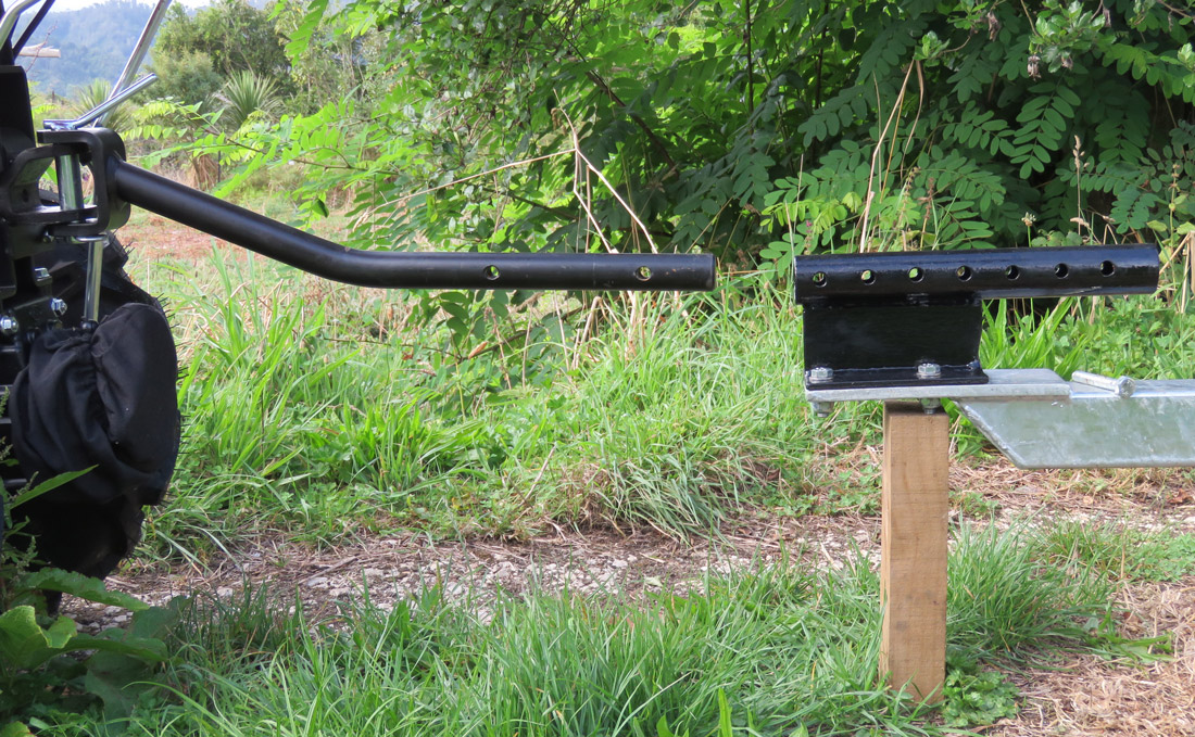

The tongue on my trailer is quite low so I had to make a different type of adapter to make up the height difference and connect to the BCS Curved Coupler (92247720).
Very nicely done, lots of adjustment. A lot nicer than my piece of used gas pipe :)

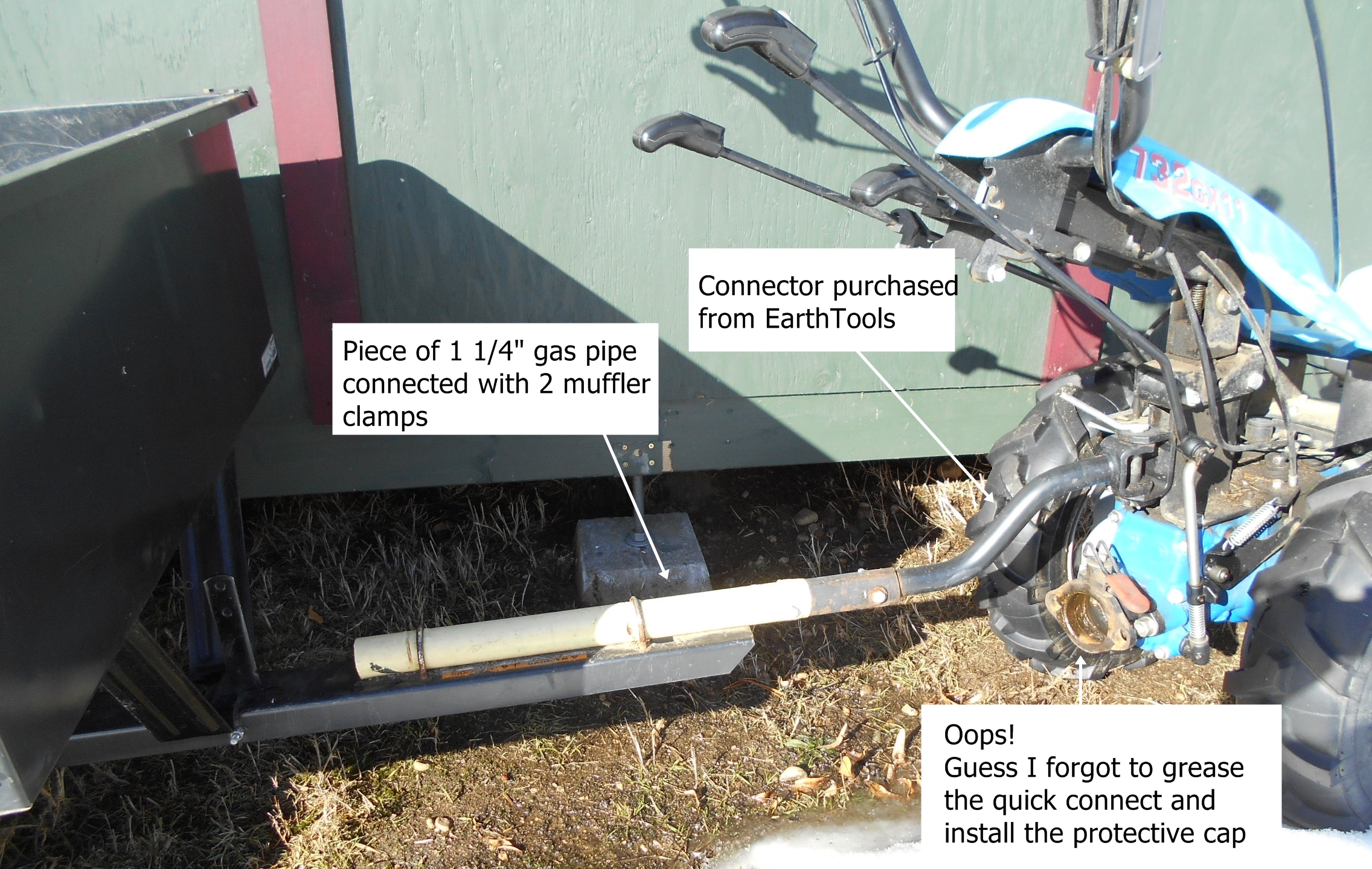

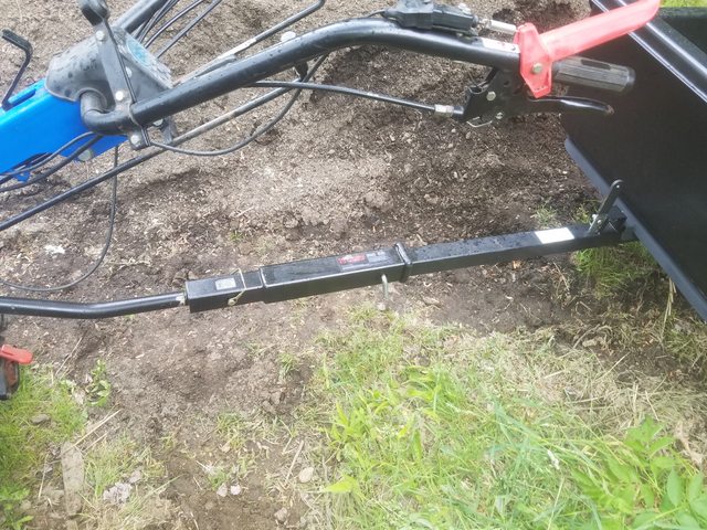

UPDATE: found a pipe scrap at the local ACE Hardware store which fit the tow coupler from Earthtools perfectly. Simple assembly and off I go. Unfortunately, I've found some problems. Clutch adjustment when I switch controls around is a real pain. Wide turning radius makes use in the orchard difficult. With any real load in the trailer, the BCS doesn't have enough traction to climb my hills. Have to split any loads and do two trips. Board for a seat was a lousy idea as I keep sliding around on turns and slopes. Really had hoped this would work, but need to rethink whole idea.

As far as sliding, you might install a couple of pieces of wood on either side of where your butt goes to make a sort of low-rent 'bucket' seat. Let us know if that works. I have similar plans in the works, and a board was among them.
Do you mean when you turn the bars around to use a front-mount implement? When I do that on my 732 it always snags the clutch cable on the gear shift linkage, keep meaning to re-route it.
I put a spring clamp on the safety switch so I can steer holding one bar at a time - (does that make sense?)
You must have really uneven ground Phil. I've been using the same piece of 1x6 for years.

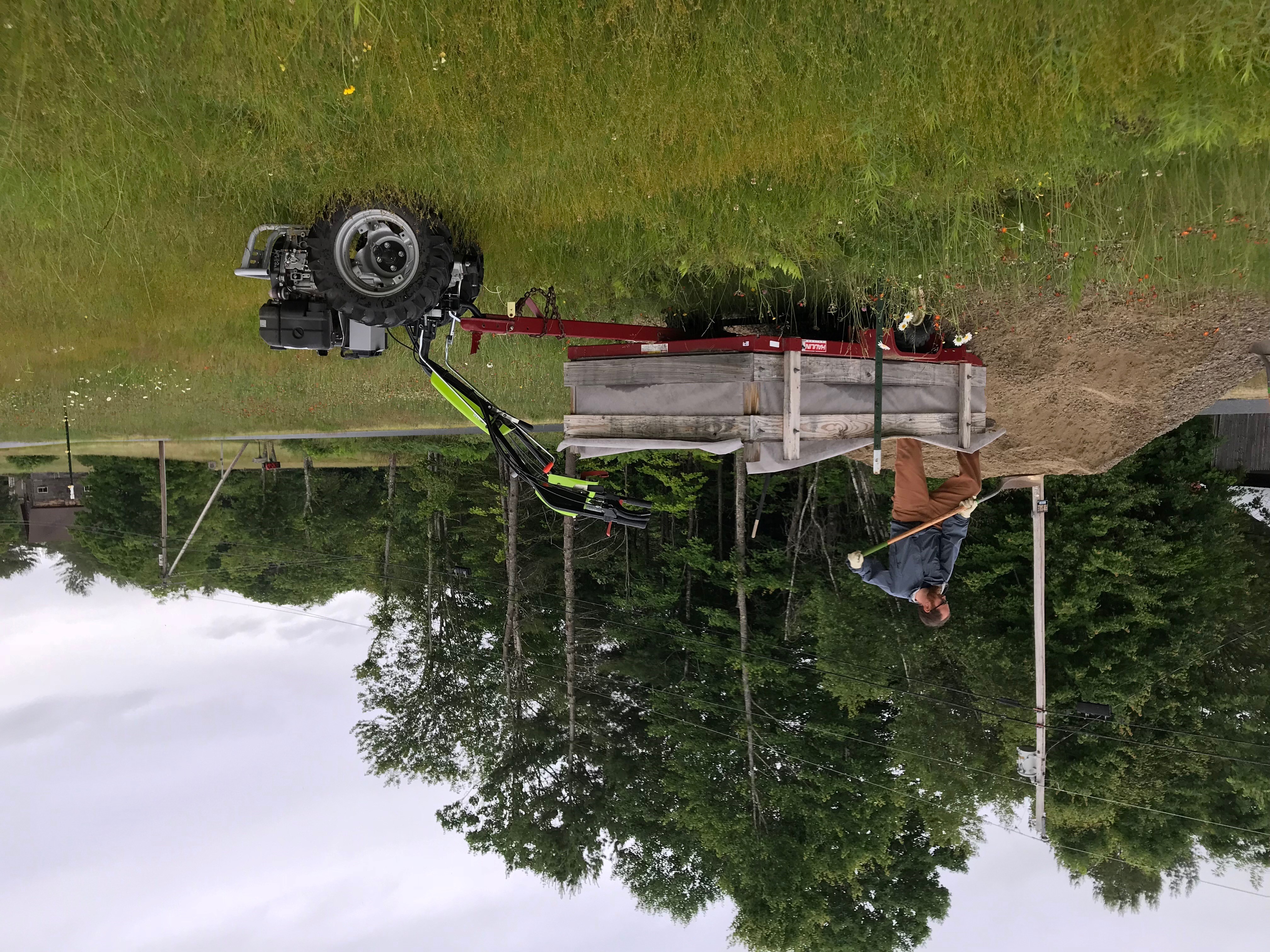

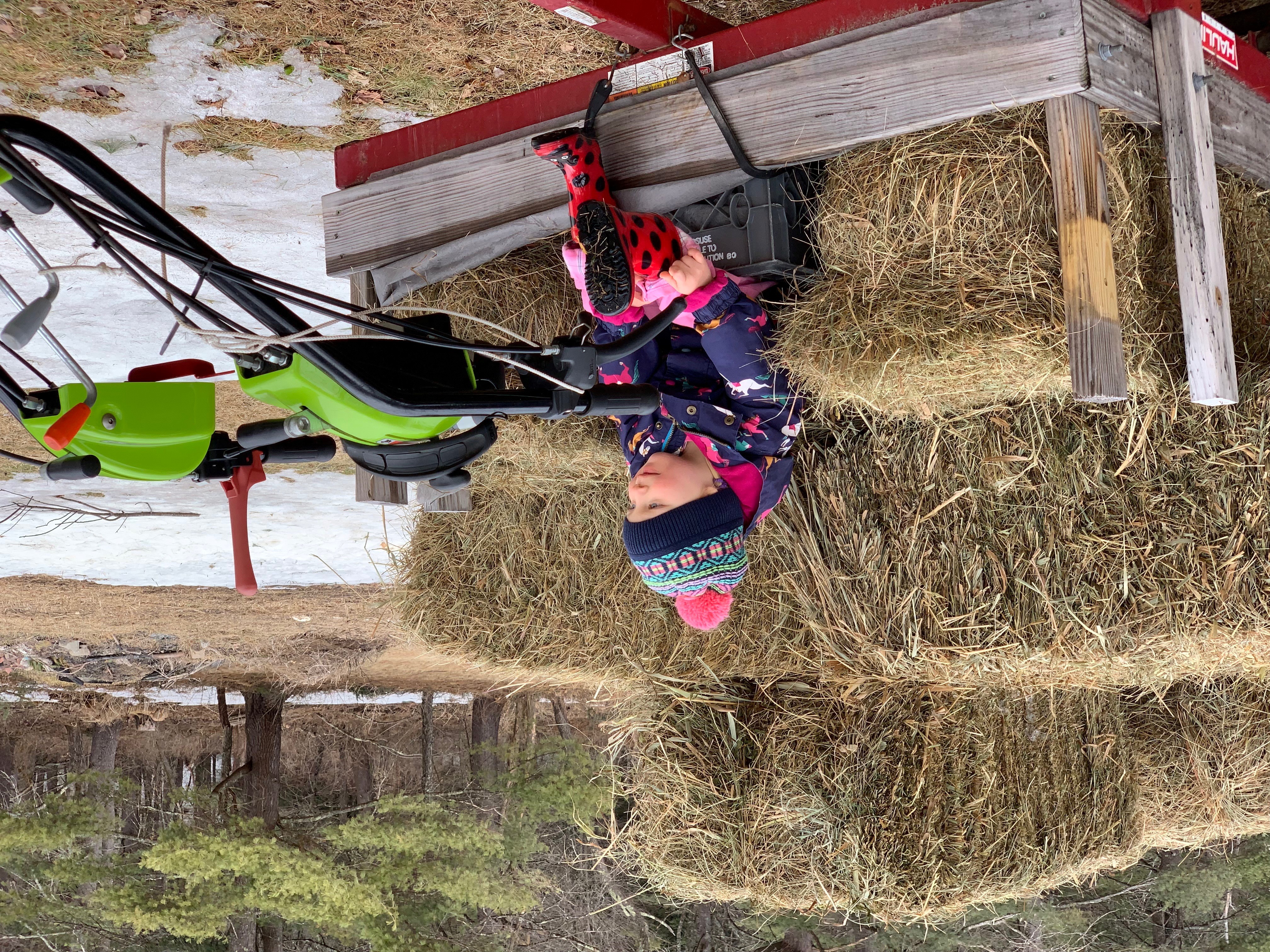

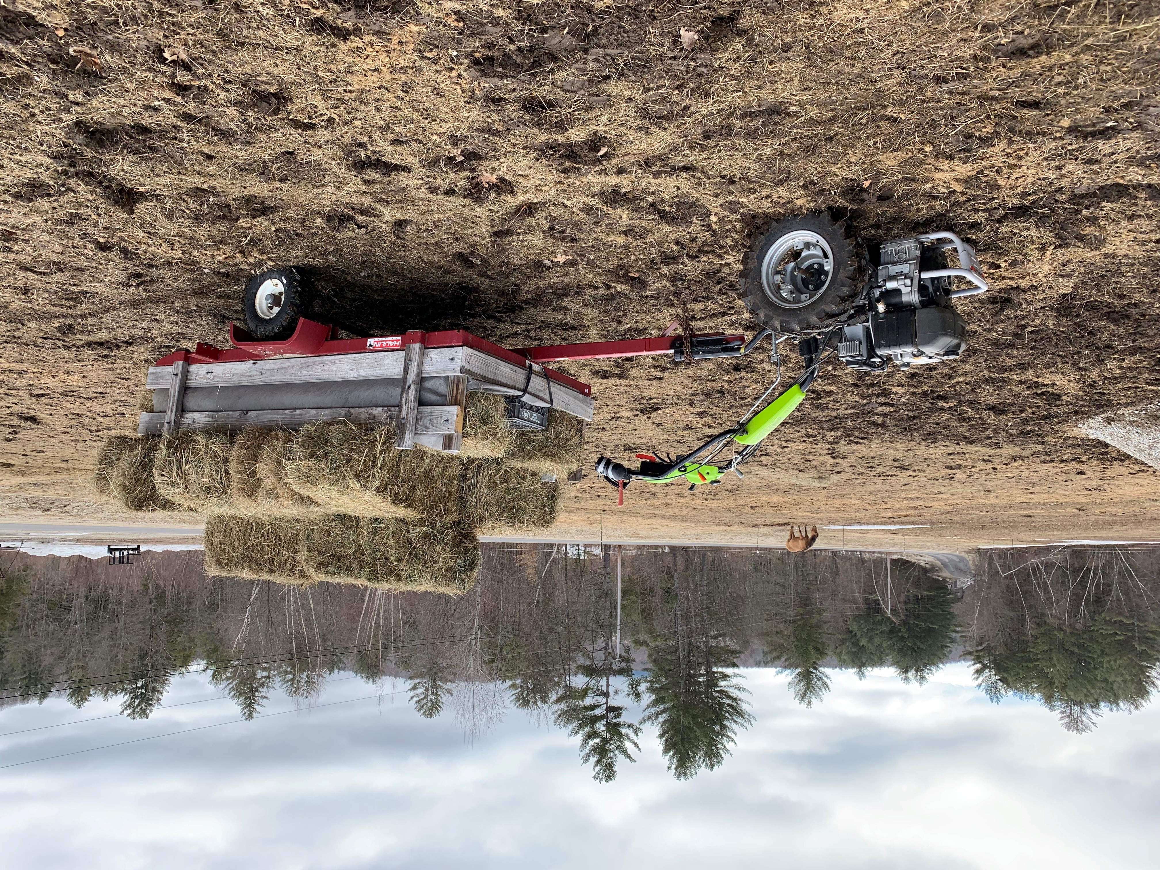

Yes he's sitting on the edge. It's a 3" wide lip, comparable to the comfort of a bicycle seat. It would be very easy to attach a 2x8 to the lip for a more comfortable seat - there's a good 5 inches of flat just around the corner from the front lip and adding a bench wouldn't be an issue. At times I stand on the coupler for extra weight on the drive wheels - might be nice to add a standing platform to that, maybe attach through where the hitch pin is.
It works great on _dry_ hilly uneven land. I can add more articulation if I please, I would have to mill or grind a slot rather than use the clearance in the pin hole.
On a wet hill with a full load, traction is definitely an issue. I've had to get off and push. Wheel weights or engine weights would help.
It's actually very easy to steer with all that leverage on the handle bars too.
What direction are you worried about it tipping over? Sideways I think you'd have a hard time tipping it unless your load is very top heavy. Center of gravity is really low on both the BCS and the trailer. Tipping like BCS wheels off the ground shouldn't happen with the length of the coupler and the weight of the BCS.
