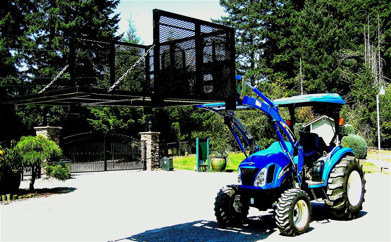

I have a all purpose utility box on the front end instead of 3 pt rear end.
That's a nice utility box!
You should have a thread on that....If you have the pictures when you first started building it.
That would be handy around here....I really like it.
Thanks for sharing!
/ Utility box for 3p hitch #13
It's a simple design....
A 4'x6'x3' metal cage supported by the fork lift which slide into 1'x4' metal tube cross the bottom.
The gate opens towards the front flat with the floor so it become a 6'x7' working platform.
The box has short leg on each bottom corner so it can be left sitting on flat ground.
Here is another pic.....
That's a very good setup!
My wife would want to use that so she could pick apples, pears & cherries:D
Thanks for the picture!
