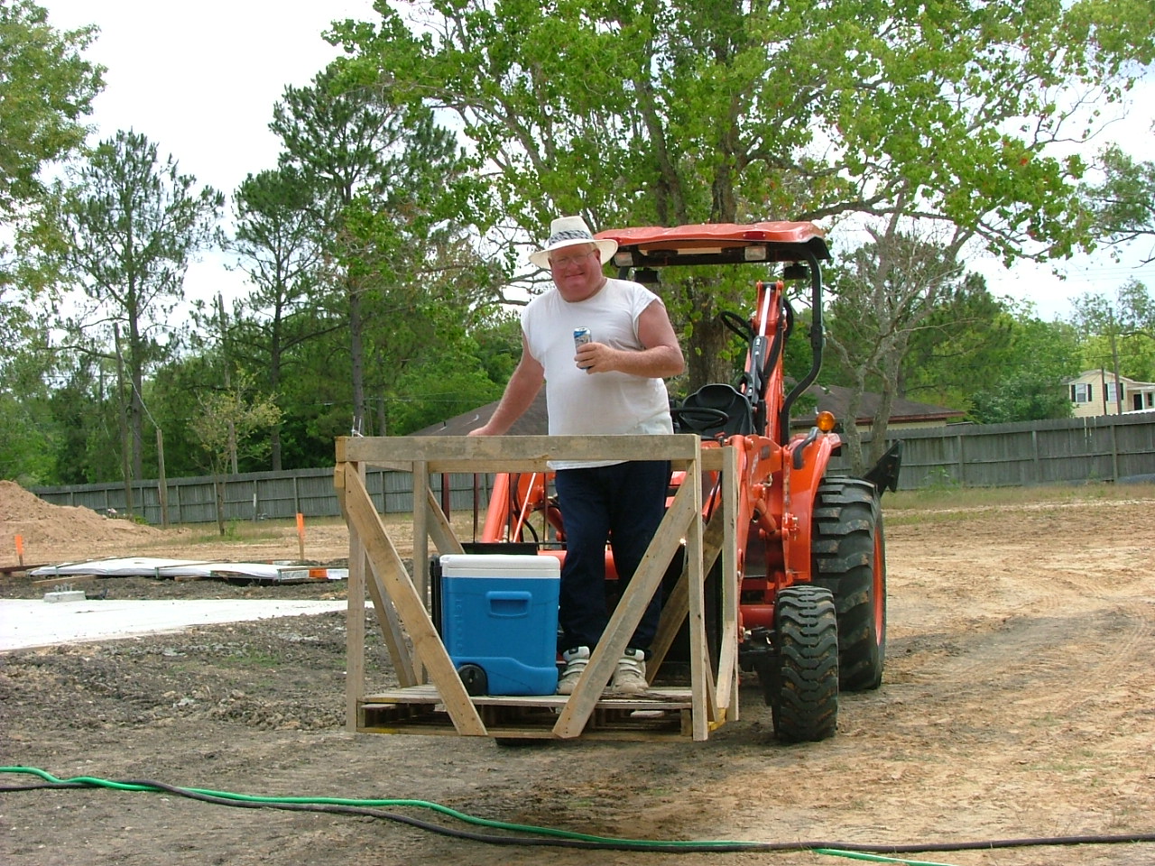

   / Using bucket as work platform. #205
Hi Henro,
Thank you for the post and picture.
You are brave! That is not a safe setup!
However, I am sure you knew that and I am guilty of this type of work platform also.
Don't work off that plank setup again! But if you do, may I make a couple of suggestions?
1. tie or fasten the plank ends down so they don't slip or slide on the smooth metal.
2. Make sure any electric lines around you are dead or safely insulated.
3. Consider wearing a safety harness with a "D" ring on the back with a short safety lanyard, and use it clipped onto an eyebolt or something that is screwed or bolted onto the house. Everything under this setup was metal and hard edged.
4. It is a good idea to have a helper, or spotter or "gopher".
No, I am not picking on you, just offering some advice.
May you live long and prosper with your tractor.
