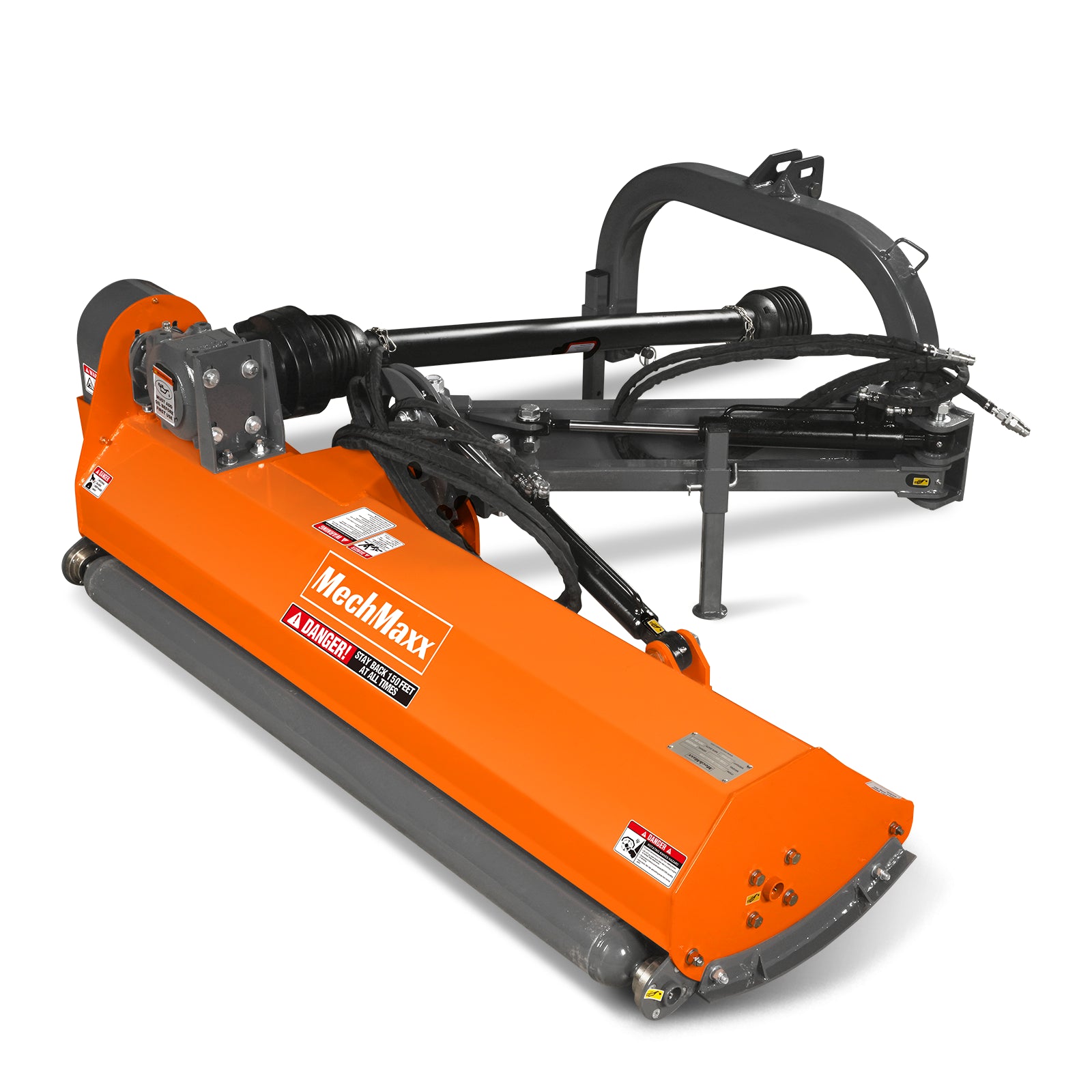

I have been considering getting an offset flail mower to cut grass and "bush hog" my food plot/trail/shooting lane. I do not need golf course quality results. I will also use it to mulch up brush piles and leaves
Mechmaxx has this model I am looking at:
My 40 HP tractor is 72" wide with the oversize turf tires. The mower cutting width is 65". I plan to offset the mower about 30" for the first cut and then "straddle" the subsequent cuts to get about 55-60" of effective cutting per swath.
I like the idea of being able to use the offset feature to cut around the pond safely and to cut grass over the septic tank without having to ride over the tank. With the offset, I and also cut under trees. I also need to "bush hog" a strip bewteen my drive and a fence line that the ZT cannot handle. The other plus is doing the job in an air-conditioned cab.
I have a Bad Boy 54" ZT and I can cut my grass in about an hour. I suspect using the flail will take another 20 minutes but I can live with that. If the flail works, I will sell the ZT
What are your thoughts on this approach? Any concerns I have missed.

The mower is too wide and heavy for your tractor.
If you are going to do this purchase either the smaller
48 inch Del Morino or 48 inch Maschio orchard and
vineyard shredder.

I know you are a flail expert leonz, but I have been using a 5 ft Rhino, and a 5 foot Mott with two 30 hp tractors for over 20 years with no problem.
A 4 ft mower on a 40 hp tractor seems undersized to me.

I checked the specs, and that ditch bank flail is 820 lbs. My 62" ditch bank flail weighs 707 lbs, and it's about all my L4060 (6450 lbs with loaded rears) can handle when fully extended. The actual cutting width is not an issue with my setup.
I would be much more concerned about that weight hanging out there, but I don't know the weight of @shooterdon s tractor.

Good post, and I agree. That weight is hanging on the downhill side of the tractor when mowing around a pond too. His tractor without cab or ballast weighs: 3,869#
His tractor specs: Technical Specifications and Data for LS XR4140

I use a 77" offset flail (Bestco HD) with my 52hp MX Kubota. It's sized just right. 841 pounds. Tractor has filled tires with 3" spacers.
My offset is such that the left front tire rides in the (already) cut grass and the mower cuts a full swath about 1.5 ft outside the right rear.
Great for fence line work. The white pvc pipe gives me an easy to view location marker for the end of the mower without straining my neck when riding a fence line.

I have oversized turfs (44x18 - 20) on the tractor filled with RimGuard plus a cab. I estimate the weight at 5500 lbs.
The 3 PH is rated at 2700 lbs.
I assumed that would handle the 820 lb mower but appreciate any opinions

Our tractors are about the same weight.
I a very shallow slope near the pond and I can reduce the offset. About the only place I would need the maximum offset is mowing over the septic tank and that area is flat.

Knowing all the facts helps decision-making, thanks for the information. I think you're good with tractor weight. The turf tires might be a negative around the pond slope.
