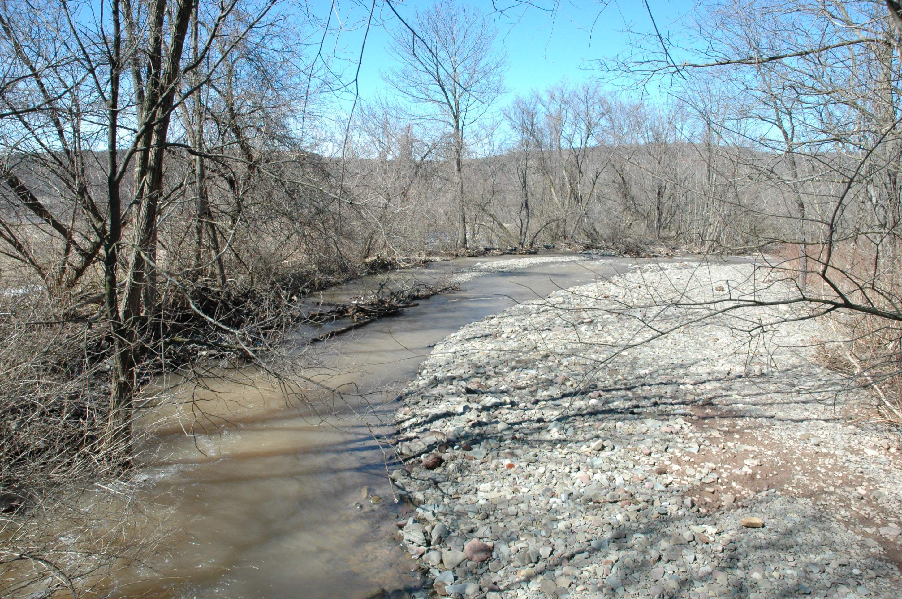

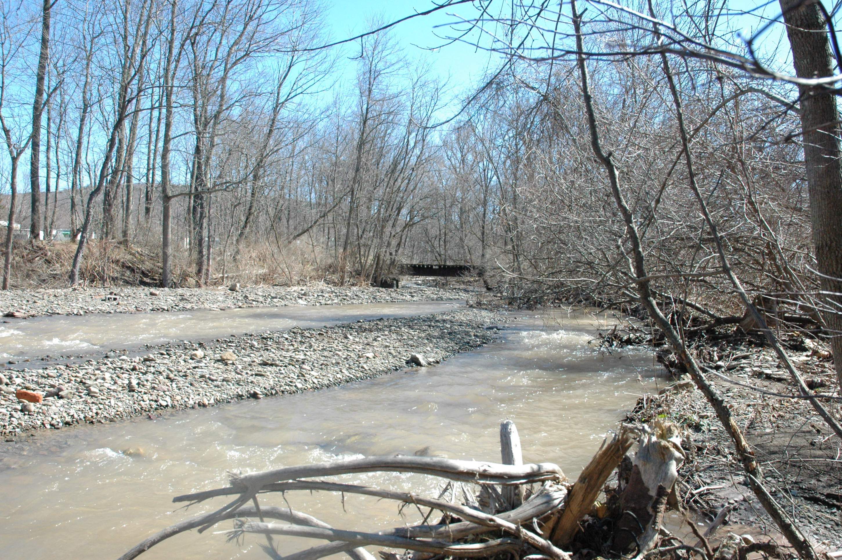

Thanks all for the tips! So I'm split between the people telling me to rent a dozer/backhoe, and people telling me try using the tractor. I'm attaching pictures that show where I'm having the problem, though these were taken at high water. Normal flow is nowhere near this. Hopefully that makes it easier to see the scale of the project.
Getting the tractor stuck is what worries me most of all -- I've done that before and it was no fun. The creek bed is almost fully gravel. There's just a little sand, and of course where it's overflowing is silt as gravel hasn't been able to build up yet. I don't really know how deep the gravel is.
I did do my homework about required permits. This is an unprotected stream as far as the state is concerned. The only way I would need a permit is if I was working on more than 200 feet of it. At most, I'm going to be working on 120-150 feet. The county's water and environmental is also pretty much my next door neighbor (lives a mile down the road) and I've hashed it out with him. So yes, it is a valid concern, but I have taken care of it already.
So the question remains: Use the tractor until it gets stuck and then bring in the dozer to pull it out? :) Or do away with the stress and aggravation of that in the first place and rent the dozer?
Nice stream and country form the pics.
No way would I try anyting with a tractor in that stream, for that matter a dozer is not a good idea.
If you have a litte work in the bank, you can give it a try, but I have an L39 and would not try swiming with a TLB, and a TLB can pick itself up and move sideways.
This IS excavator work, pure and simple.

Price a set of tires for your tractor vs. equipment rental. You'll probably cut tires in that rock.

This answer nails it. Is your time worth any money. I could rent an excavator for a day here for $300 and most likely do the job in four hours.
vs using my tractor and spend three hours trying to get it out of the mud.
In spring time around the bank the ground will be very soft and once you sink the loader in for a load, now what? You think you can just back out with all that wet dirt in the bucket. A full wet load of dirt will push your front tires into the mud, now you have to dump it and back out empty. Your at the same spot, just got the tractor dirty.
Try one scoop with your tractor, then run, do not walk to the rental store and get the excavator.

I had to think about this one long and hard. I'm all for trying to save money, and using what you got...but...I wouldn't do it. And, I own a compact, a dozer, and an excavator...and have a stream.....
You mentioned sand, silt, gravel, and at least a foot of water. In my mind, if you have any weight in the bucket you are trying to move, you are going to spin tires.....and eventually get stuck. Probably stuck pretty good with that combination.
Then you have to go rent the equipment, and have someone else help you get unstuck. could easily be more than 3 hours wasted.
If you get a dozer in there and start running gravel thru the tracks, that could be a big problem. Or worse, getting the dozer stuck.
My vote would be the excavator. And I would get the biggest one I could, a mini could get in trouble as well. Might cost more per hour, but it will take less time with the bigger machine, and you run less risk of getting into trouble. Good luck, and let us know what you decided with some pics!
