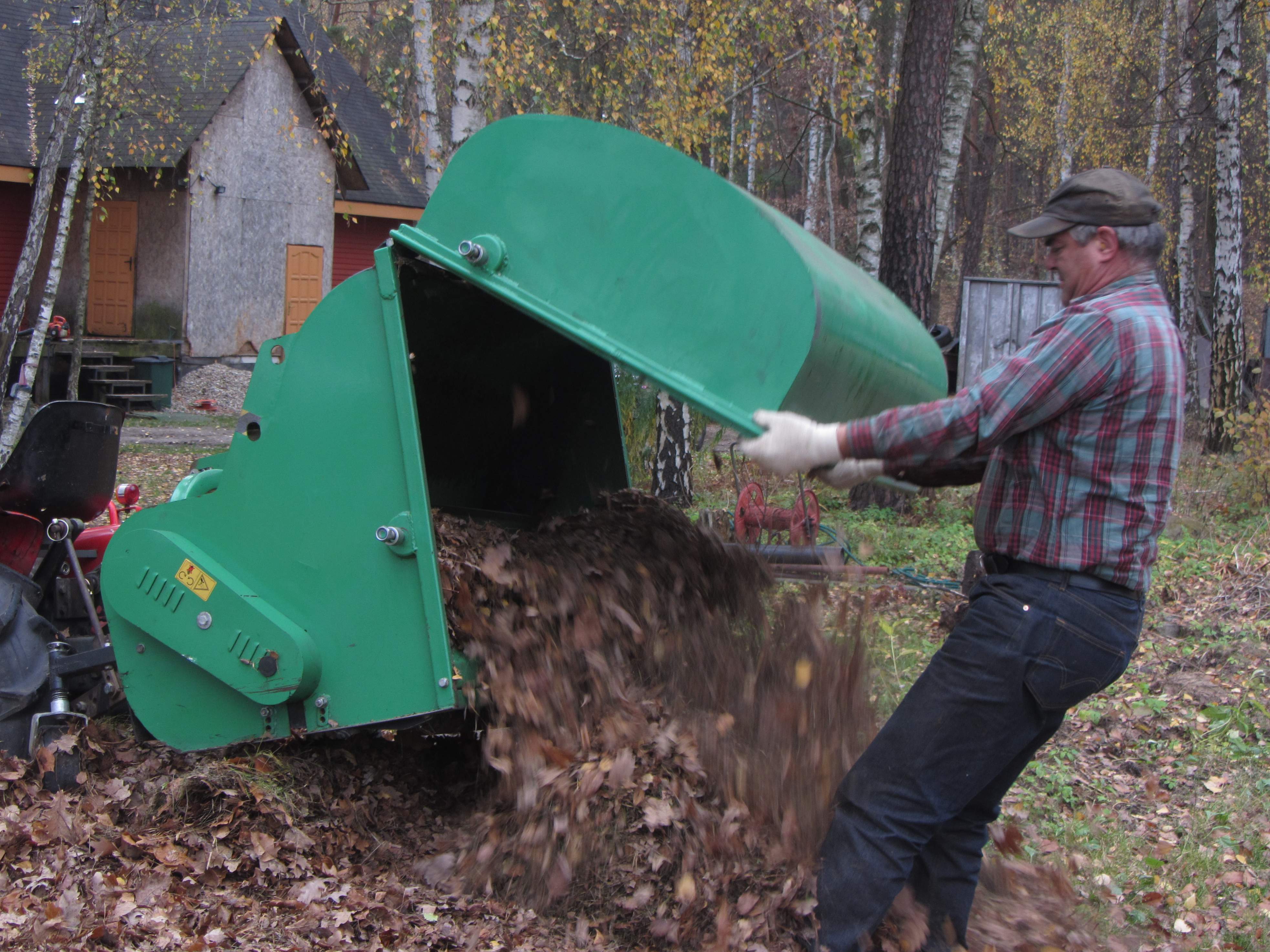

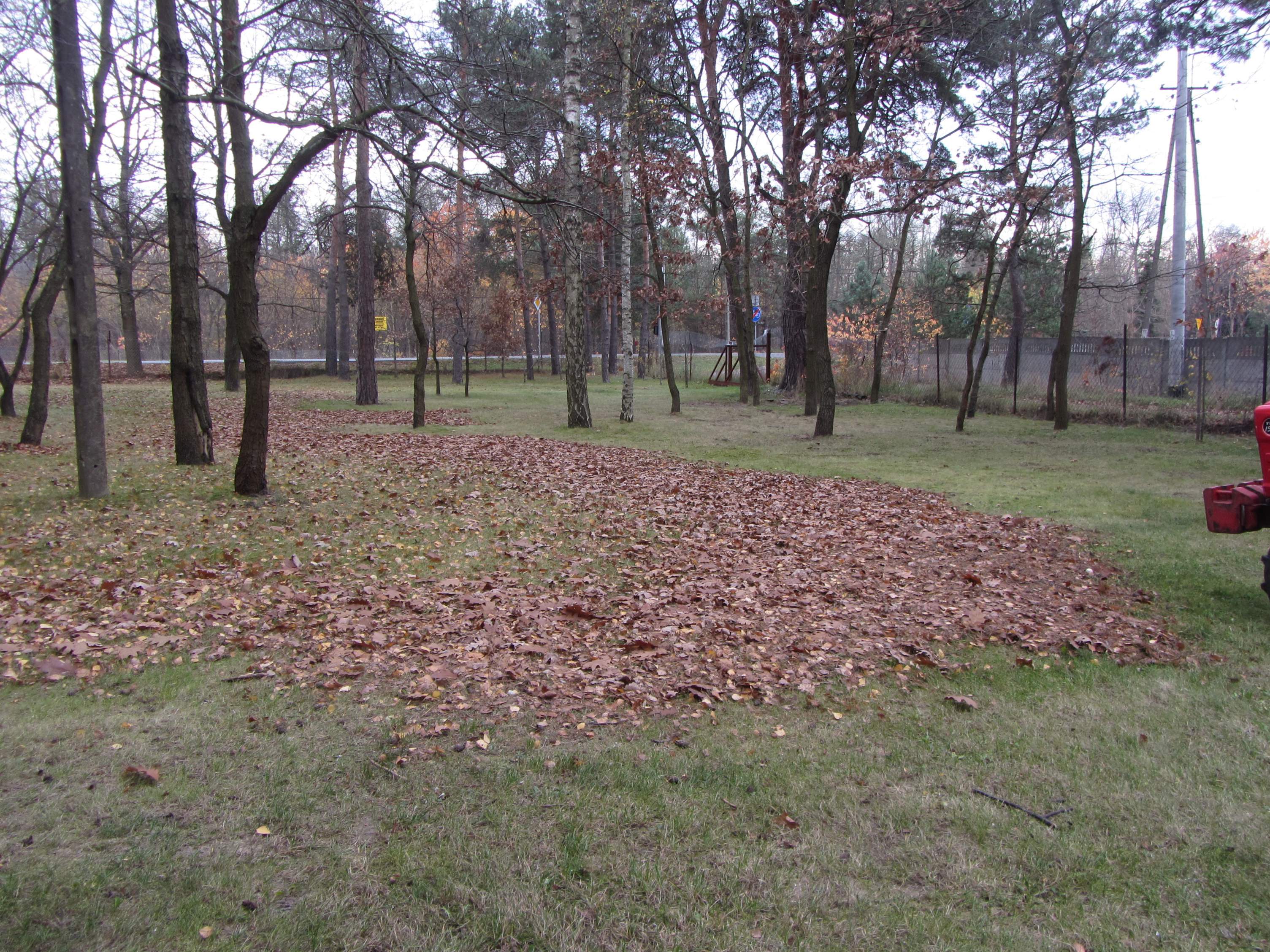

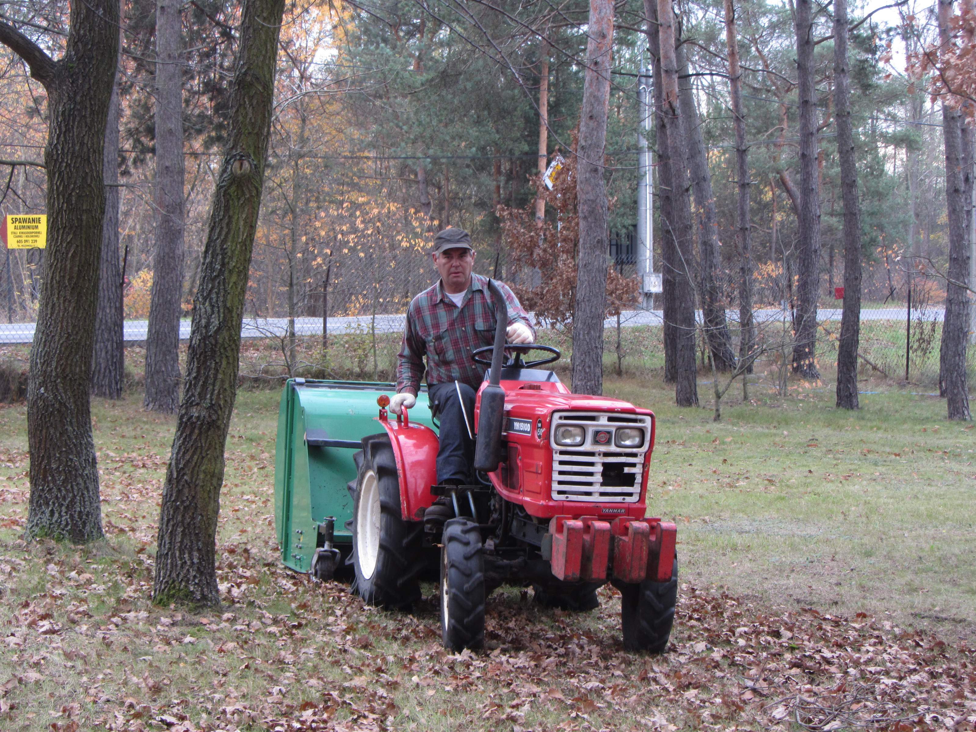

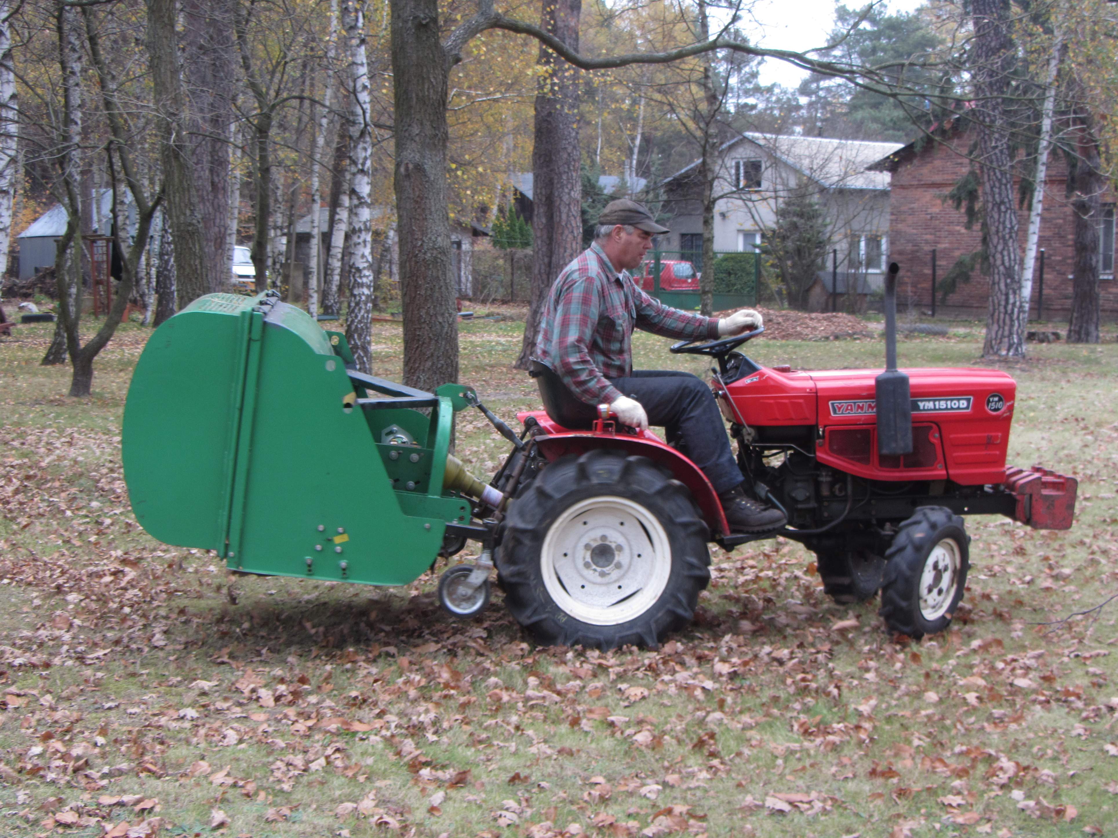

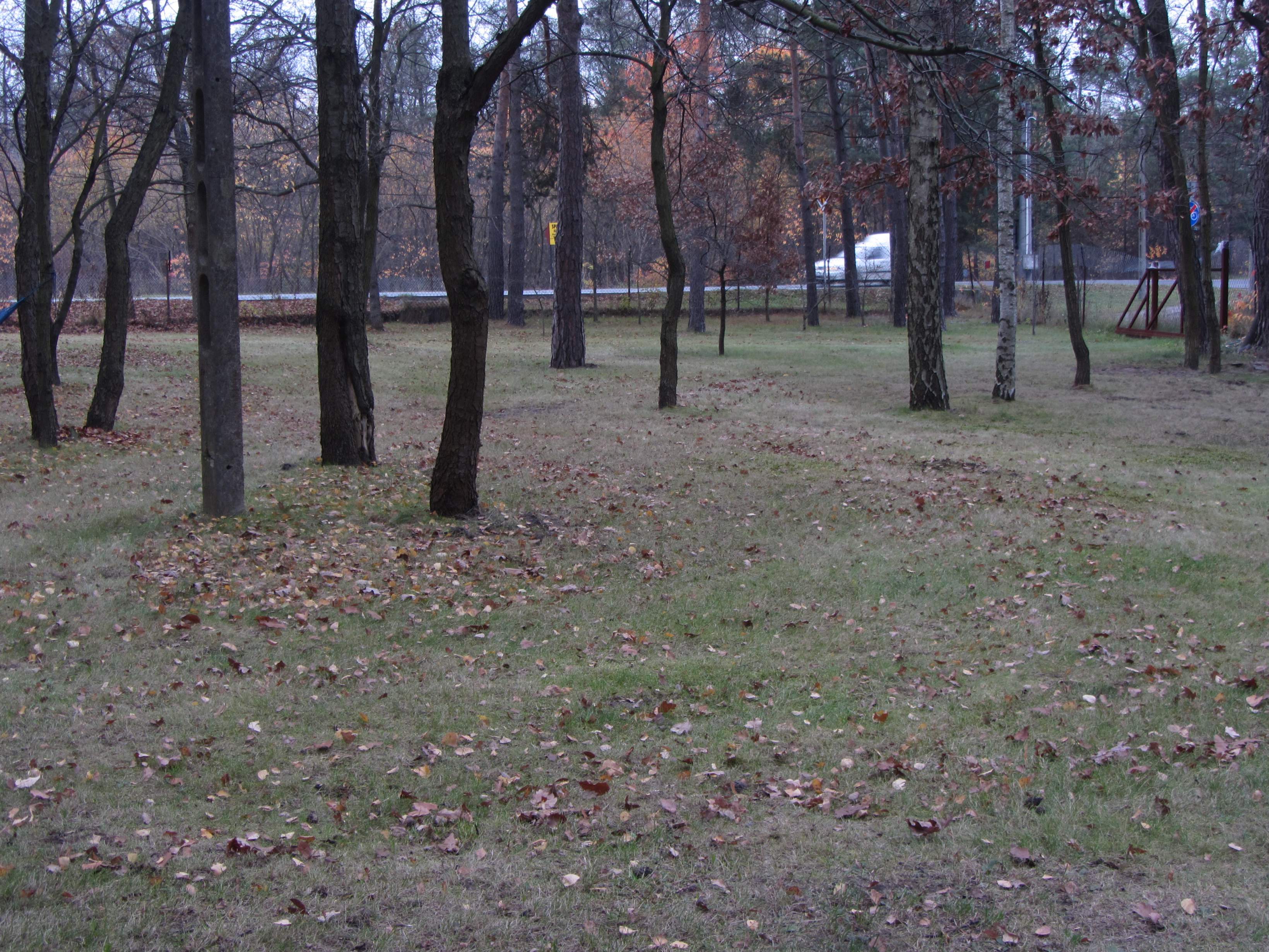

I did not have a mower for my tractor, but as long as I have a son at home that was not be a big problem. :laughing: However, gathering up the leaves in the fall is a real problem for me. We have a lot of trees; birches, maples, oaks, and others, so raking leaves in the fall has been a task that my kids and I have done for a number of years. The problem is that my kids have grown up and gone off to college, until now only one son remains. I bought a hand blower and that helped, but there were still those huge piles of leaves to loaded into the trailer.
I have been looking at these flail mowers that have a built in hopper, but they are a bit pricey for me. I finally found one that was used and that very little. It is 120 cm (4 feet) wide and uses the shovel blade type of cutter. It is made in Italy and the gear box has a built in overdrive clutch (did not know that before I bought it). I was able to get it for less than one half the price of a new one. I figured that it would collect my leaves for me.
The pictures show my process of blowing the leaves away from the trees and fence line, and then I am able to collect it and dump it into one big pile that I will add to the garden soil. It works and as well as I had hoped. It is pretty heavy for my Yanmar 1510D at 380 kg, but by taking the quick hitch off, which brought the mower about 3.5 inches forward I was able to use it. When the hopper is full it is a bit light on the front, but I can steer with brakes. I am making something to add a bit of weight on the front, but for now, IT WORKS! :cool2:
I do need to add hydraulics so that I can dump the hopper without effort. On my to do list for the winter.

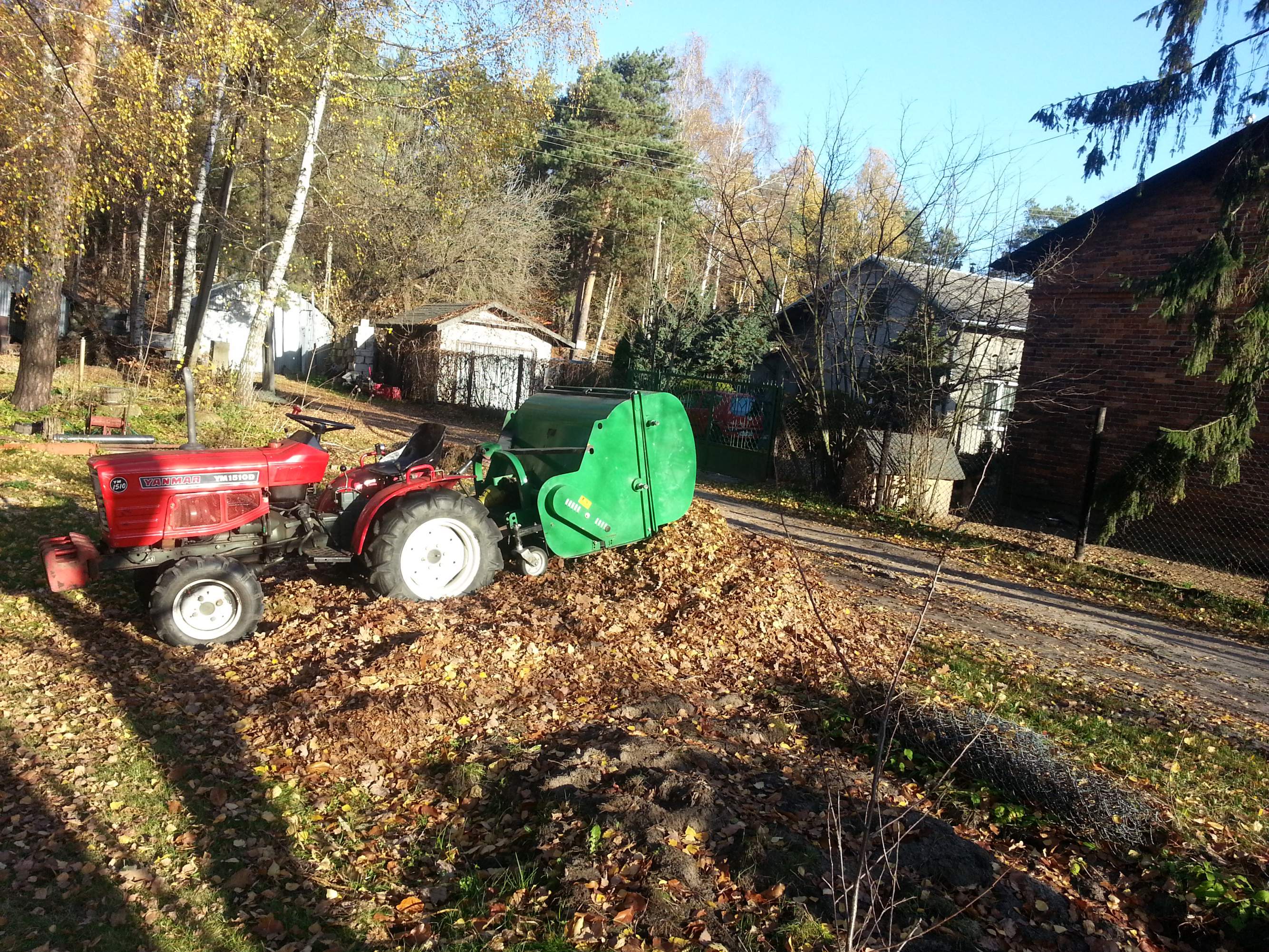

I wanted to show my pile of leaves that I have gathered. I am not finished, but it is getting close to being done for the season.
Thomas, thank you for the very kind remarks. :ashamed: I have a couple of things that I have made that I need to start a thread on when I get some time.

Thank you very much. I really like the mower overall. There are things that I do not think were done well. ie. brackets for the front support wheels are really sloppy. It is a few things like that which make me think that it is not a peruzzo. What is written on the machine is "Geo FL120" It could be a cheaper knock off or competition for the peruzzo. I do not know. I do not think that parts will be a problem, the flails you can buy on an auction site like Ebay, and the rest is just generic like bearings and seals. The structural parts I can repair of make new pieces, so I am looking at a mower for the long haul. I would like to make the height adjust easy to change. It is not now, having to take out bolts to reposition the roller. I will study how others do this and copy--that is what I do best. :D Why reinvent the wheel huh?
I considered some sort of cable winch, but in my thinking, to get enough leverage to lift the dump effectively I would have to add some sort of additional bracketry and I do not want to add one ounce to the thing. Besides Hyd add a "cool" factor. I have a need for hydraulics in other places too so it is just one more place that will benefit.
