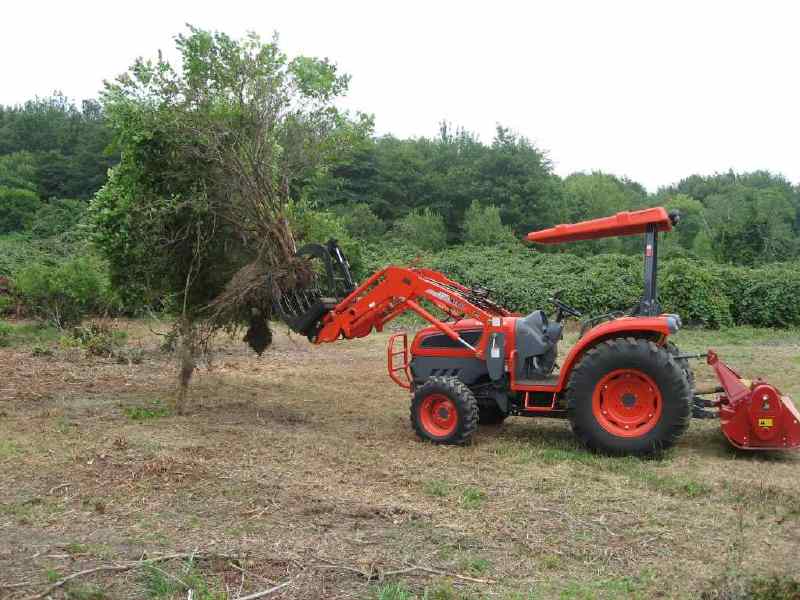

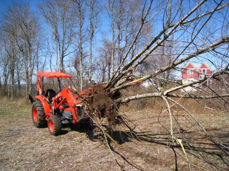

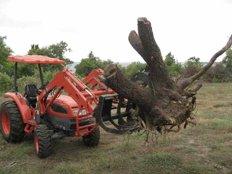

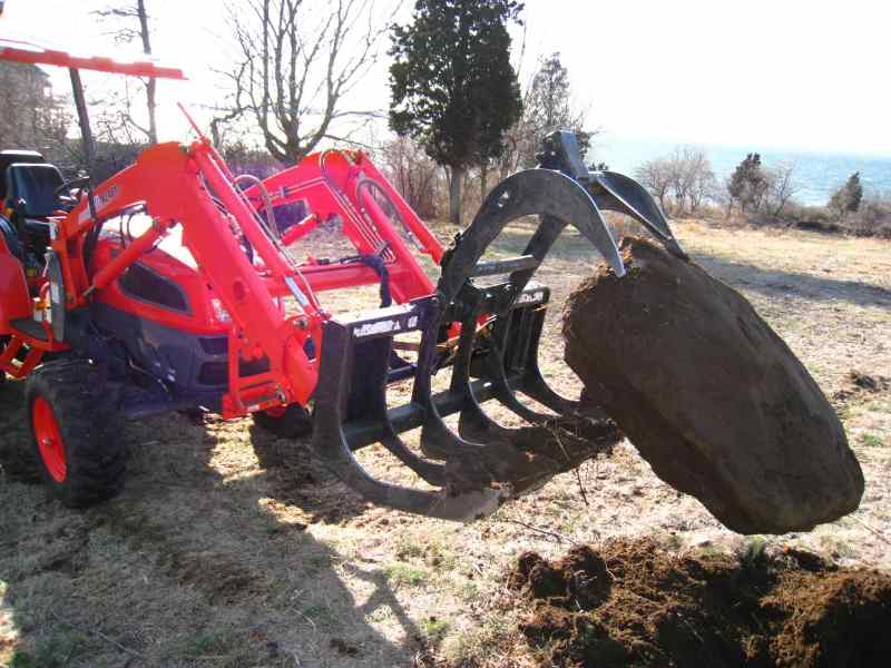

I have a 48 inch light duty grapple. Works great on my DK40se.

I agree with what you are saying. I was really going by price. The smallest one I saw that had the quick attachement was listed as $900. The 48 inch they listed was for a dingo, toro etc, the price was $599 though. Even better in the price dept if it would only fit.
BTW thanks for posting the pics. This will be its primary purpose...
