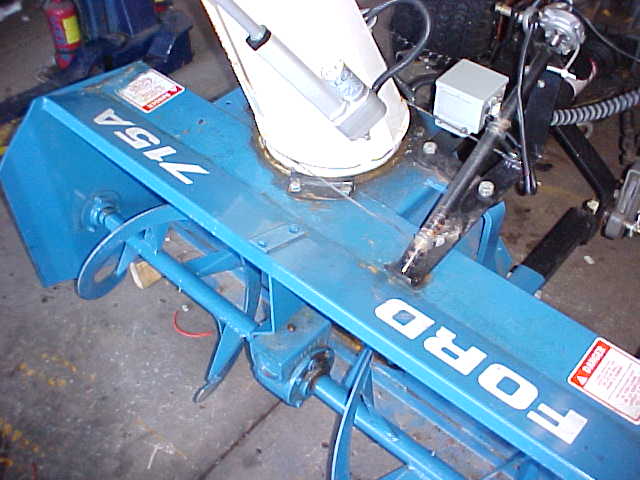

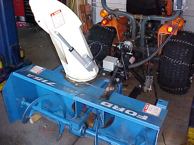

heres a pic of my ford blower,parts are available but not from ford my ford dealer buys them from a company that buys up all the new old stock and outdated parts from ford,the reason the blower throws short on the 3pt is that these were made for front and rear mount,so the dealer tells me, mine throws ten ft or more you have to make sure your running at the correct rpms,i have a fairly good parts manual if you need numbers,i added a power window motor and a linear actuator to control the chute,got everything from surplus center,works great,got the blower off ebay 2 years ago in the crate new for 550.00

the model number on my blower is 19bv102 715 was the series,

Mine is a 19 BV9127, looks identical. I tried calling a number of dealers as well as tractor salvage yards, without sucess. I was able to download the "exploded" views of the blower from the ford website so I've got the part numbers, just lacking a connection that can find the parts. IF your dealer has a connection thats great, would you mind sharing their contact info?
I also really like your automatic shoot controls, I'm thinking of doing something similar over the summer, at least to rotate the shoot. I thought about electric but wasn't sure how it would work. After seeing your setup I think I'll look into it a little more, thanks. I wouldn't have thought getting off the tractor and doing it manually would be such a problem but it I find you have to rotate the shoot a lot more then I ever had to turn the blade when plowing snow.
