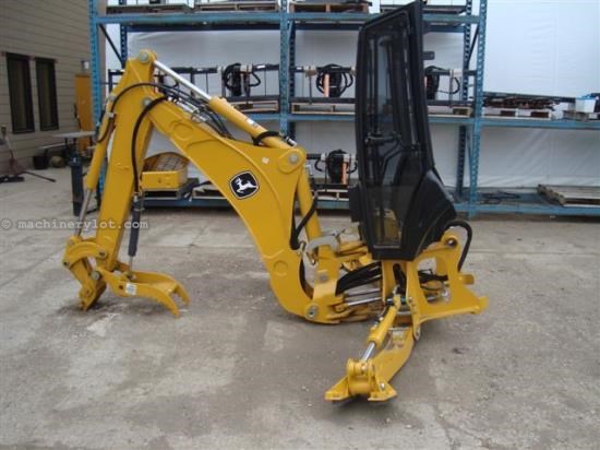

I was just looking at a couple pictures online of the 110 cabbed ... It looks like there might be issues with detaching the backhoe and using the 3pt.. Looks awful tight back there, and in a couple pics it looked like the cab was bolted to the backhoe frame
Yes it looks like the cab is bolted to the backhoe frame attachment
