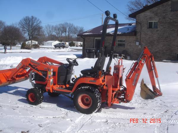

Newbie here currently in the market for a TLB found a 2005 bx23 with 940 hrs comes with mower deck, asking $12500 just trying to get a ballpark of pricing i feel this is a bit high. any input greatly appreciated

A tractor with that few hours are barely broke in. If the trans/hydraulic filter is gray that indicates it did not get its 50hr service. Look at the fluids and see if clean or darkening. Any signs of abuse like bent FEL arms or boom on backhoe.
Leaks would be uncommon with that few hours. If clean might not hurt to ask the bottom price he/she will take.
I bought my 03 BX2200 used with 1187hrs on it with FEL, 60" MMM, rear blade and 60" tiller for $7,300.
Used machines especially Kubota's are getting top prices now.

Several comments
The plastic Hydro Fan underneath is susceptible to damage and always verify it is in place and not missing blades.
Air Filter Bracket is notorious for cracking... not a big deal... just something to be aware.
Under belly is somewhat exposed and most of us have added skid plates... especially if going into the woods.
The BX23 is really an amazingly rugged and capable TLB... done a lot of work with mine and have 320 hours.
New I paid $14,900 out the door without mower...
The price does seem to be higher than I would expect...

thanks for the replies, im going taking a 3 hr drive tomorrow to take a look at it. ill keep an eye out for fluids and scope out the underbelly of the unit. one thing im kind of confused on is why the rear tires appear to be turf tires and the fronts are industrial, minor but just a question. Hopefully everything checks out ok and i can talk him down a bit and have my first tractor.:)

During the last eleven years was the tractor stored inside or outside? $2,000/$3,000 difference in what you should pay.
Eleven years outside will have deteriorated wiring insulation, hydraulic lines, tires, instruments and paint.
Industry surveys indicate small residential tractors operate 80 hours per year.
Tractor prices are most negotiable when there is snow on the ground.

Turf and Industrial might be possible to match the rolling circumference of the factory tires but you should research the original size and circumference of both to make sure they are a perfect match otherwise the transmission could have sustained damage from the use of two different sized tires.
I suspect that the R4 were put on to handle a heavier load on the front but If the sizes don't match the original R4 or Turf exactly (within 5% is allowable) then I would shy away from that tractor. I think the price is very high for a 11 year old tractor. I think he is asking original purchase price of the tractor.

The original BX23 front tires were discontinued from Kubota...
I had to go with BX24 tires and rims... the 24 uses a bigger rim and a lower profile tire so the circumference is the same...
I actually ended up buying a set of BX24 front and rears on new rims through whole goods for less then I could buy just the tires...
If I had to choose... the BX23 would be the last to go... I just like it that much... the BX24 had plastic floor and fenders that did not work out so well... the BX25D seems to have all the bugs worked out...

Well... there are few more quirks...
Don't get your instrument panel/light switches wet... they are not water proof and members have reported the flashers or other lights on after hosing down that area... I never get the hose anywhere near it and the few times it had to be outside overnight, I put a cover over that area.
Another is the fuel gauge may be hit or miss... some have reported rust from the sending unit plugging filters.
The transmission selector on the right can get packed with mud so much so you won't be able to move it OR the sensor is impeded.
The treadle pedal has to be in the middle or neutral position for safety interlock to let the starter work...
My brother used my tractor and though something bad had happened... it was just the interlock was not in the right position.
The two things I added are a tooth bar for digging with the FEL and the skid plates...

I do not believe there is any discontinued tractor tire size which cannot be found on eBay.
Really rare sizes may not be cheap but almost every size is available.
The BX23 Front is rather unique.
18x8.50-8
The later models use 18x8.50-10
When I trashed one of my fronts I was able to buy a complete set of BX24 Tires and Rims... front and back for $296 and I did...
Dealer said the new size holds up better for loader work and so far it has.
