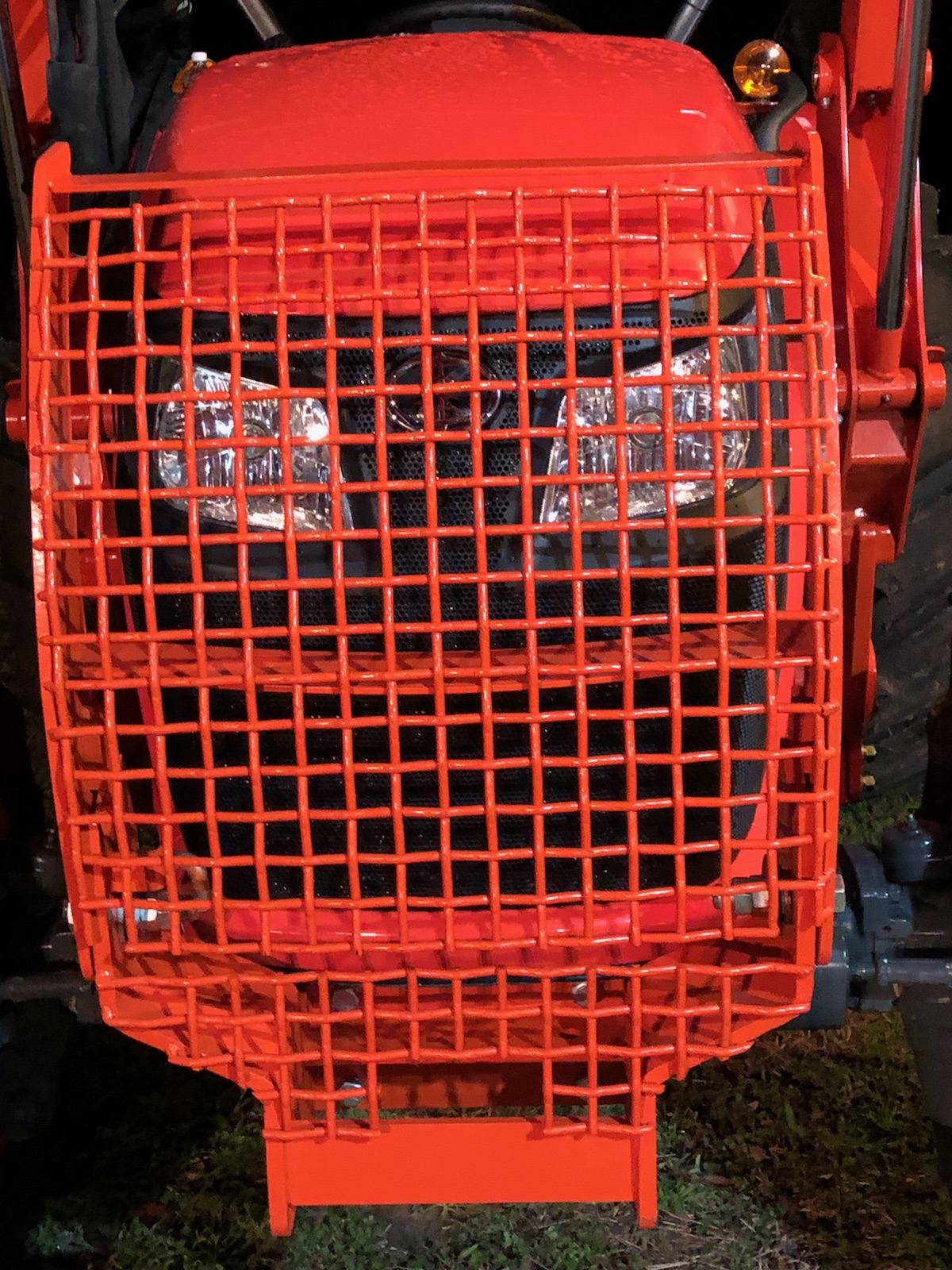

To keep this from happening again, I would have backed into that brush. Most likely also not the best way of doing it... but I've back into some pretty bad crap where I had to duck and cover... :2cents: I raise the bush hog and drop it on top of the brush.
Now that I have a hydraulic top link, I shorten the top link so the mower is tilted pretty sharp and just back into brush.

It would not have helped my issue last weekend, but it could help prevent future radiator/oil cooler issues.... this is my next modification.

A nice clean break like that would sure tempt me to try to repair the old one and keep it as a spare. Are there specialty companies that do repairs on fiber-reinforced plastic like this? Like maybe the "soft" auto bumper repair shops?
